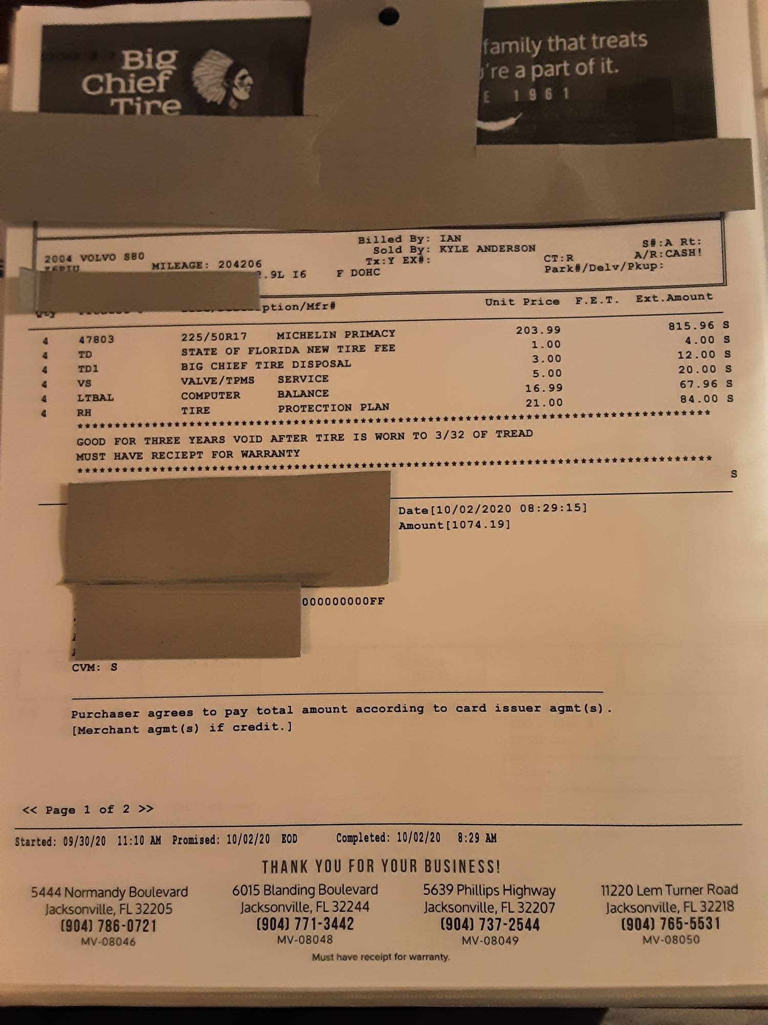

10/02/2020
204,206 miles
$1074.19
New tires
204,206 miles
$1074.19
New tires

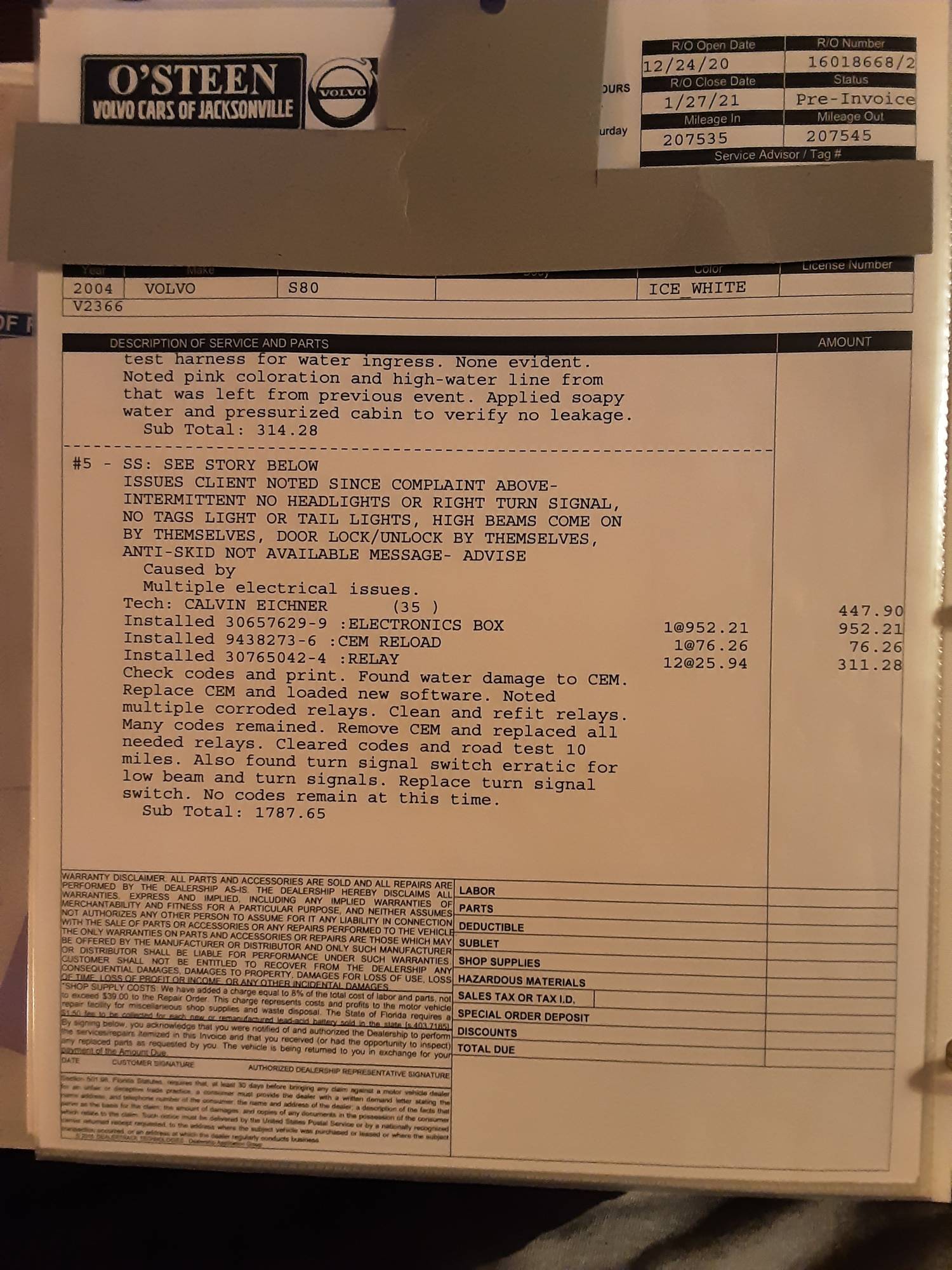

01/27/2021
207,545
$2439.23
207,545
$2439.23

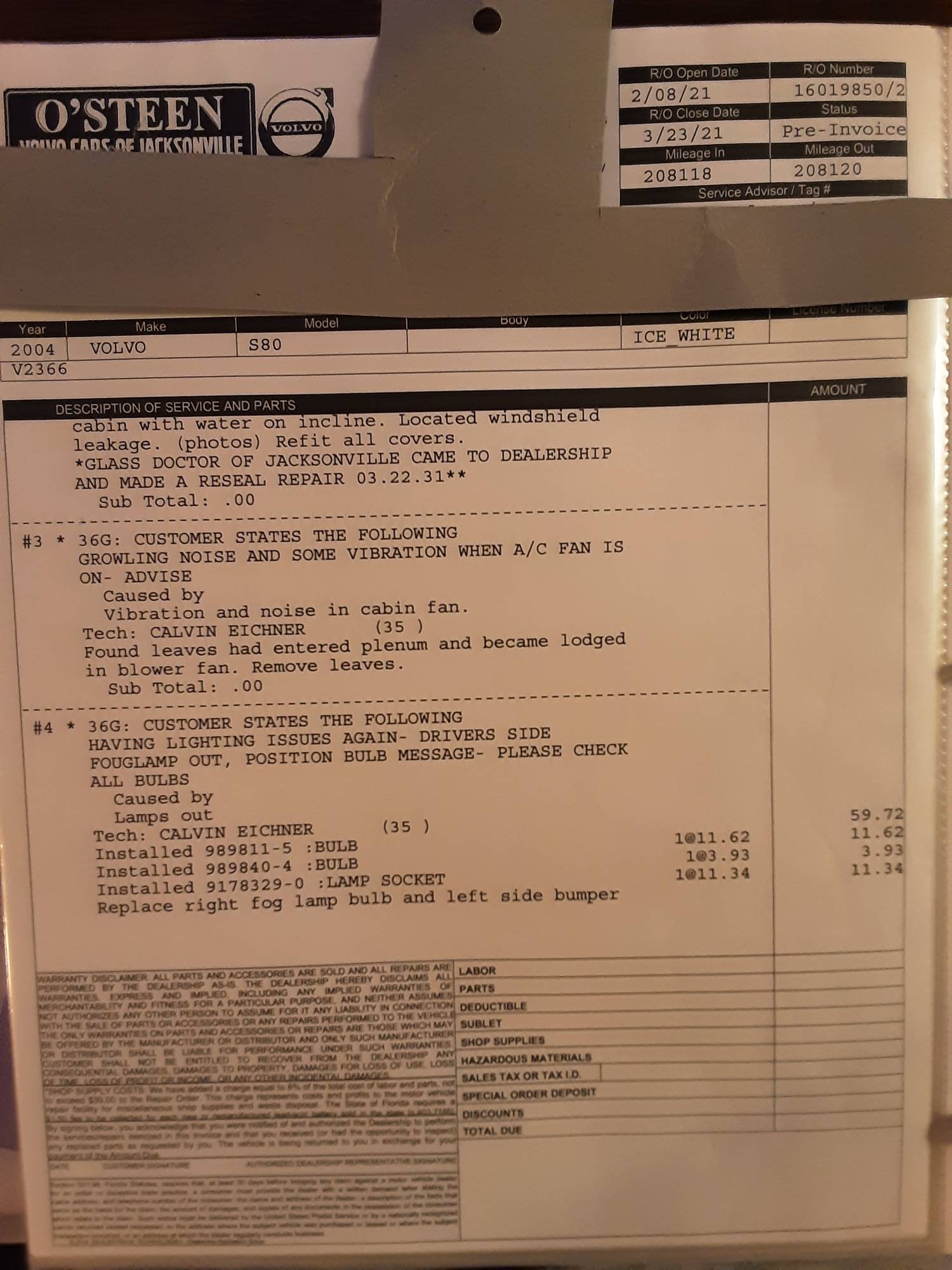

03/23/2021
208,120
$161.31
208,120
$161.31

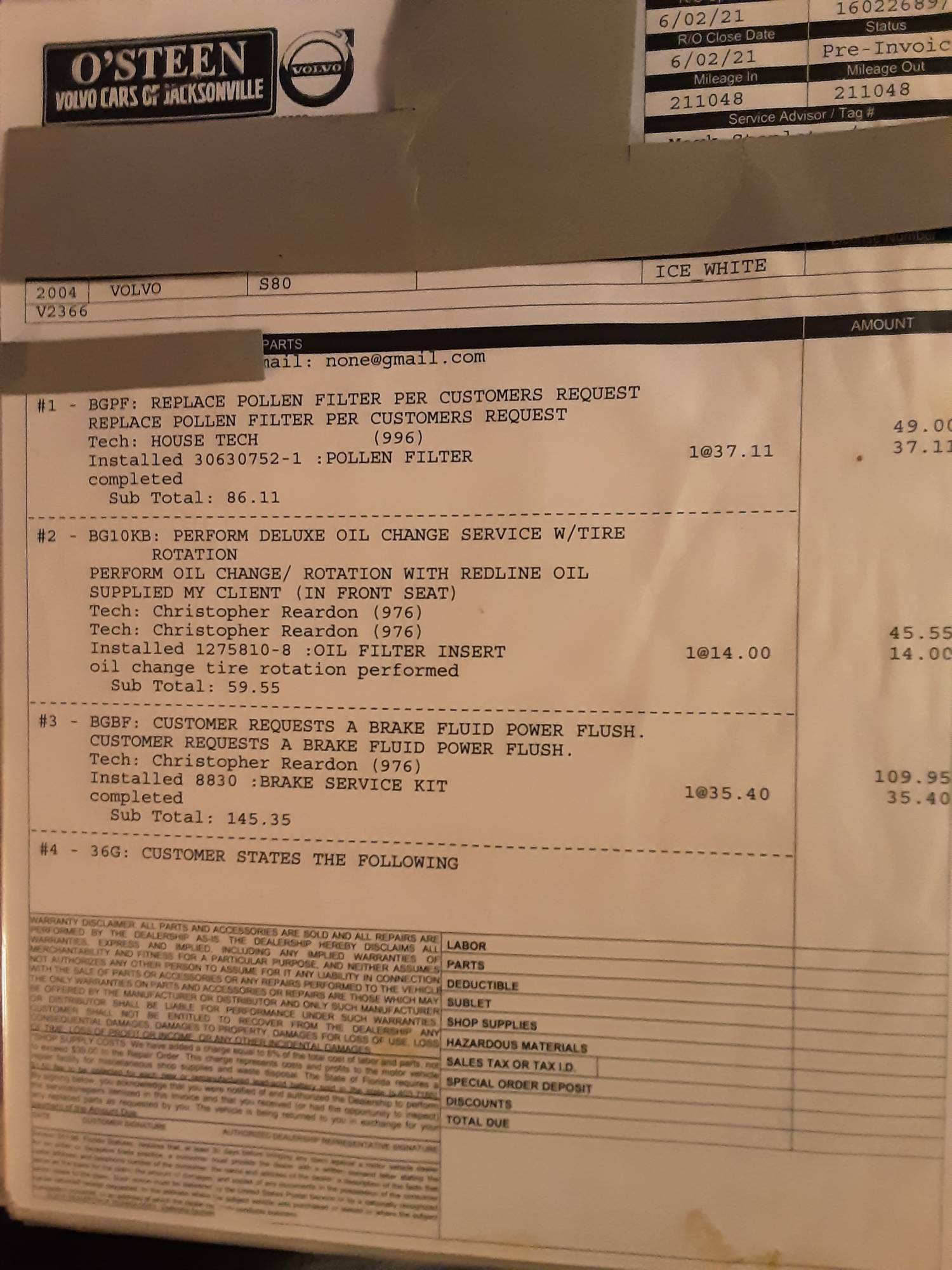

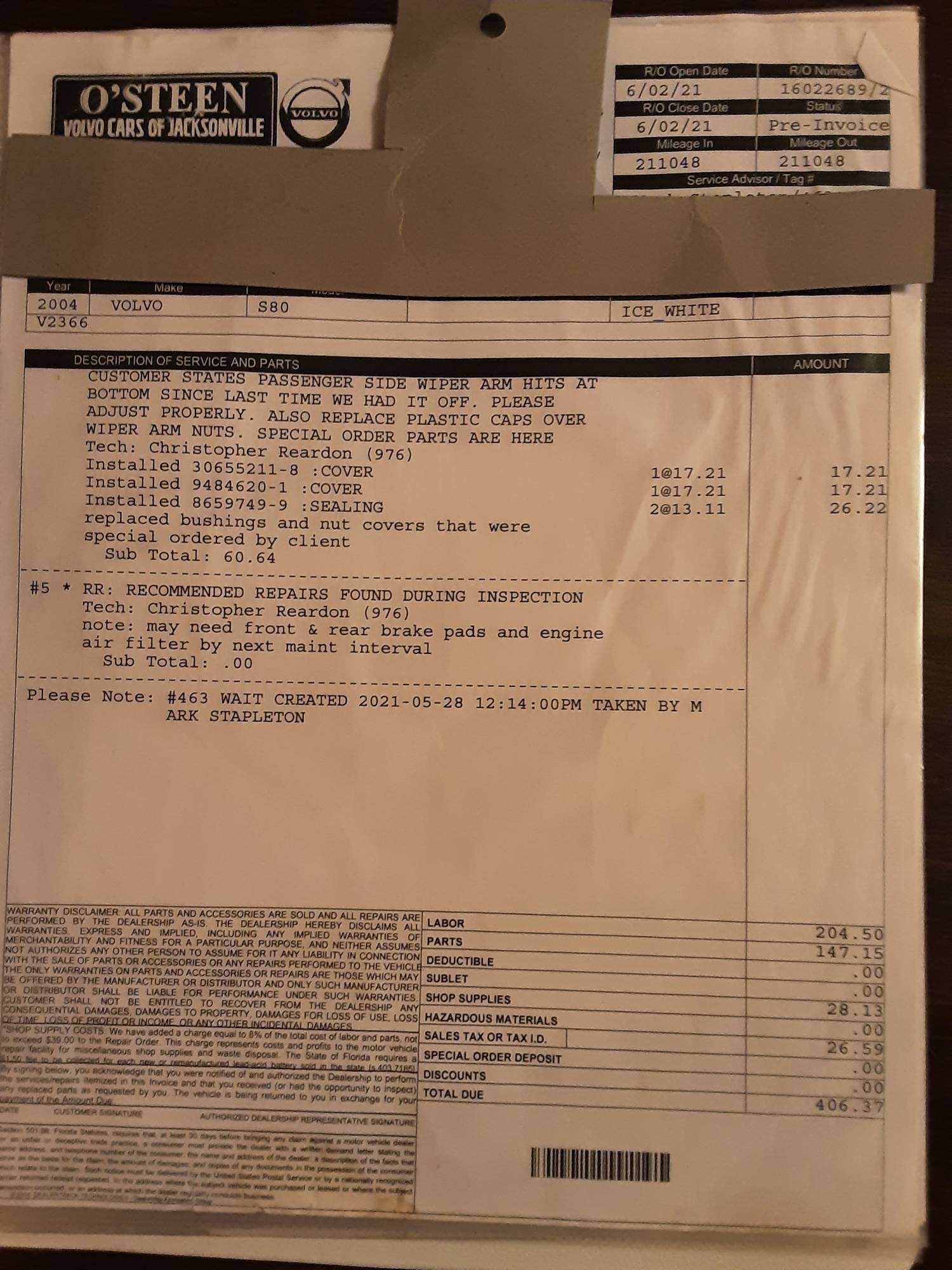

06/02/2021
211,048
$406.37
211,048
$406.37

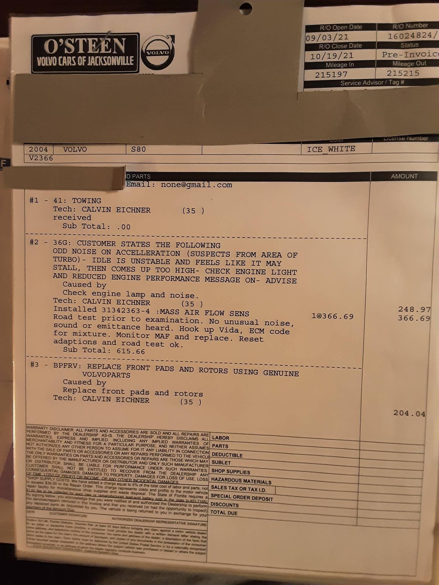

10/19/2021
215,215
$3,472.42
215,215
$3,472.42
