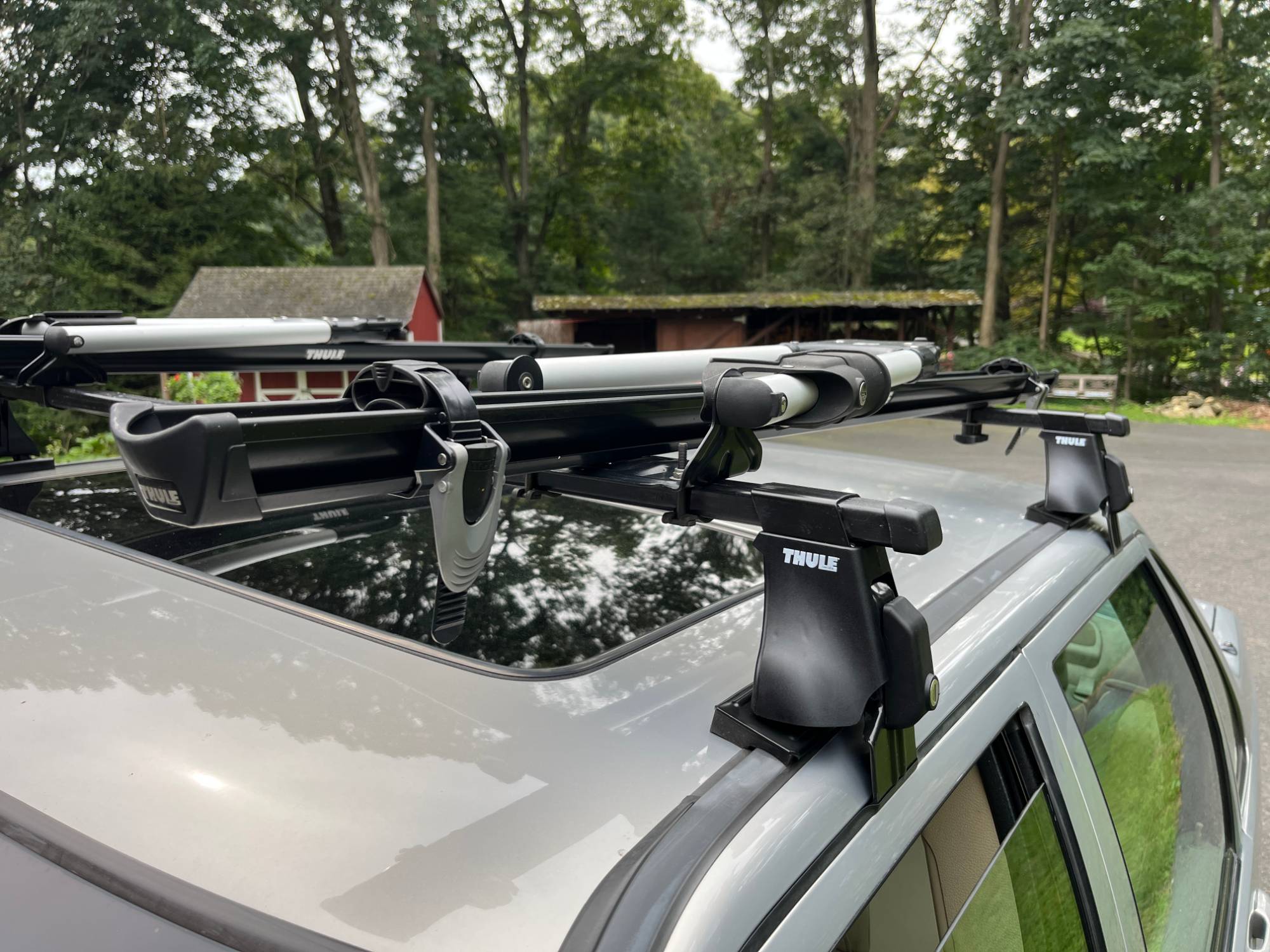

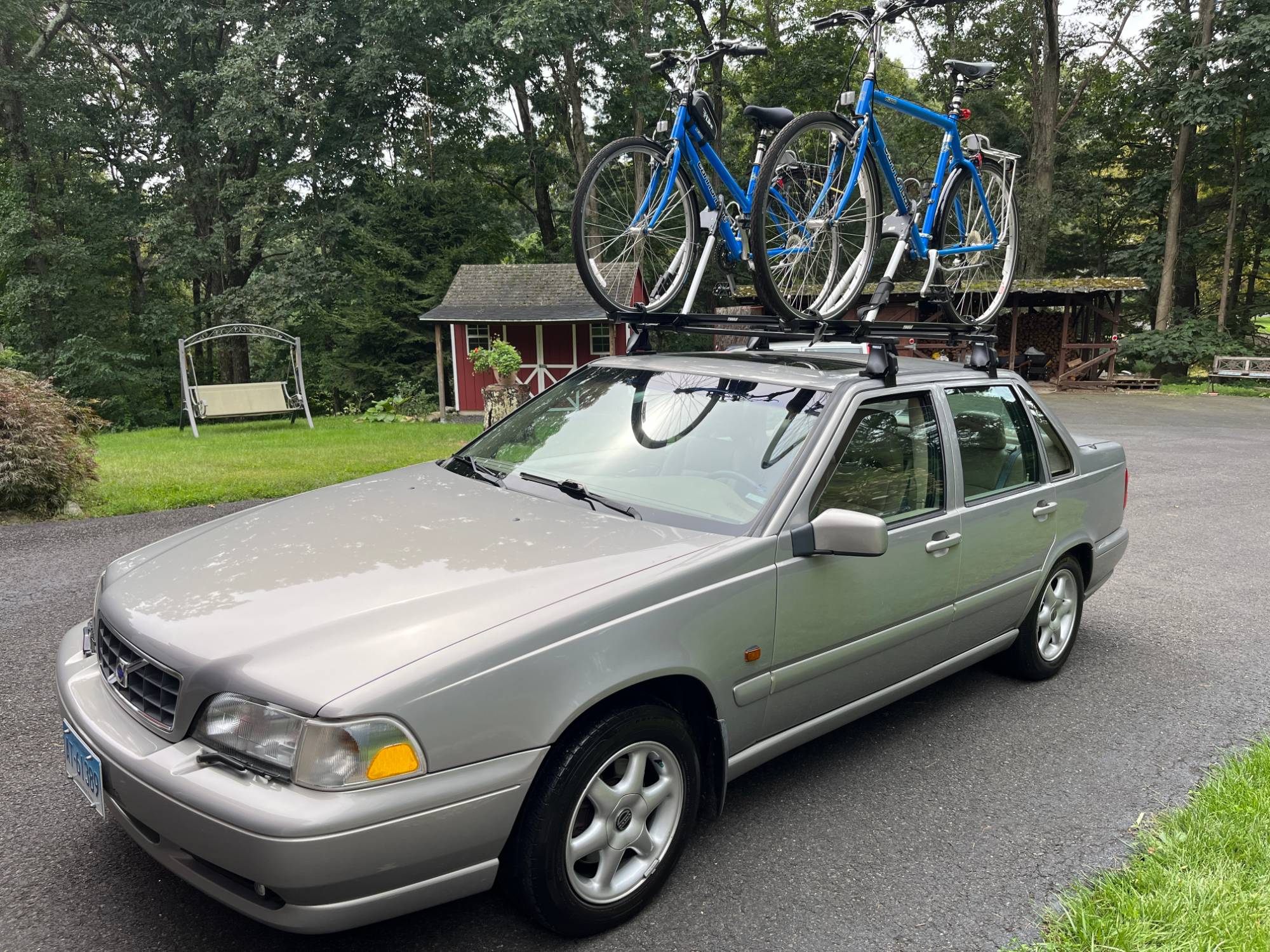

Yesterday I was finally able to install the Thule roof rack system on Ingrid, the new 98' S70 5-speed. Thanks again Neil and Chuck for helping me to find the parts for the mounting feet and the fit kit. It was a difficult installation because the bars would not go into the brackets without shaving material off the plastic coating. I am not sure why this is, but maybe because I was using old used bars had something to do with it. I cannot imagine Thule would sell something that doesn't fit together. I am reusing the bike carriers which I had on multiple cars now.
