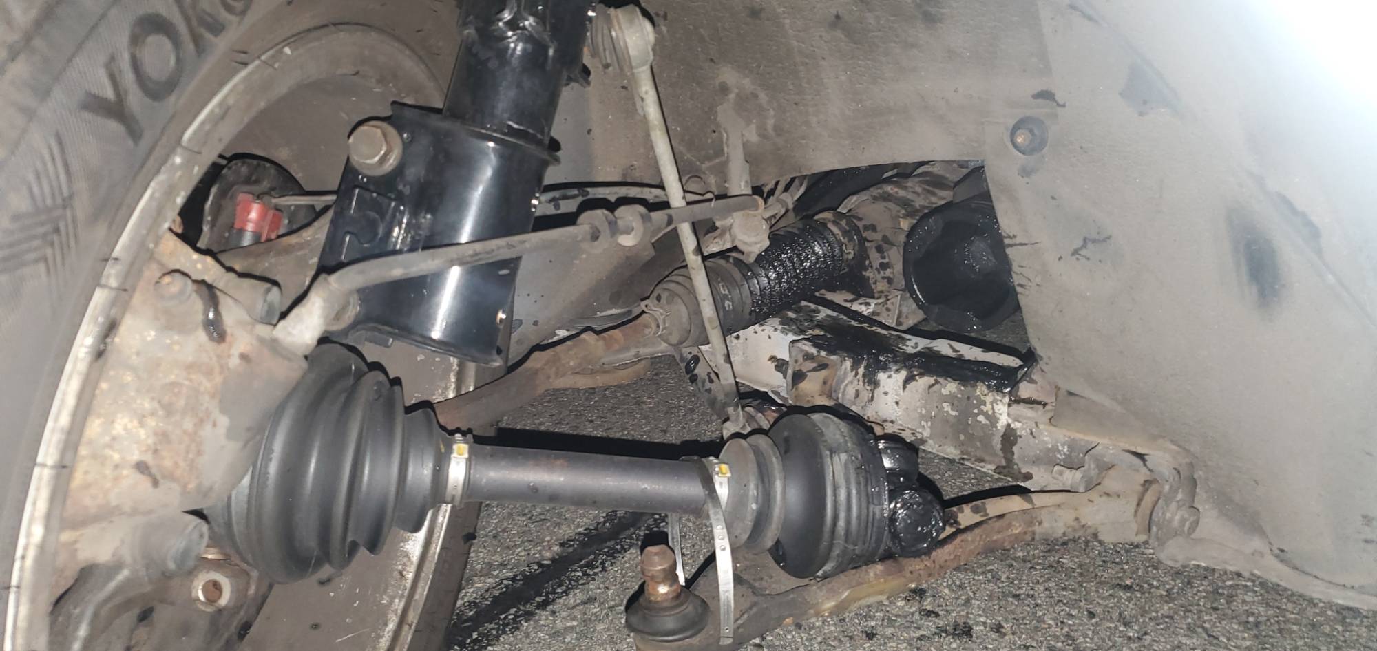

Broke the ball joint pinch bolt driving on our glorious New York roads. Recently did an axle swap and took the whole knuckle out to press the old axle out, but the car has been driven on a 600 mile round trip since then, and it chose to break down 20 minutes from home. What a good car.

Did you re-use the pinch bolt or was it a new one that broke? If a used one, you now know why you should always use a new one.

Always a new nut on the ball joint pinch bolt, as well as the two strut bolts/ nuts, is what Volvo calls for.
The ball joint nut is a ovalled head which self locks , so that’s really critical. I used Lowes hardware there. Once. I was darn lucky I caught it coming loose with an inspection protocol.
Order 4 of the 987891 nuts, so you have them in hand next time you are on that ball joint

Yeah I reused the bolt, this was a good wake-up call to stop cheaping out, especially since we're already saving money doing work ourselves. Thankfully it was at pretty low speeds and something just caught the wheel wrong, it seems everything is ok, I have the bolt and nut on order. This is my sister's car, she has was driving at the time and luckily this was just an annoyance rather than something worse.

jsrnsis wrote: ↑18 Oct 2023, 04:19 Yeah I reused the bolt, this was a good wake-up call to stop cheaping out, especially since we're already saving money doing work ourselves. Thankfully it was at pretty low speeds and something just caught the wheel wrong, it seems everything is ok, I have the bolt and nut on order. This is my sister's car, she has was driving at the time and luckily this was just an annoyance rather than something worse.
We’ve all done it, and I appreciate the PSA to remind us not to do it. I’ve moved to a later in life mode where I buy the new hardware and then I’m compelled to install it rather than return it. Ten years from now, when I age out of rolling underneath, I figure my indie will appreciate new hardware. That’s already saved my life once on the Kat
