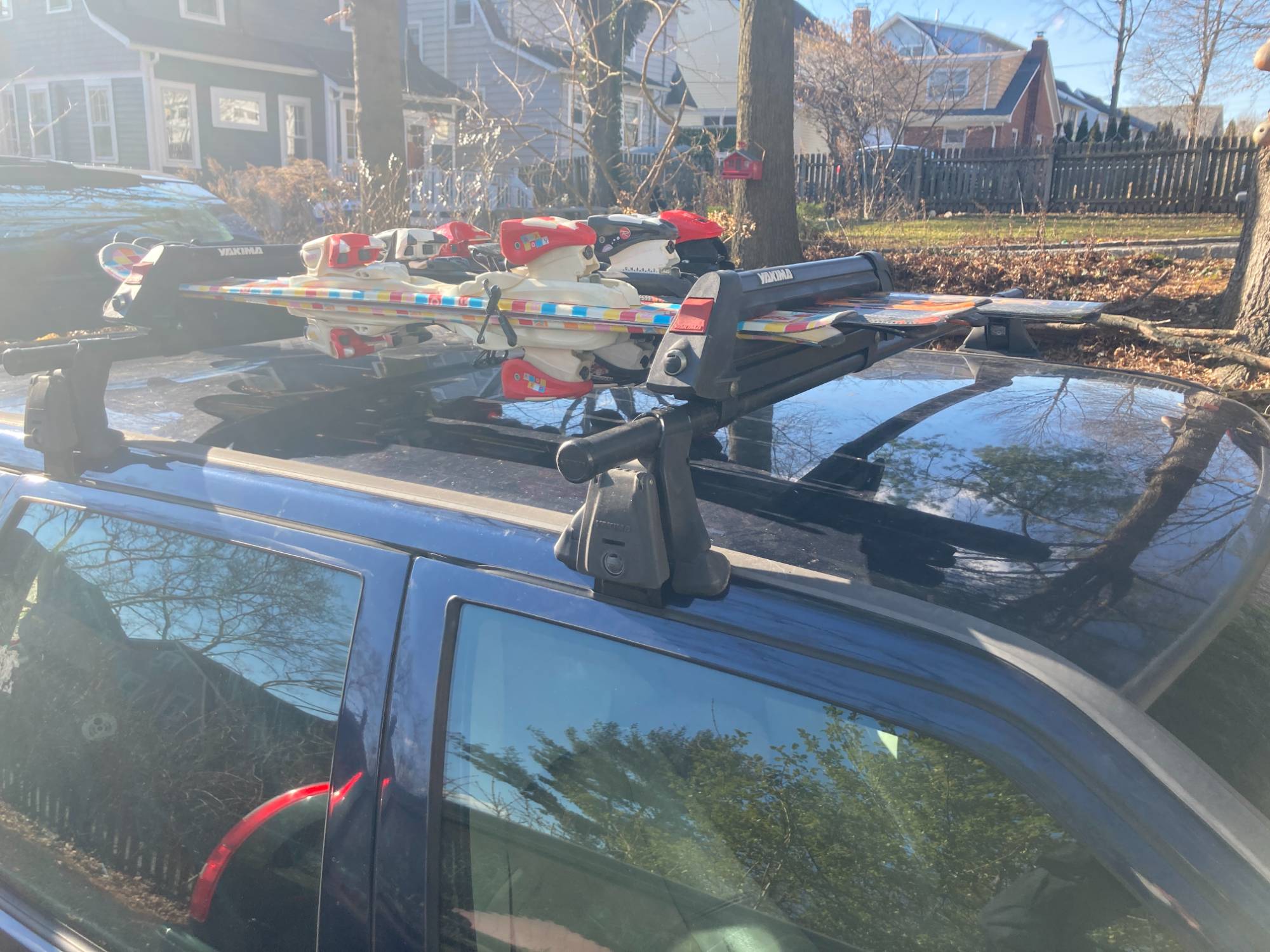

Picked up some vintage Yakima towers and bars so I can attach a ski rack to the roof.

Success! Using vintage Yakima Q Towers and new Q clips (51 for the front; 52 for the rear), I managed to get the roof rack installed.
One of the towers had a stripped 6mm allen bolt, but it tightened a clamp to the crossbar and wasn't removable. So, I tapped the tower against the way it clamps, and it loosened enough to reposition it properly. Whew!
