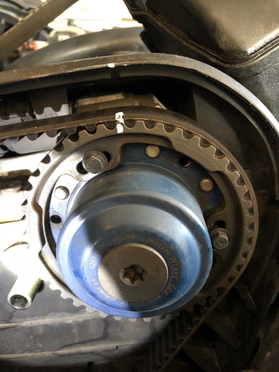

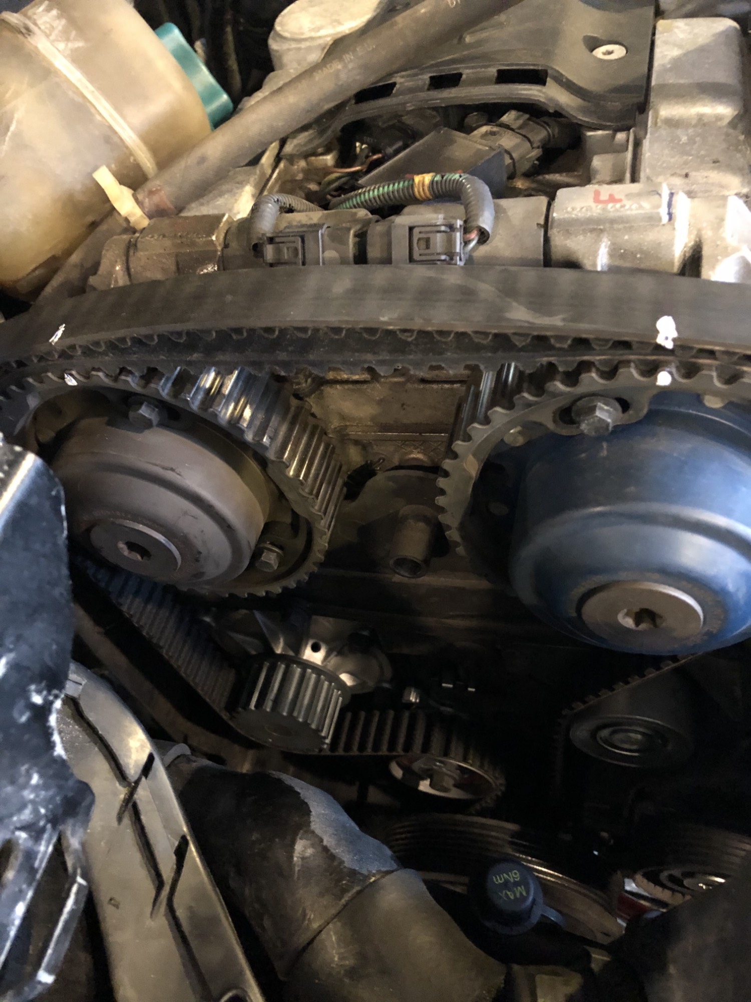

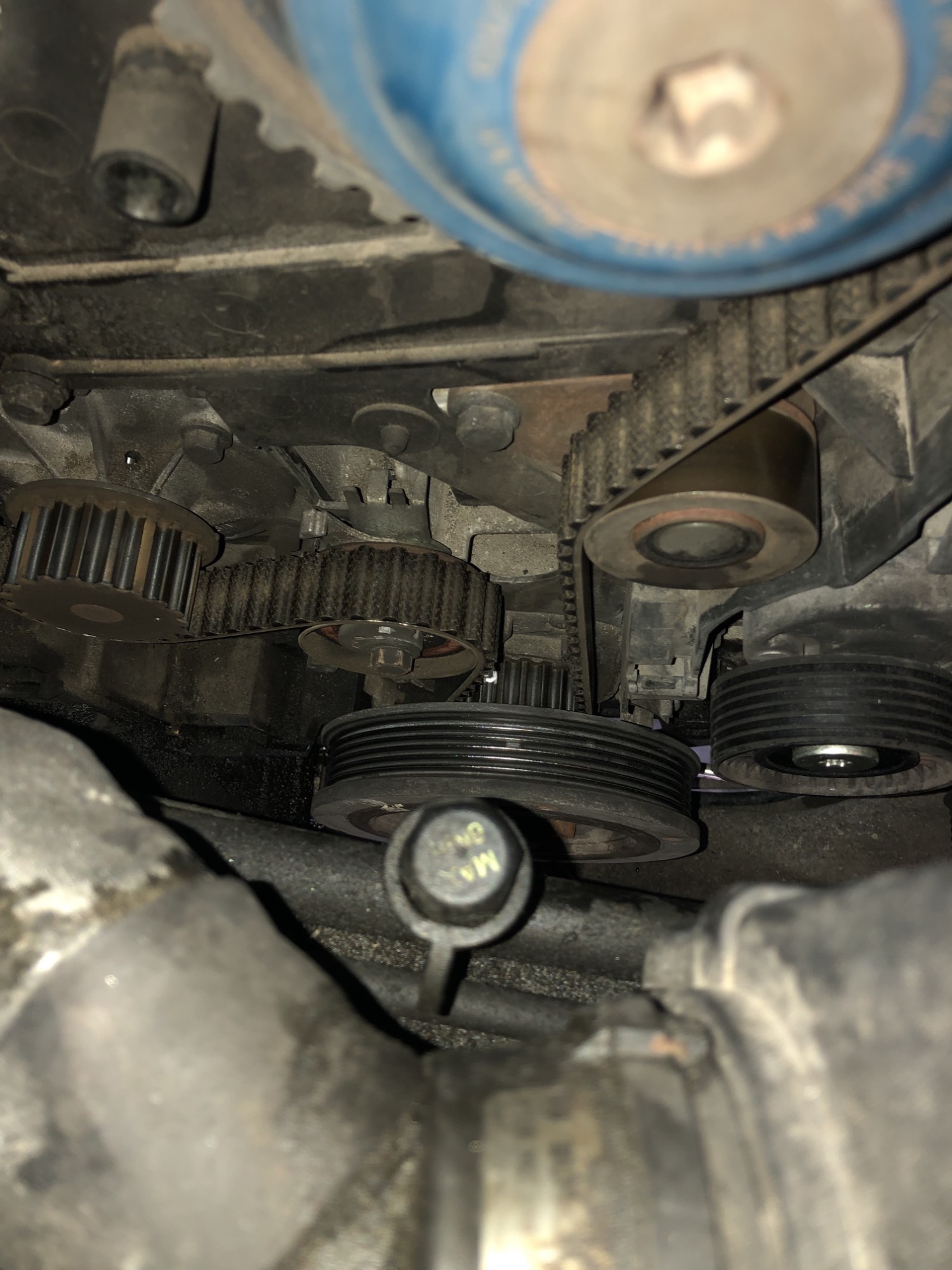

I did mine last year on my '03 XC. Make sure you change the water pump and idler and pulley if you haven't seen any evidence of this having been done on your car before.
Mark your old belt while its still on the pulleys before you take it off with a while paint marker so you can reference the marks on your new belt to ensure you have it timed properly. No need to lock the cams, or remove the crank pulley. See photos below.
