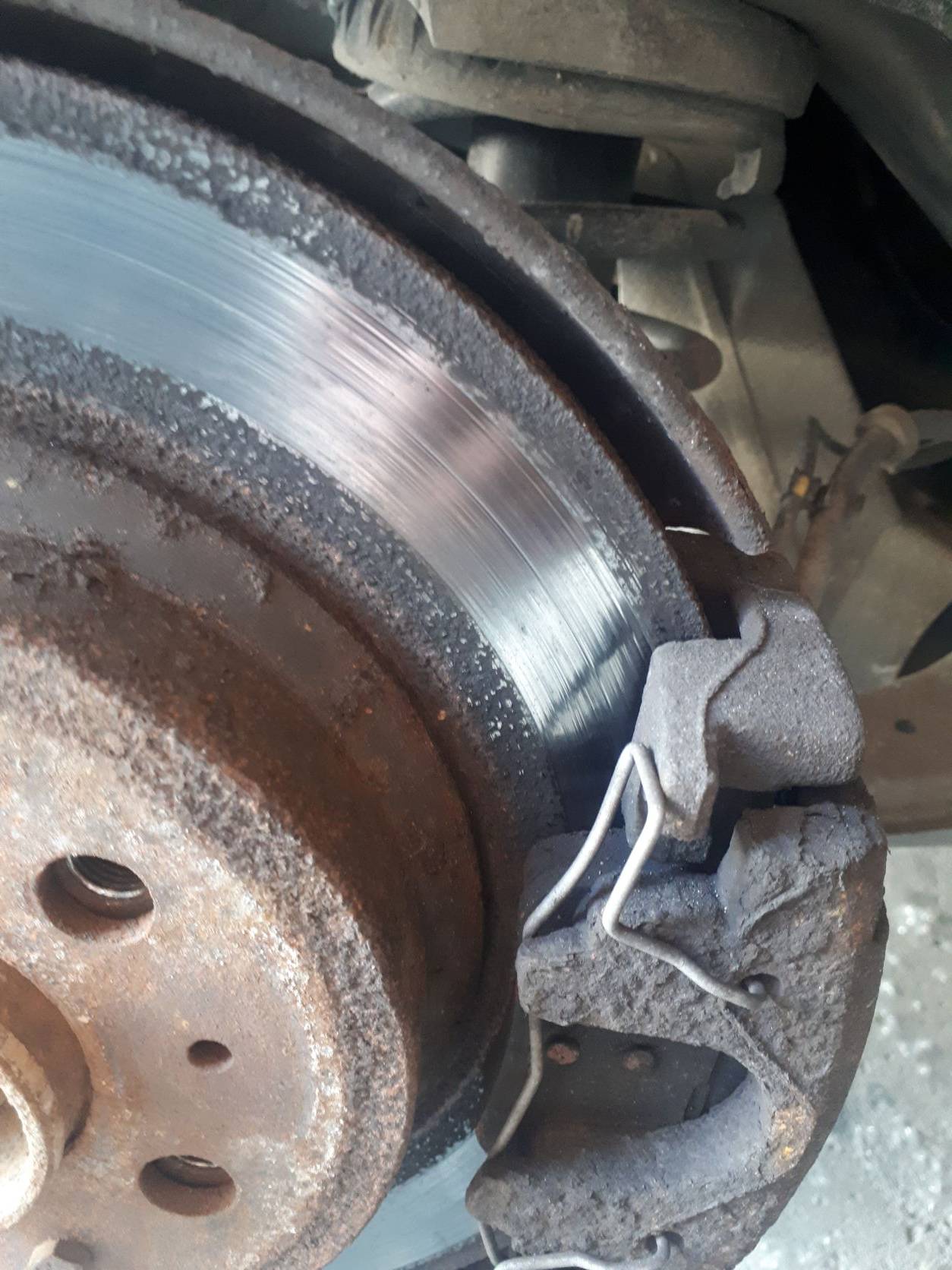

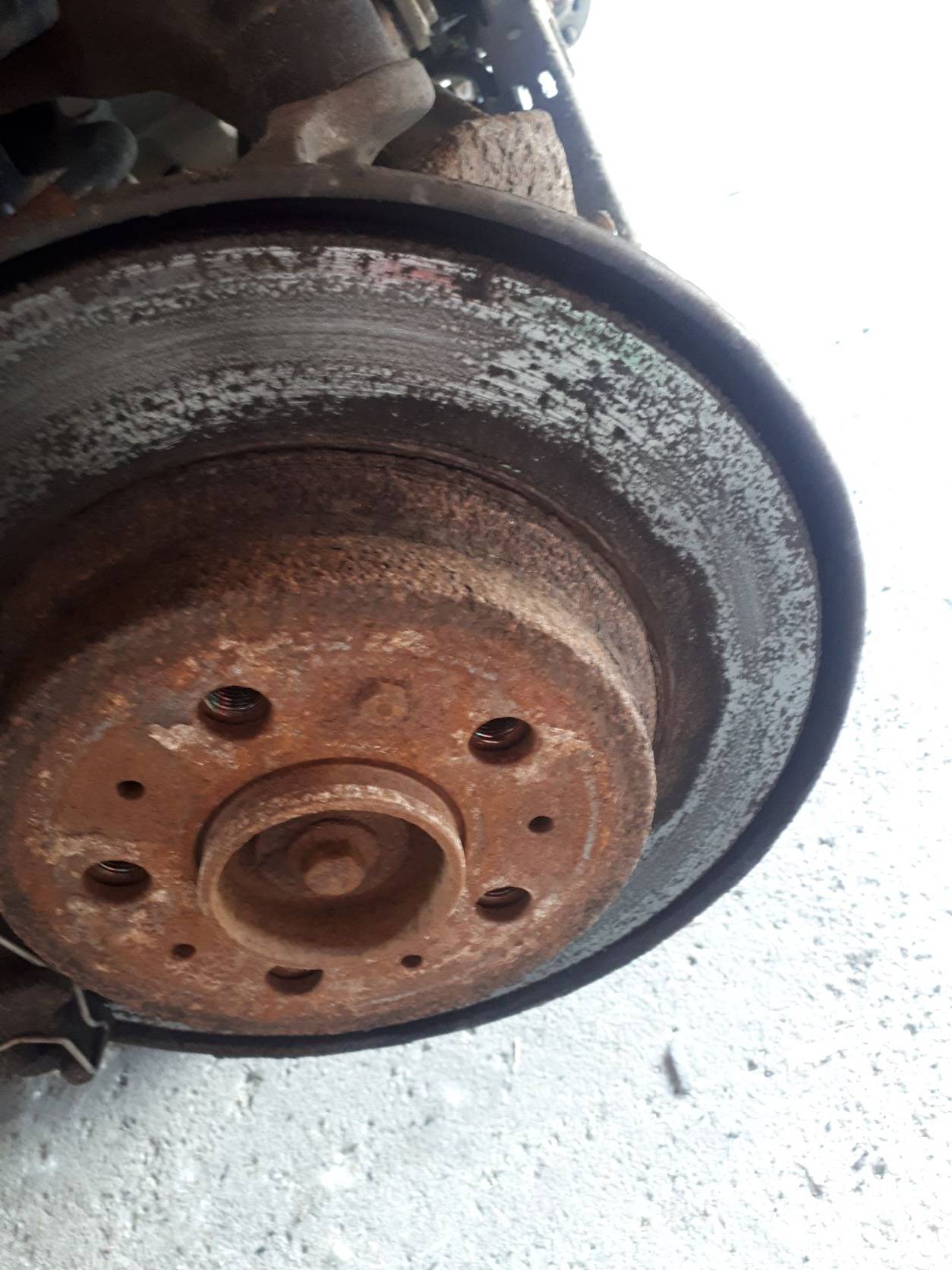

Update:
Lifted rear of car so I could look at both sides easily. Pads are wearing evenly on each wheel and on both sides. Did a complete bleed all round and found no obvious problems. Took it out for a drive later and in an empty parking lot, stomped on the brakes at 40kph/25mph and car stopped quickly without excessive nose diving. So everything seems to be in good working order. Will check again in a few days. Here are images of the rear rotors that concern me.

Man, those are some rusty rotors (even by Ontario standards!)! Very poor pad to rotor contact. Having a similar issue with my 2006, just bought pads and rotors. I have been buying pads and rotors from Max Advanced Brakes in Markham-- less than $100 taxes in and delivered. Make sure you lube up the caliper pins.

Work your caliper piston back and forth. It should go in easy enough with one hand on channel lock pliers. That was my issue with my overheating brakes. This looks very different though. I would probably get the rotors turned at that point and try new pads.
I got my last set of brakes from AutoShack. Mixed reviews but I can't complain for about $150 shipped front and rear pads+rotors.

Time to overhaul parking brake, new shoes, rotors, pads. Check if FCPEURO ships to Canada...
