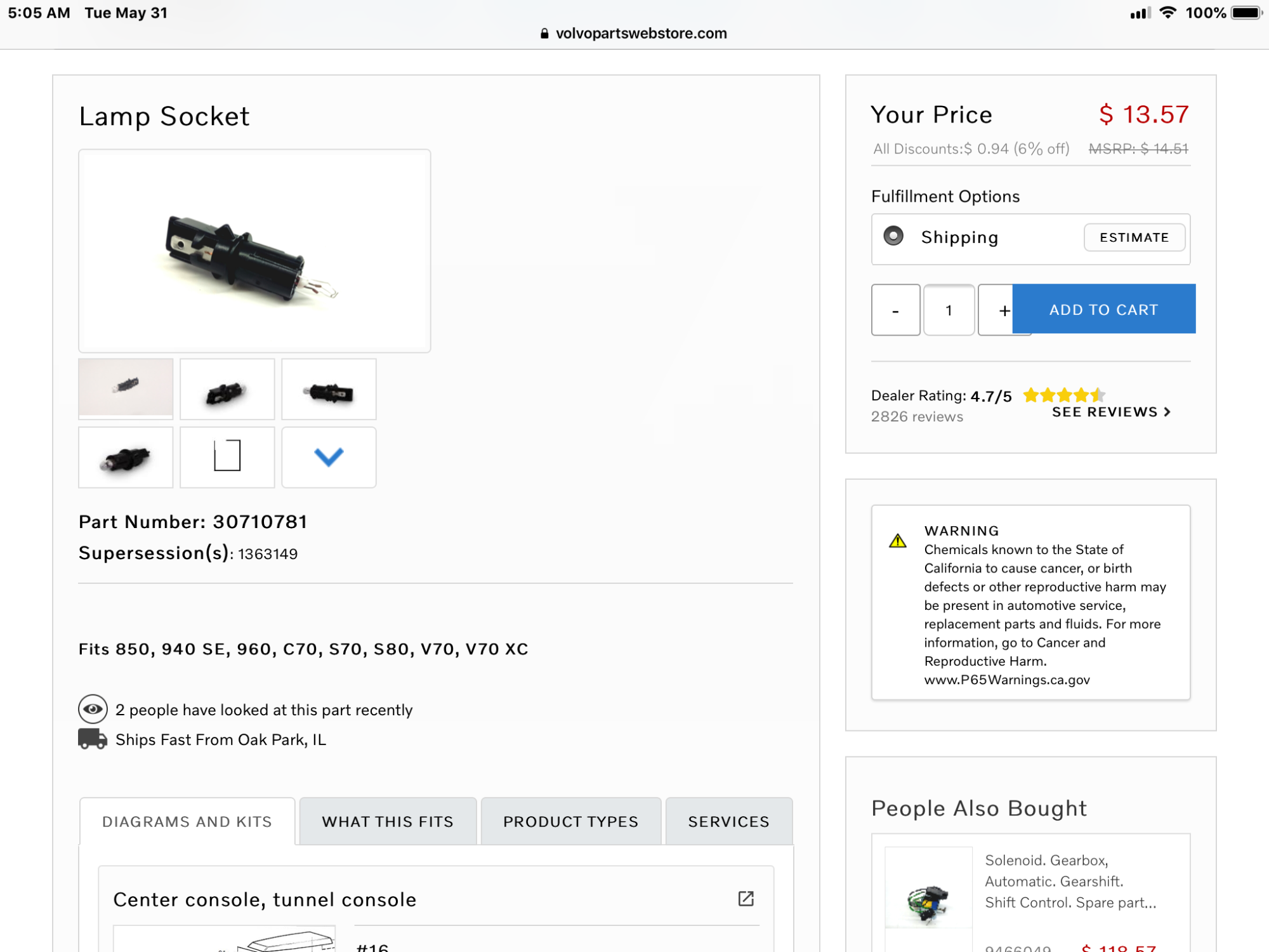

I need to replace the ludicrously expensive shifter illumination bulb # 30710781 (around $13 CDN)

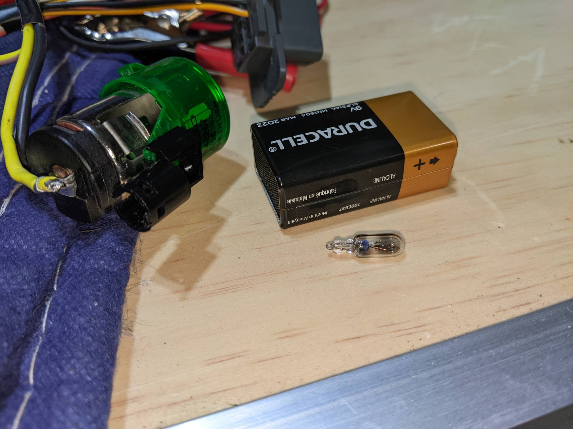

This is the bulb:
This bulb is one of the one's I am looking for.

Looks like Sylvania 2721 or equivalent.

Rick was bang on the money. 2721 looks identical and looking on Vida parts list, it is a 1.2W bulb. I have test fitted 2 bulbs in a spare console harness and they both work now with new bulbs. Both were blown.

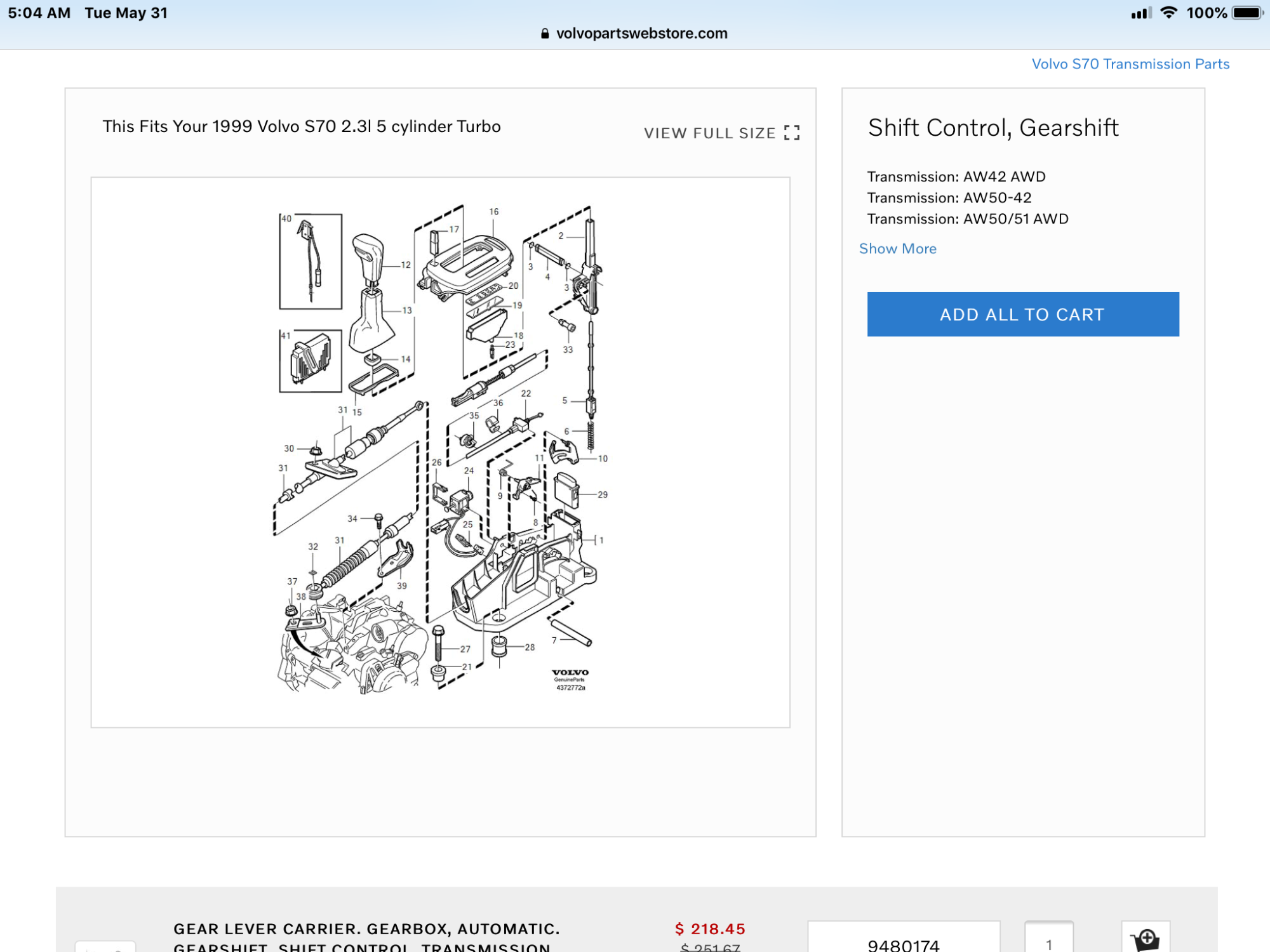

Volvo sells it as complete socket, #23
Also bulb and socket information from owners manual

The gear shift position lamp/bulb that abscate lists is a silly price from a regular dealer. Around $20 CDN. On-line dealers are cheaper but have a minimum amount for free shipping. So unless there is something else I need it is a case of having to pay the local dealer for the part.
