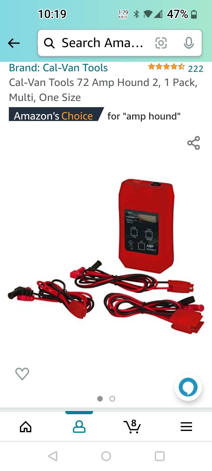

Temp gauges are inop.. fuel gauge works fine.blinkes headlights and taillights work fine..rear hatch release doesn't work.. I have the calvan tool amp hound that I will try to find a voltage parasite draw.. do you think maybe the instrument cluster could be the problem?
