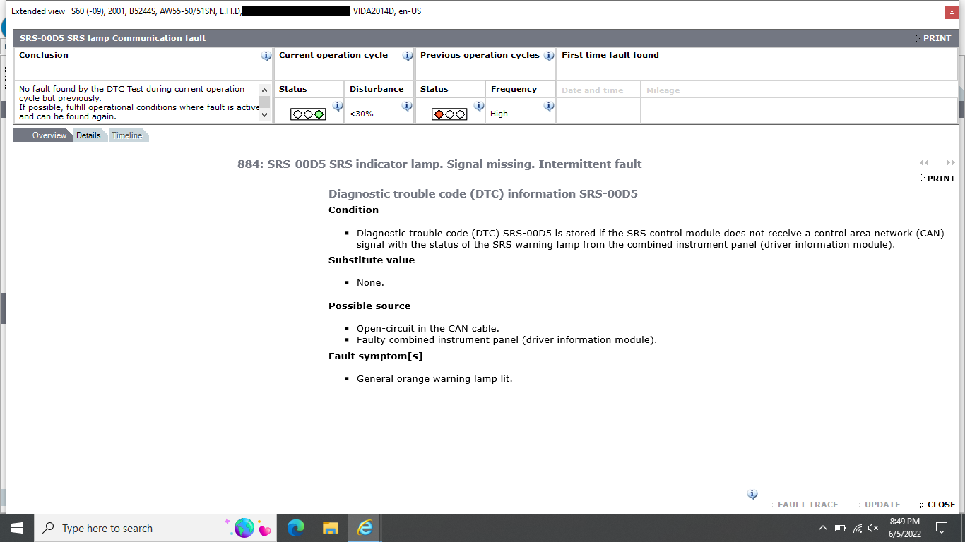

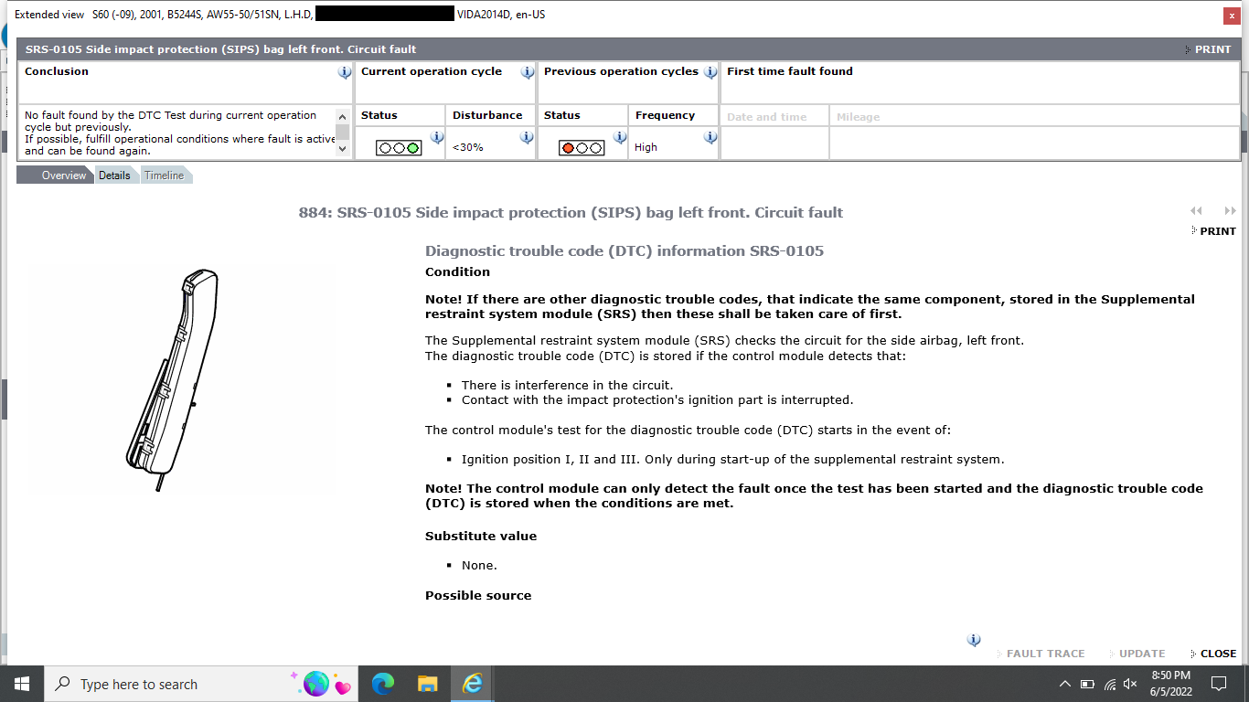

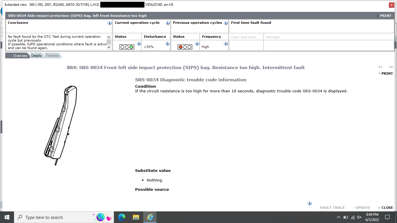

I just finished the repair. Old SIPS wiring was cut, so I replaced the SIPS with one with a good solid wiring harness.
Codes that showed red lights with the old SIPS: SRS-0034, SRS-00D5, SRS-0105. Same codes after replacement show all three with green lights in VIDA.
