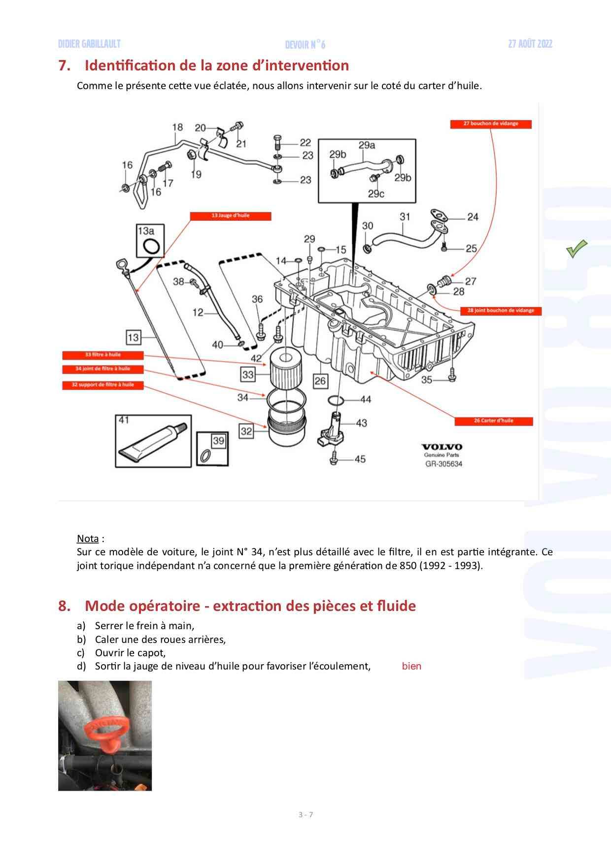

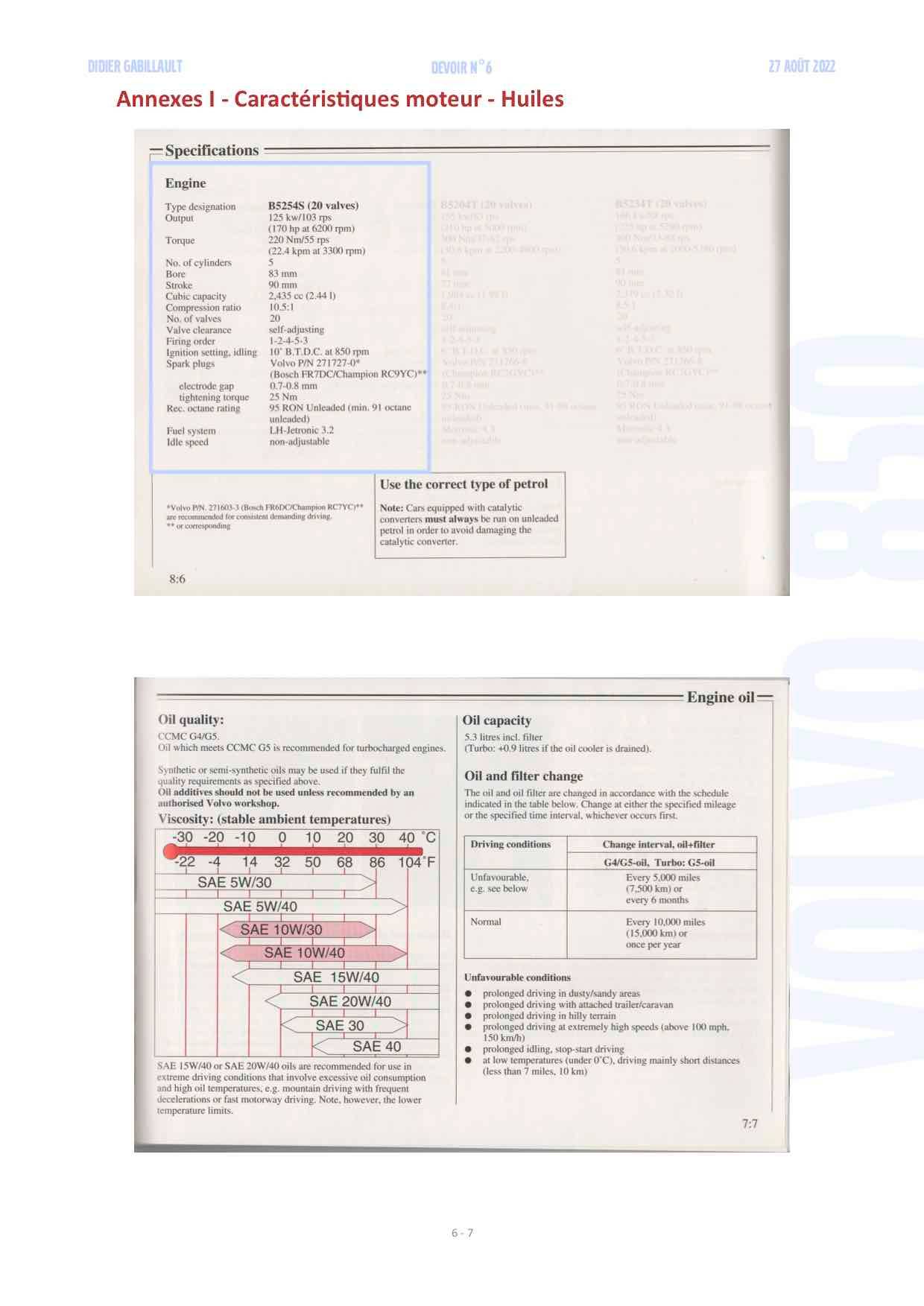

New homework final result : A.
The subject was how to change oil on a car. The folder explains how to, not useful to tell, anyone here does the oil changing eyes closed, so... !
It allows me to show you how i organize my homework. I'm not a genius, i didn't invent anything. Just to tell i lead my subject.
I will make a pause of a week in my studies, i've finaly found a garage to create my 850 Workshop. All my tools together, at least ! Pictures and videos to come.

Good and thorough job I'd say. Now if I only read French...................!
Actually I did take French in school 45+ years ago. Sometimes it amazes me that I still can read some and understand it too!
Nice work and congratulations!

Very well done. I can't read it, but it is well organized.
