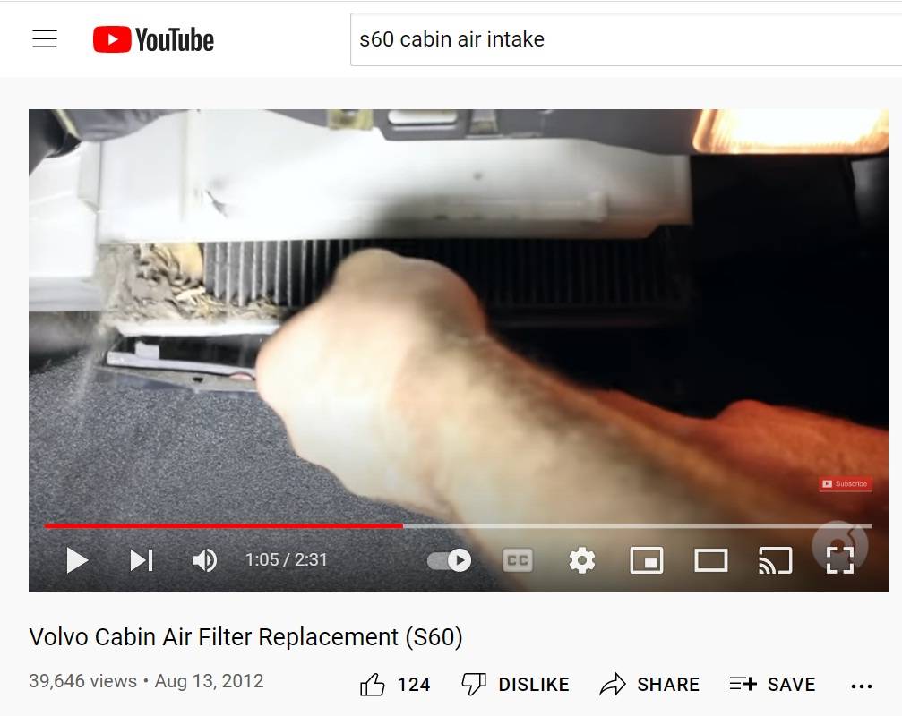

If you look at the air flow: air from outside enters the area close to you (aft part of car)
---> toward the fore area ---> HVAC unit for distribution.
You need to study the diagram of cabin air flow to do this.
If you look at the photo below (FCPEuro video on youtube), you will see leaves collecting in the area toward you.
Now cut a piece of cardboard the size of the cabin filter and insert into the slot closer to the firewall (there are 2 slots
for cabin filters) to prevent blown air from getting inside the car. Now make some attachment (cardboard + duct tape etc.) and attach to the leaf blower.
Just a thought.
Please report back what you do, I'd appreciate it.

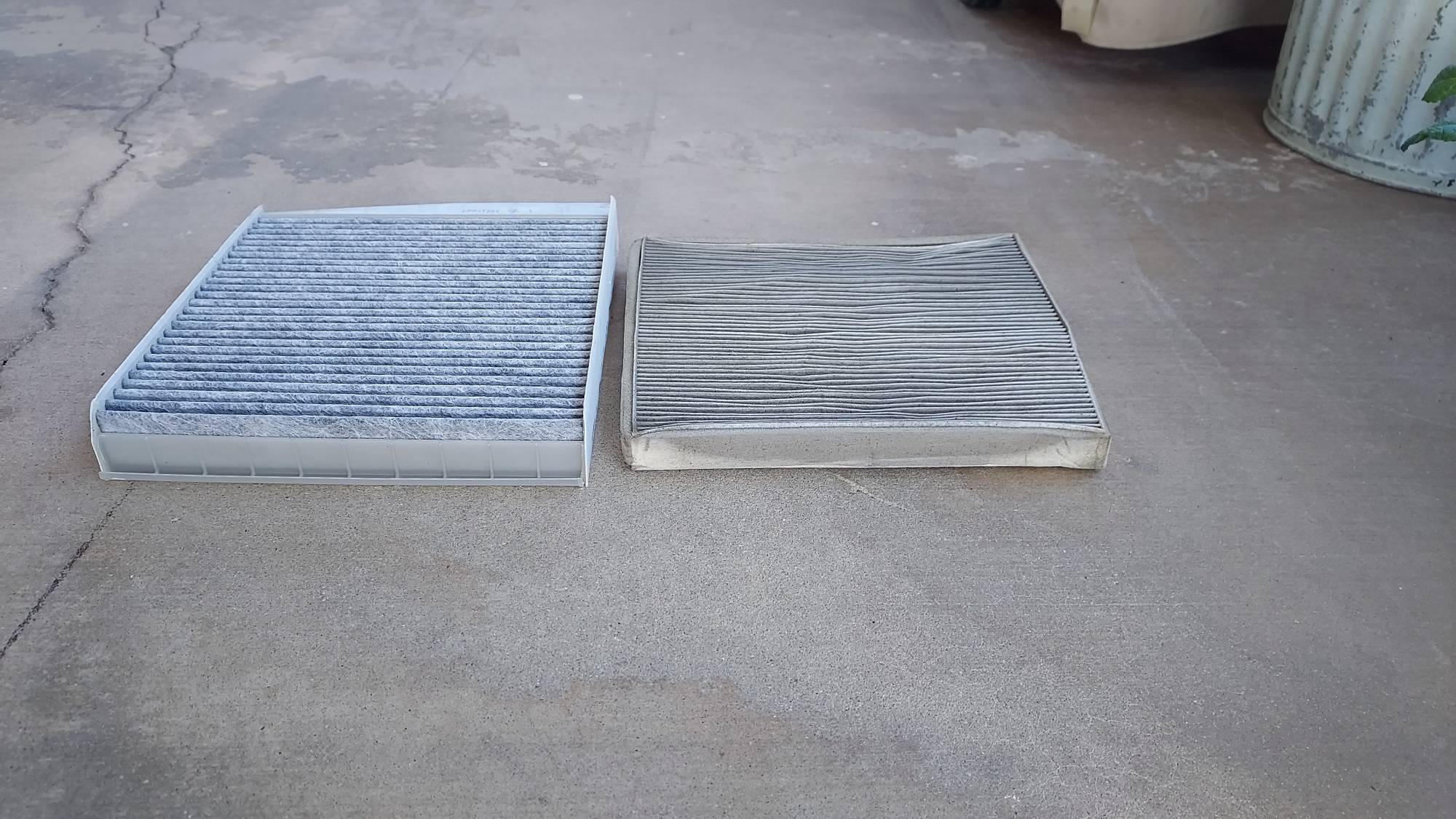

Hi and thanks for your replies.
I don't understand airflow "aft". I figured the air entered under the rear trailing edge of the hood. Can you explain further? Couldn't find a cabin airflow diagram.
Assume I would need to wedge the cardboard somehow, inside the filter slot. Then use the leaf blower pushing air up and out through the filter slot? Where will the air exit? Outside?
Is this what you had in mind? I thought maybe I would need to blow it all out through the ducts and into the car cabin in order to get everything out of the ductwork. Please understand this is very fine sand dust, kind of like glitter almost. I thought after I put in the new (correct) filter it would stop the sand coming out the ducts. So I'm thinking some of this fine sand dust must be caught in the ductwork. I've cleaned the car numerous times and ran the AC full blast but when I use it again the next day or even hours later, here comes the sand lightly coating everything.
