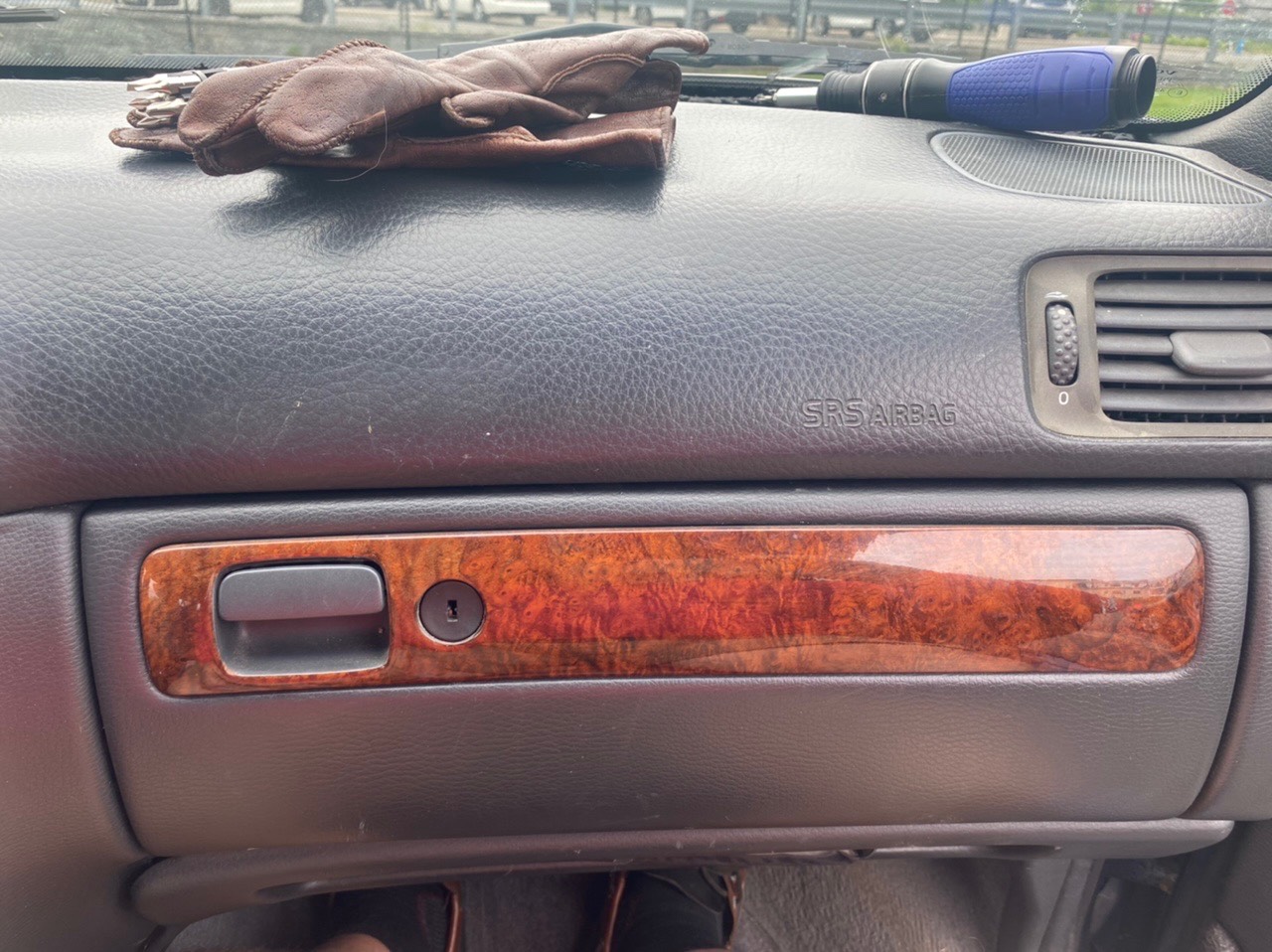

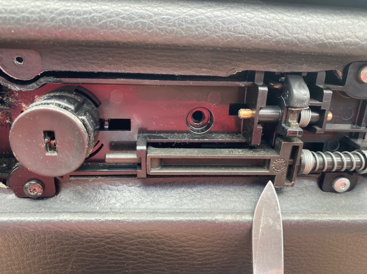

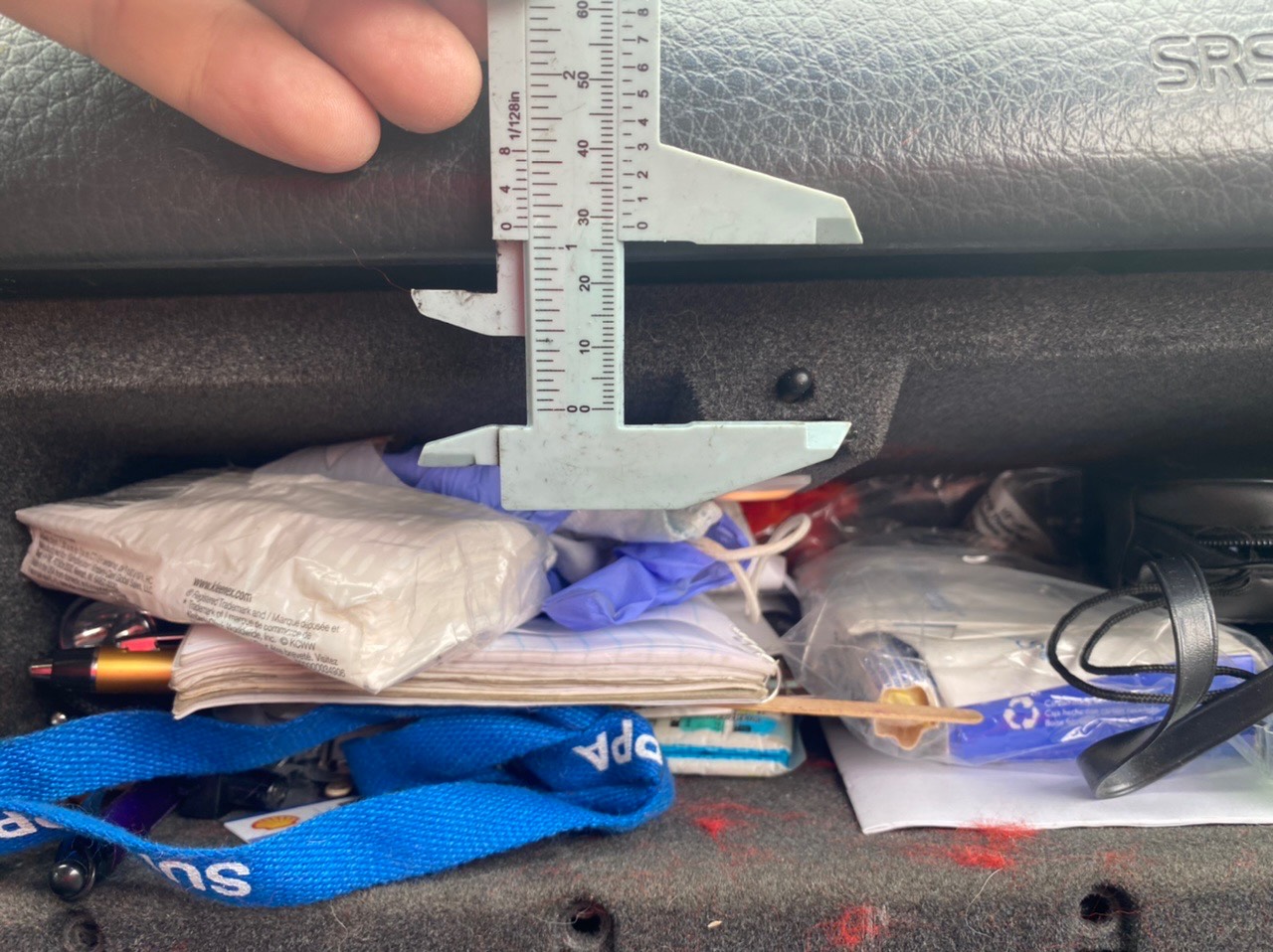

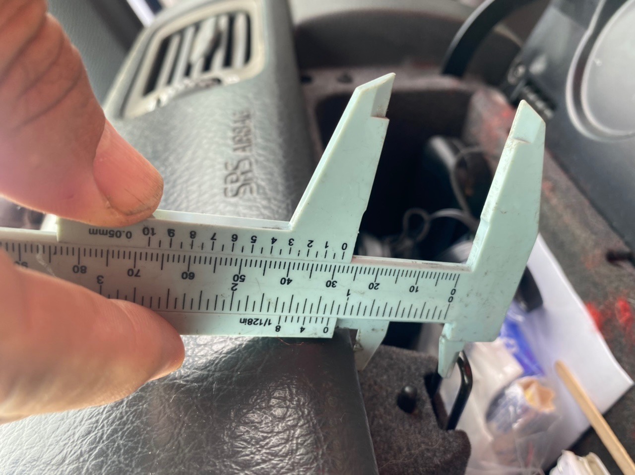

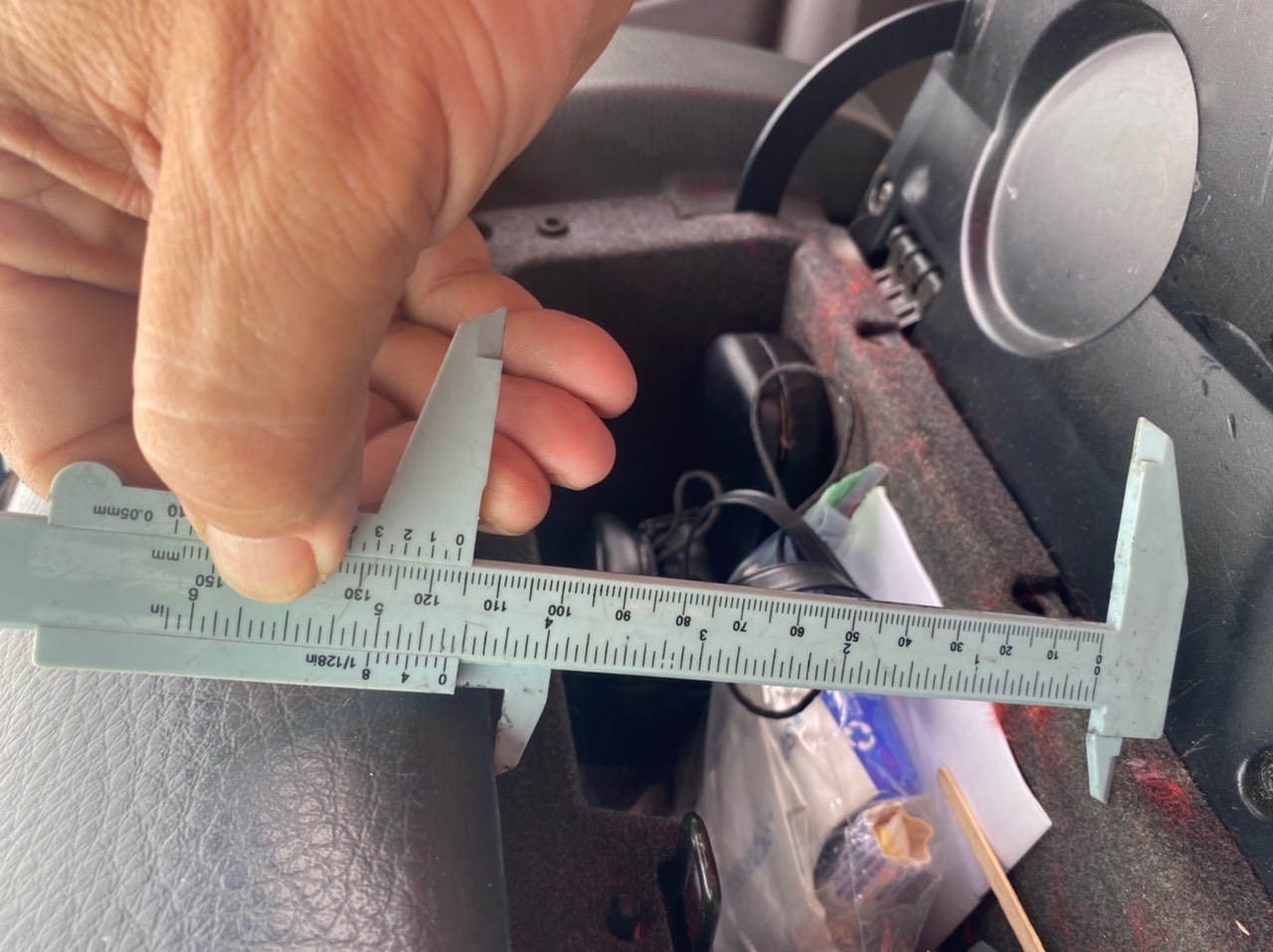

Picture bank…it looks like I can slip a thin blade in 65 mm starboard side of the key hole and release the lock that way

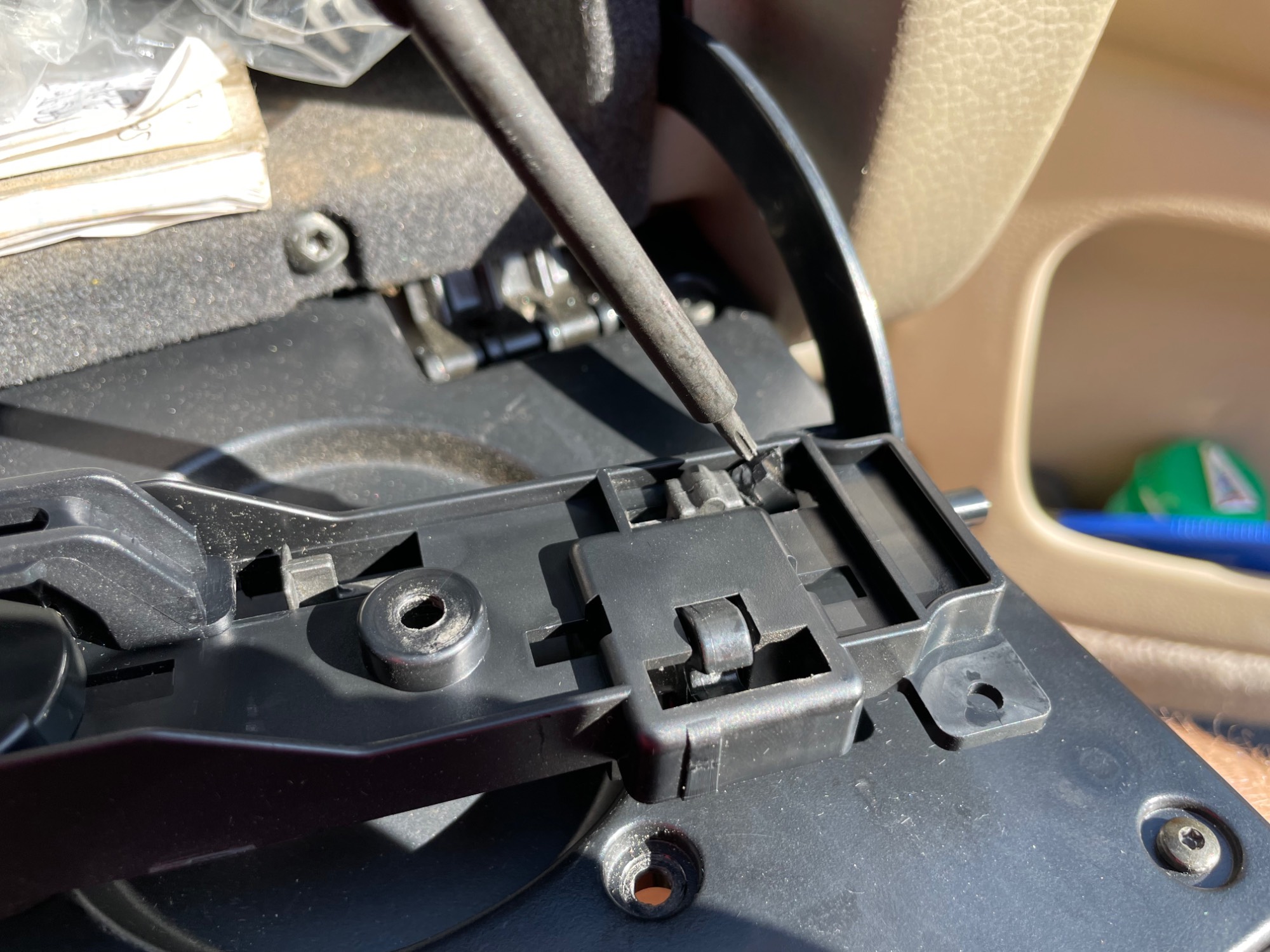

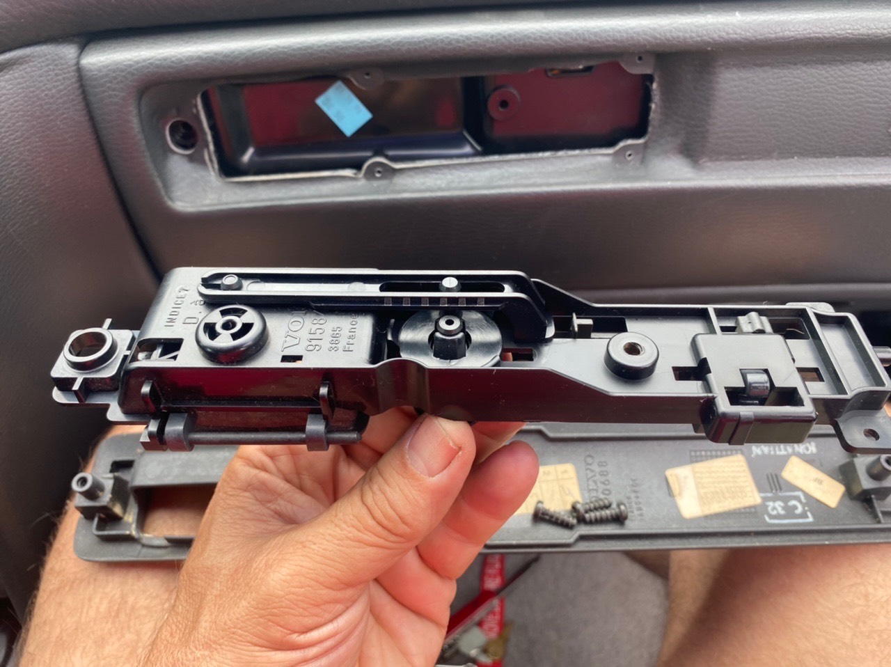

So you have taken another glove box apart to figure out what is going on? So no luck with using a screw driver on the latch rocker under the handle first?
I just disassembled a spare yesterday and found the same LH hinge pin locator broken that Robert shows in his video. This means the LG end of the handle does not give downward pressure on the latch rocker which is at the LH end. Use of a curved tool like Robert uses (a trim remover) or even a wide flat screwdriver should be able to do the same.
I know in Robert's video he also shows a secondary failure of the slider mechanism.

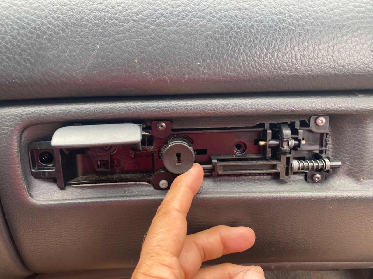

One cool thing on the v70 series. If you leave the three screws off and just Velcro the trim in, you can address the next stuck box easily

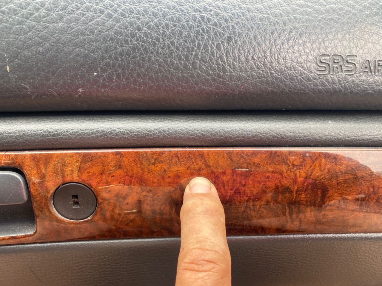

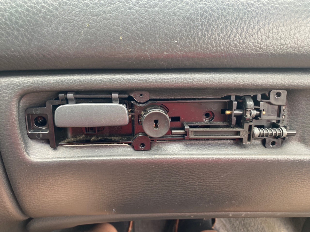

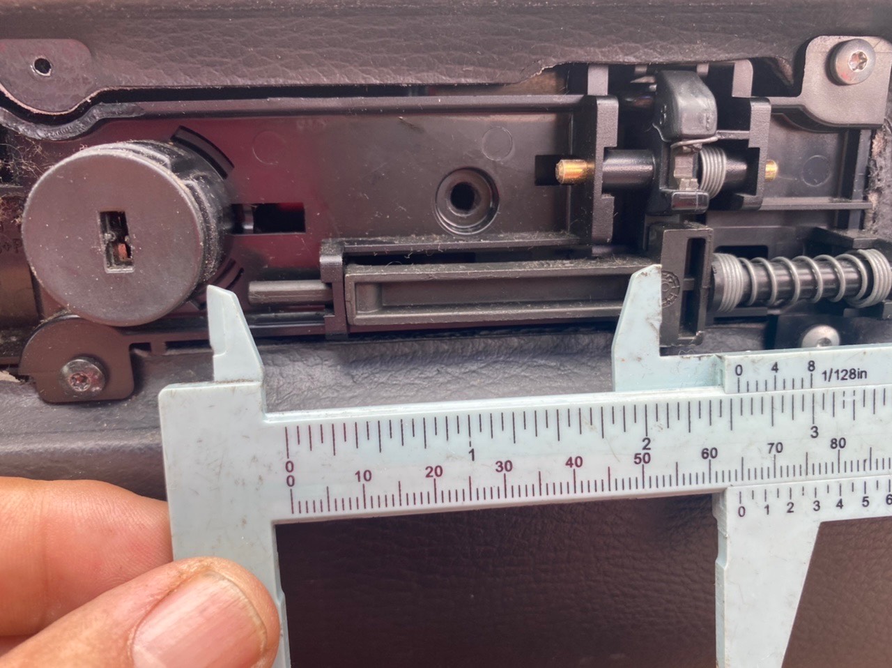

Two knife trick worked like a charm. One knife eases the fancy wood trim up at bottom , 3mm
The other goes in 60 mm to right of key hole and slides the release over
It popped right open
Root cause. The slide isn’t going far enough to right to release the pawl. Not sure what is worn or has gone out of tolerance yet.
The wood trim piece is in by friction so I can easily access the lock and pop it open

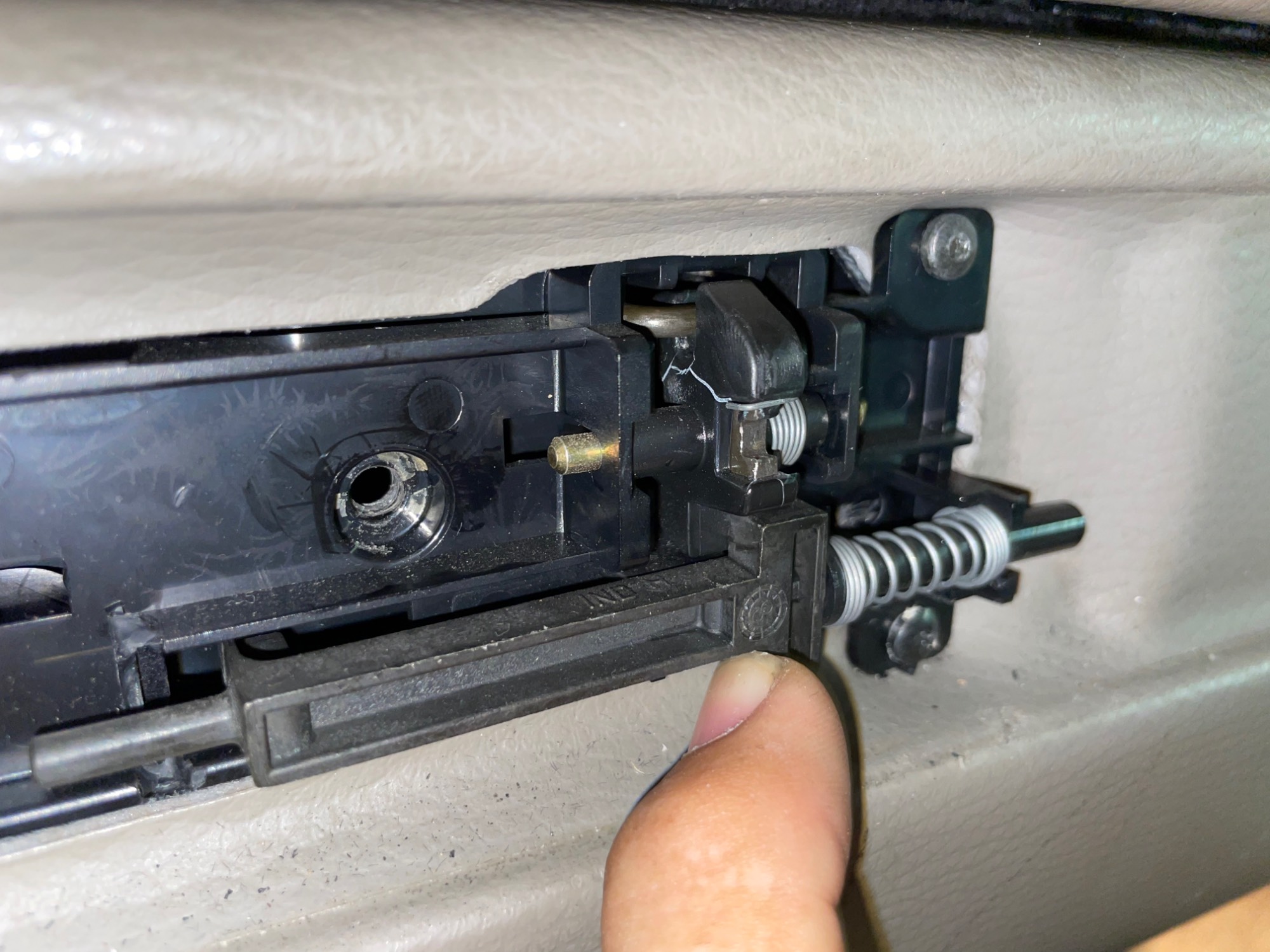

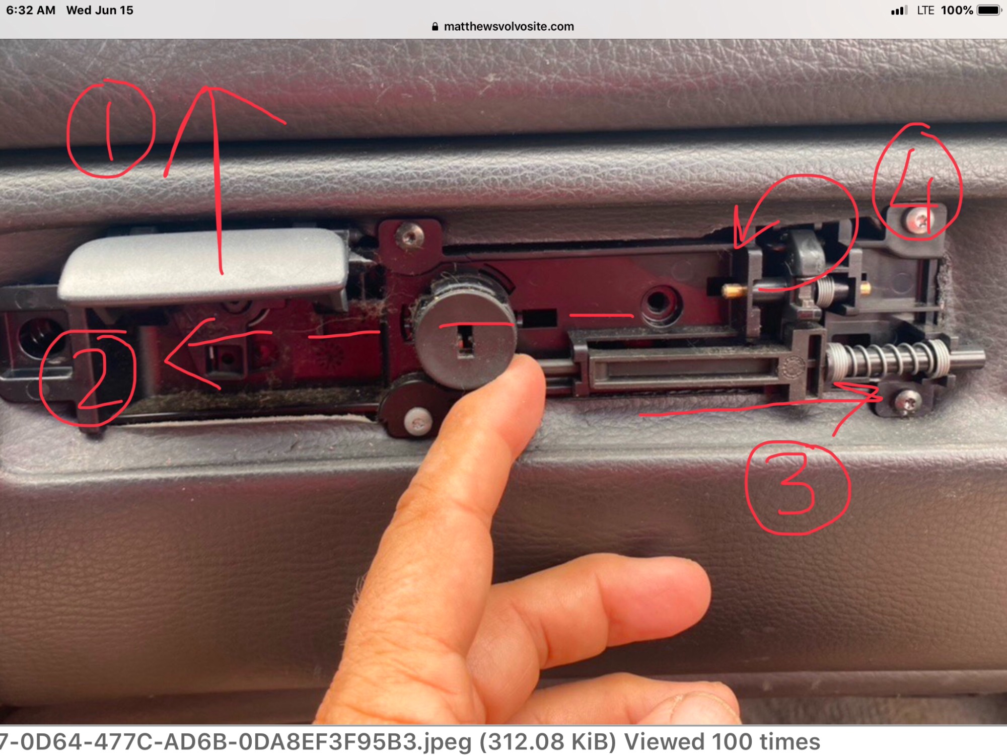

Here’s the action on the 1998 99 00
Lifting handle 1, pivots and moves the lever in the front ( hidden, 2) , which then pushes the release (3), freeing the spring cam (4) , releasing it from the wire latch lock.
On mine, even hand pressure to right on 3 is not releasing the cam(4) so something has moved or worn , probably in the front part.

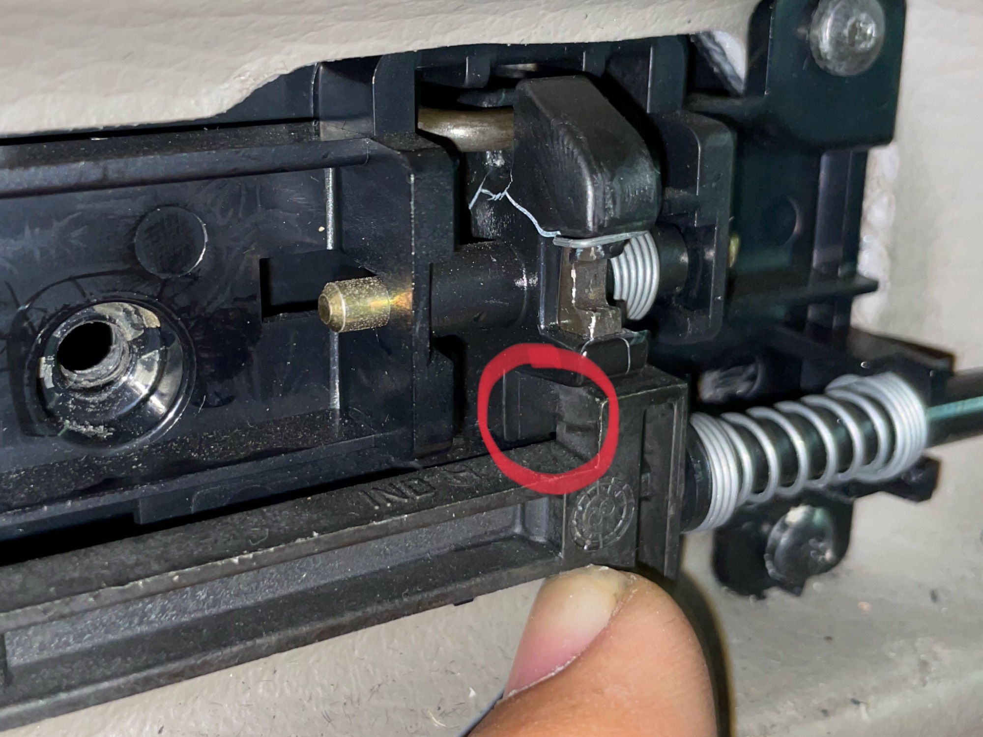

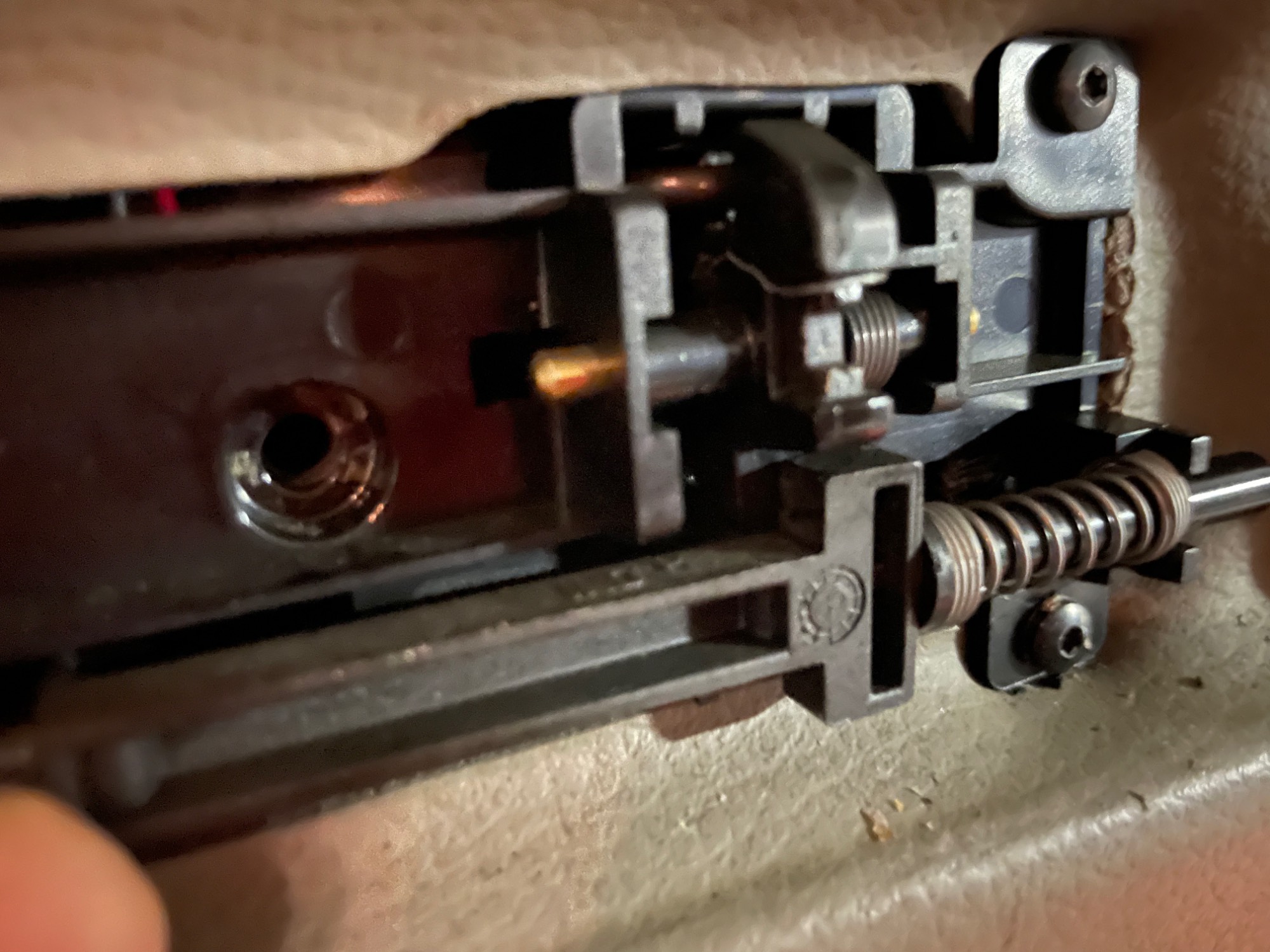

- Here is the hang up
- 030AC000-EB9F-4A6E-9AB3-F2834131A865.jpeg (480.75 KiB) Viewed 659 times

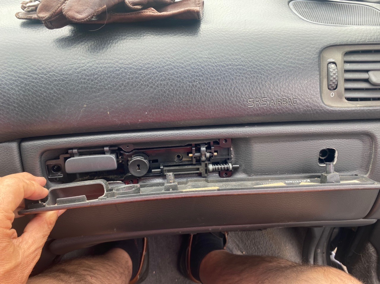

Root cause
A piece of plastic from the trim mount had broken and fallen neatly into the front shuttle latch, blocking full throw. This stopped the latch clevis from releasing.
All well
Left off the trim t25 as prophylaxis for future problems
7500 mile oil, nice
All well
