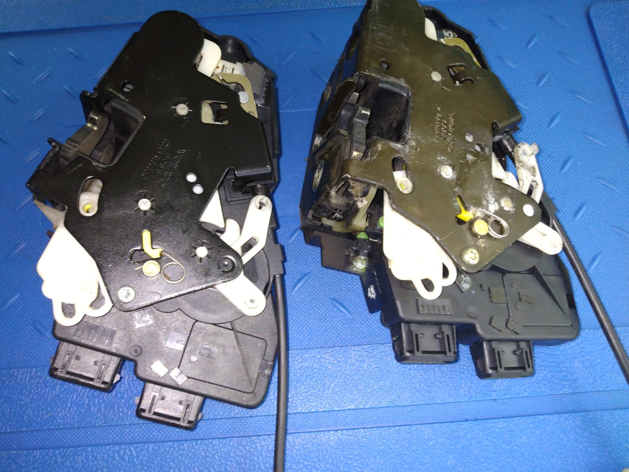

Despite my previous posts, I believe I have found the genisis of all of my issues - the driver's side door latch/lock actuator.
I pulled the door latch from my V70 parts car and compared it w/the removed S70 door latch.
The door knob/pivot on the S70 only moved about half way while in the car.
After it was pulled, I was able to free it up to move in it's full range of motion.
Additionally, the "nub" where the door knob attaches to the pivot is broken on one side so the knob will not stay attached (can you see that in the image)?
The questions are:
how/should I lubricate the plastic pivot points;
will I need to use the V70 key and should he key be scanned;
can I test it before a re-install;
what is the process to reset the alarm?
I think that is enough for today, lol.
Thank you, Tommy
I have pulled the drivers side latch/actuator from my '98 V70 parts car.
Comparing the two, the first image from the parts car,
The questions are:
Thank you, Tommy
