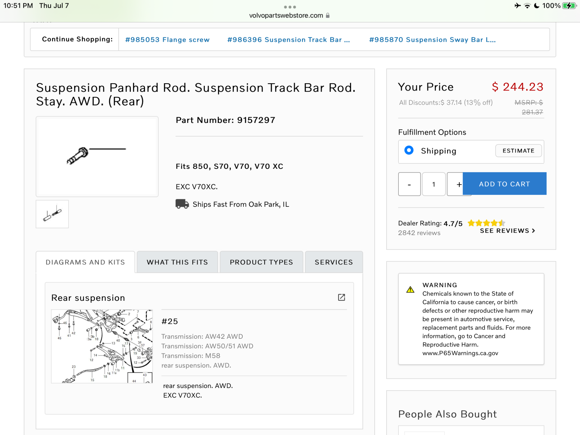

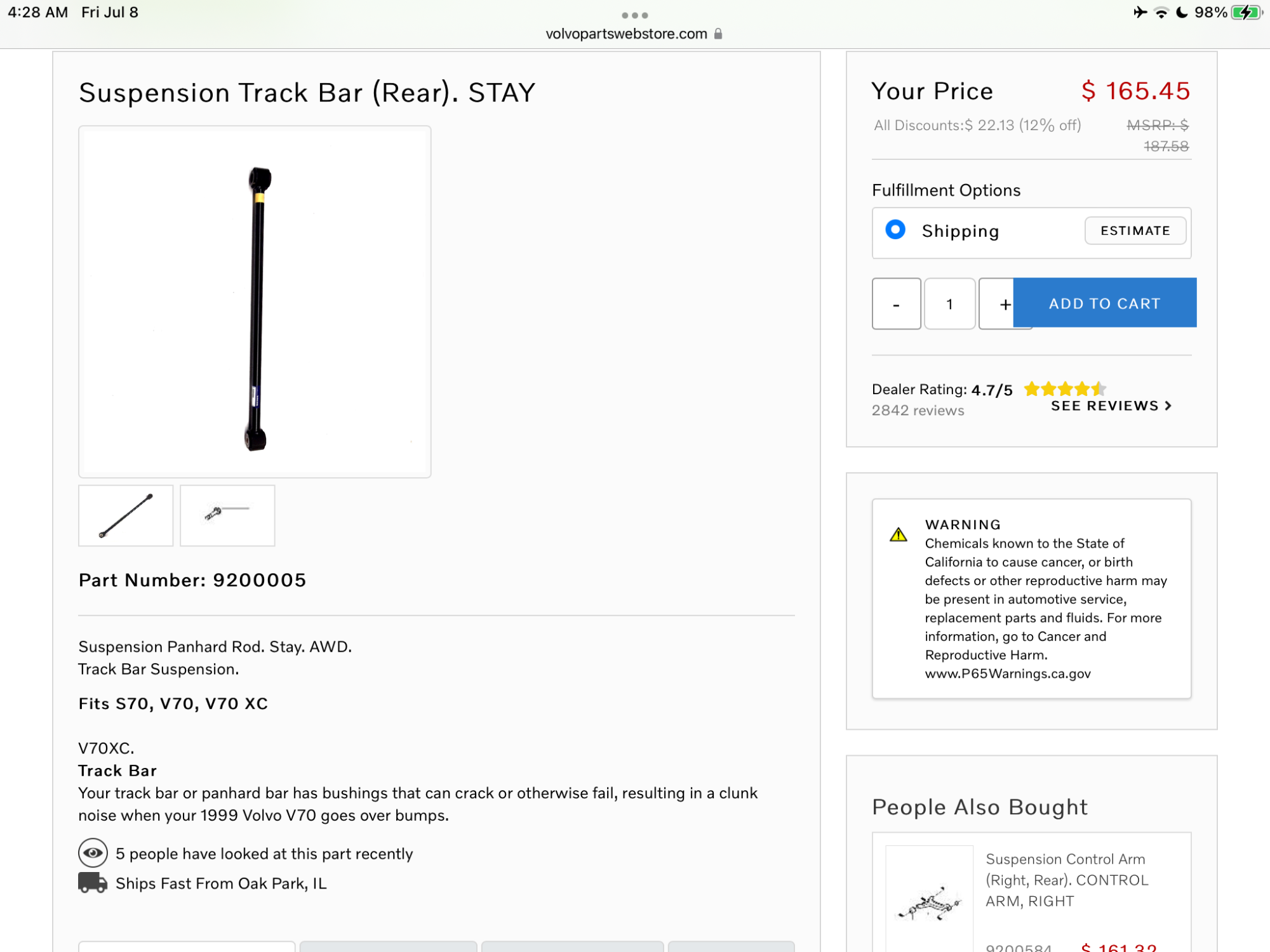

There appear to be two part numbers. Little confusing text on the application
9157297 AWD except XC
9200005 for XC

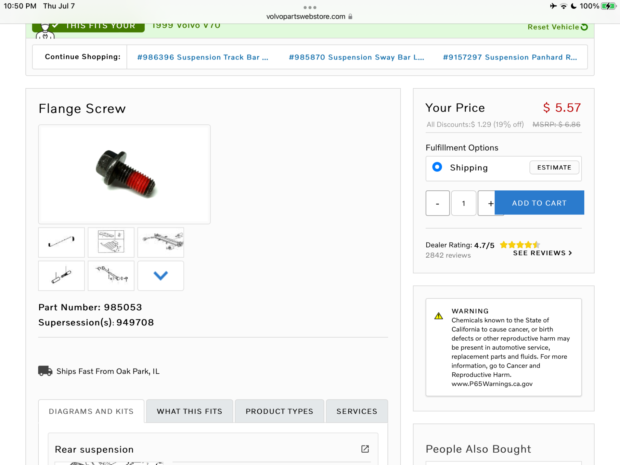

Outboard attaches with a M12x 25 flange bolt, 17 mmhexhed

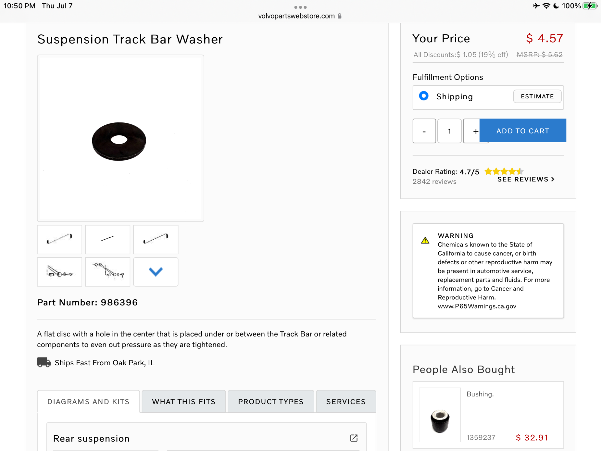

There is a large flat custom washer on this, from Tasca or Volvo only
Bolt 985053 or 949708
Washer 986396

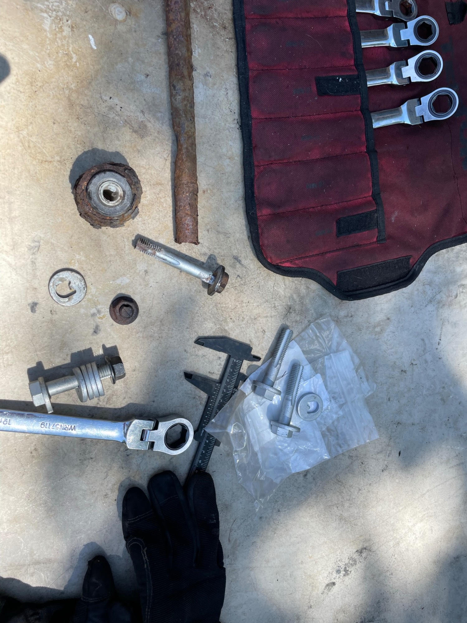

Inboard is the adjustable toe in consisting of a long slotted eccentric bolt, a internal toothwasher, and a lock bolt
The bolt inserts from front, you have to turn the eccentric to clear the differential
The factory bolt uses a fancy hex boss at the top of the bolt with an internal hex washer that fits inthe boss.
The replacement bolt has the eccentric cast as one piece
Bolt 986933 …..this shows as NLA at Tasca….uh oh
Washer…
Nut. 985870 at Tasca
Washer…

You can see I broke one removing it, a $25 dollar mistake. When I go to do the right side on this car, I will cut the nut off with a Dremel to
Preserve the NLA BOLT.
Both nuts and the slotted washers are still available and used in P2s so those should be around for a while.
Bolt fab idea. A M12x 100 bolt, then Dremel a channel length wise to receive two slotted washers. Chase threads. Tack weld head washer to shank or bolt head
