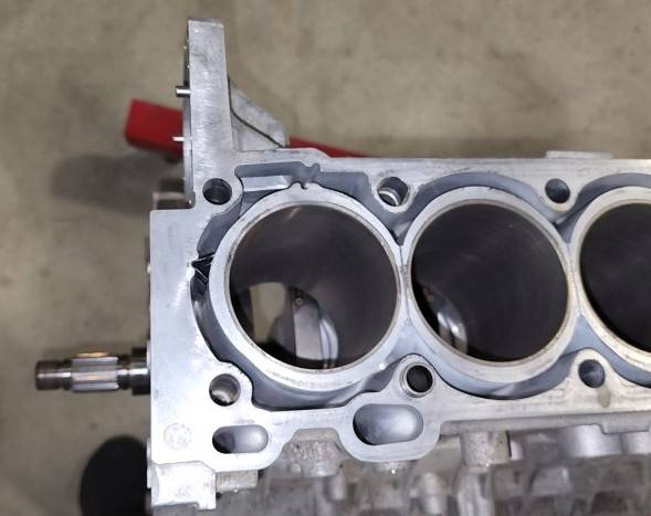

My Block Front:
Block Front.jpg (30.34 KiB) Viewed 786 times
My Block Rear:
Block Rear.jpg (38.37 KiB) Viewed 786 times
The VIDA dwg is at best ambiguous… I “think” I see the flywheel flange on the crank which would mean it is showing the back of the block, but maybe that is a H Balancer. But the water jacket more closely resembles the front, the diagram matches portions of both the front and the back!

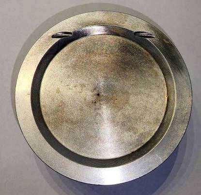

My piston, faint arrow points to the right, PN reads right side up if you view from the right in this photo, wear spot on the skirt Teflon coating is on the valve relief side:
[/attachment]
Piston Arrow Right.jpg (32.85 KiB) Viewed 786 times
Assumptions:
1. The valve pockets s/b for the intake (larger) valves. This would mean arrow points towards front of engine.
2. Scuff mark on skirt s/b on the exhaust (thrust) side of the block for this clockwise spinning engine. Arrow to the back for that to happen, and valve reliefs would be on the exhaust side.
3. Volvo issued a TSB for ring replacement that clearly states piston arrow to the front, but the TSB starts in 2013 and does not appear to include my engine
https://static.nhtsa.gov/odi/tsbs/2019/ ... 4-9999.pdf:
I am going to install the pistons arrow front as in my opinion the valve relief pockets trump all other considerations, and in every case I can recall any arrow points either front or exhaust. Do not want them to hit is most important.
