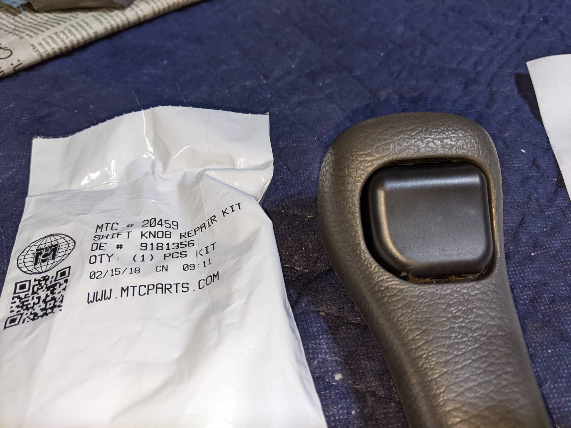

As promised here is how I fixed the problem.
To recap, I needed to replace the automatic shift button on one of my spare gear knobs as it had deteriorated to the point where it would break off eventually or jam.
I purchased 3 replacement MTC knobs from IPD and have used these before with no issues. Once you have done this once it is fairly straight forward as per the supplied instructions from IPD.

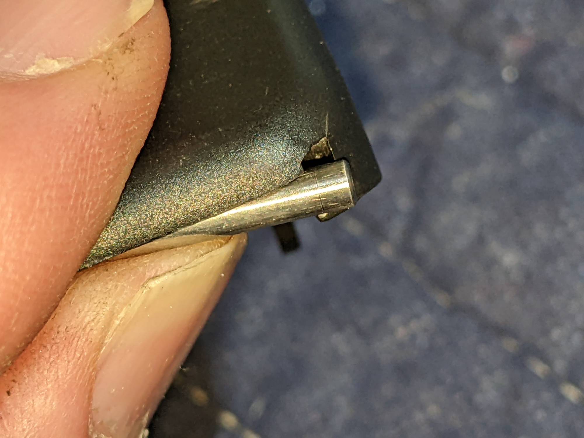

My issue was that when I tried to fit the new button as per the instructions I could not get it to easily fit over the lower pivot pin. If you look closely at the picture you can see where trying to force it on has already caused a small crack on the RH end in the picture below
Note: DO NOT FORCE THE NEW MTC BUTTON ONTO THE SEATING PIN!!
Below is how the pin should sit in the lower pocket of the old button. You can also see how much has broken off the original!!
To get the pin to fit as per the original I ground and filed 1.5-2mm off the original pin (new ones are not supplied but should not be needed)
