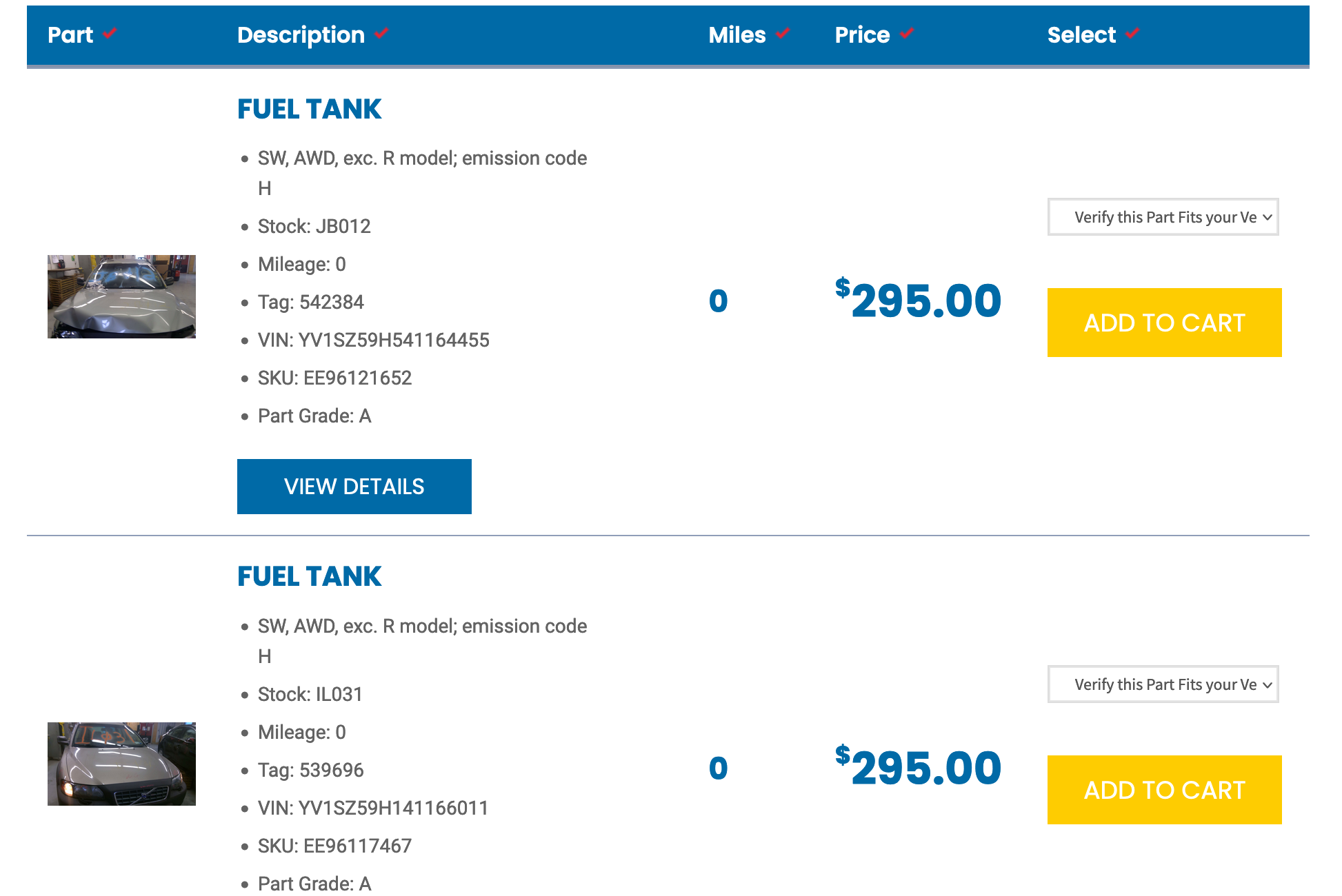

He told me a fule tank would cost $700, so I am now at $1,100. Does anyone know of a place I could buy a used fuel tank in decent shape so I would be backed up at least if it is a bad fuel tank?
I can't have this guy tearing the car apart only to tell me it is a bad gas tank and I don't have one to give him.

Erie has two , check your emission code to match. ELapsed time to search, 15 seconds
