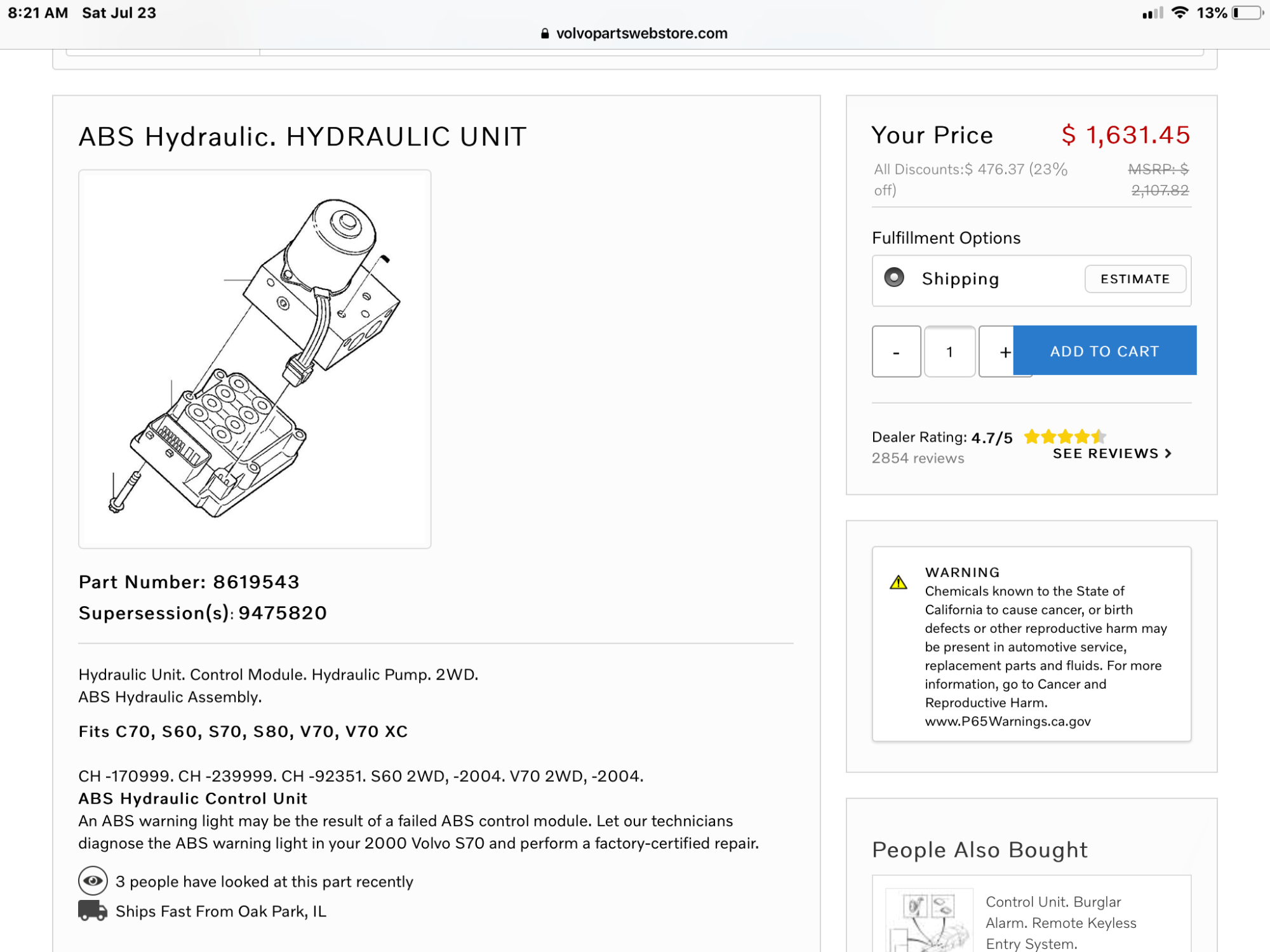

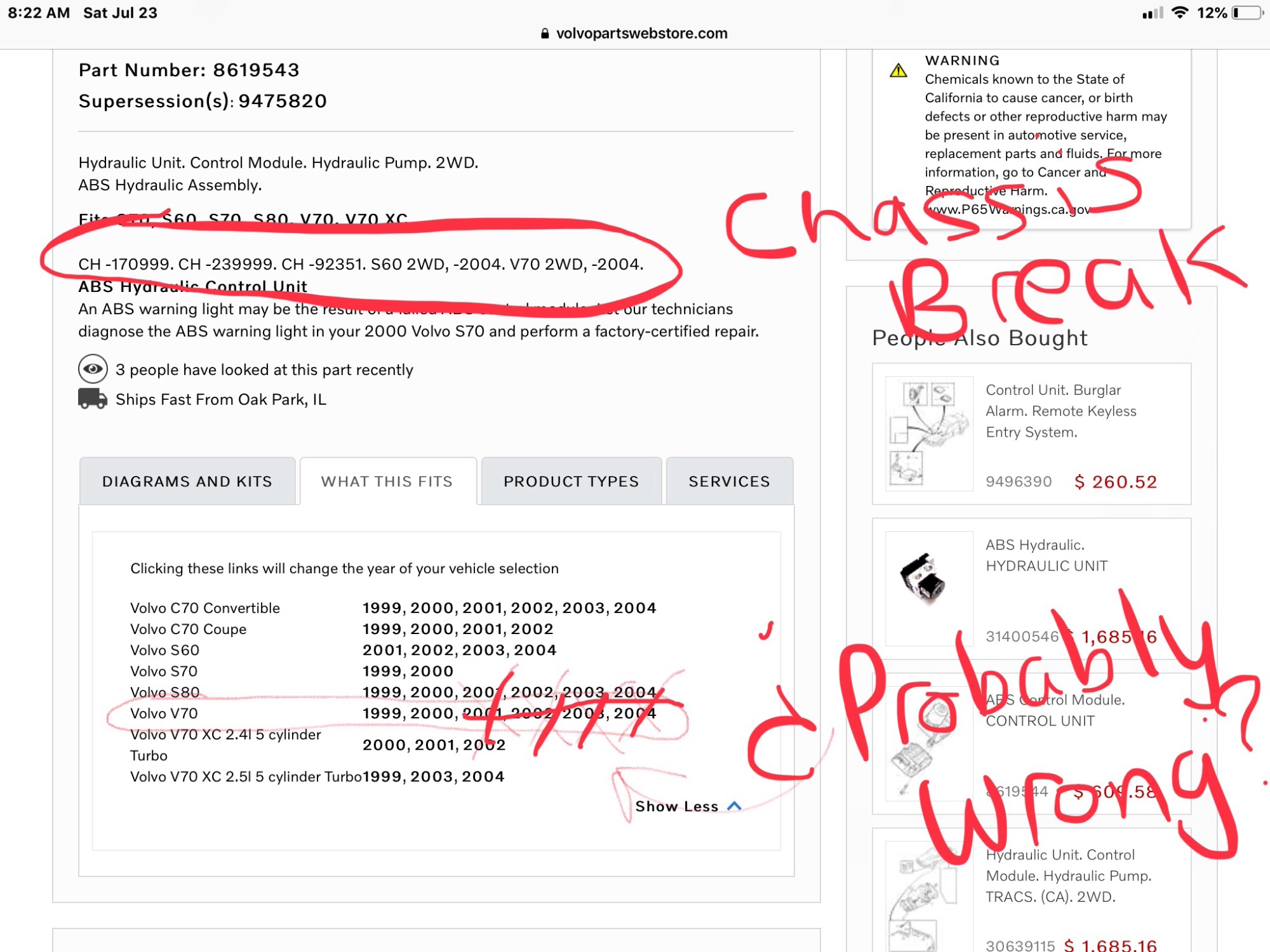

Digging into this, there are three components here but it doesn’t look like all three are orderable from Volvo
Black cylindrical PUMP motor, provides into for pump
Aluminum BLOCK containing valves and centrifugal pump
Black plastic ABS module...mattymoo is the go to for this repair or replace
I ***** think ***** only the module requires matching no/TRACS/ STC
I have taken the pump off a block and swapped, putting the pump back in is a bit of pig but doable.
Pictures from volvoparts we store below, annotated.
