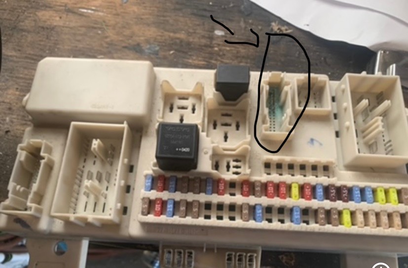

I have a 2005 Volvo S40 T5 turbo AWD the CEM (passenger Fuse box) the Roof-2 port has a few missing connector does anyone know what the port controls. Attached is a photo of the port.

Do you have VIDA offline? All the information you need is there.2005VolvoS40 wrote: 17 Jul 2022, 16:40 does anyone know what the port controls. Attached is a photo of the port.
That is connector H.
Control module terminal, Signal type, Ignition off Active / Not active, Ignition on Active / Not active, Miscellaneous notes.
#H1 LED seat belt reminder power supply, Ulow, Ubat/Ulow.
#H2 LED reduced alarm position power supply, Ulow, Ubat/Ulow.
#H3 Remote Keyless Entry (RKE), signal, At communication the voltage is Ubat-(1-1.5) V
#H4 Roof console and sun roof motor power supply, Ubat, Ubat.
#H5 Automatic anti-glare door mirror inhibitor control signal, Ulow, Ubat/Ulow.
#H6 Remote Keyless Entry (RKE) power supply, Ubat, Ubat.
#H7 Rain sensor module (RSM), power supply, Ubat, Ubat.
#H8 Communication CAN_H low speed network, The voltage is 2.0-3.5 V during communication, AEM
#H9 Reserve - -
#H10 Reserve - -
#H11 Reserve - -
#H12 Reserve - -
#H13 Reserve - -
#H14 Reserve - -
#H15 Reserve - -
#H16 Reserve - -
#H17 Mass movement sensor (MMS) or movement sensor (IMS) (IMS replaces MMS for S40, C30, and V50 from and incl. model year 2012), communication signal, Ulow-Ubat, Ulow-Ubat, Communication with both MMS or movement sensor (IMS) (IMS replaces MMS for S40, C30, and V50 from and incl. model year 2012), for 5DRS.
#H18 Control signal, comfort closing Ulow Ulow/Ubat
#H19 Switch reduced alarm position, control signal Ubat Ulow/Ubat
#H20 Control signal, sun roof Ulow Ubat-Ulow/Ulow f=1.381*speed (Km/h), 50% pulse ratio.
#H21 Mass movement sensor (MMS) or movement sensor (IMS) (IMS replaces MMS for S40, C30, and V50 from and incl. model year 2012), voltage feed, Ubat/Ulow, Ubat/Ulow, Feeds voltage to both MMS or movement sensor (IMS) (IMS replaces MMS for S40, C30, and V50 from and incl. model year 2012), for 5DRS.
#H22 PAD warning lamp power supply, Ulow, Ubat/Ulow,
#H23 Communication LIN bus 9, During communication the voltage is 0V - Ubat, Rain sensor module (RSM)
#H24 Communication CAN L low speed network, The voltage is 1.5-2.5 V during communication, AEM
#H25 Reserve - -
#H26 Reserve - -
#H27 Reserve - -
#H28 Reserve - -
#H29 Reserve - -
#H30 Reserve - -
#H31 Reserve - -
#H32 Reserve - -
