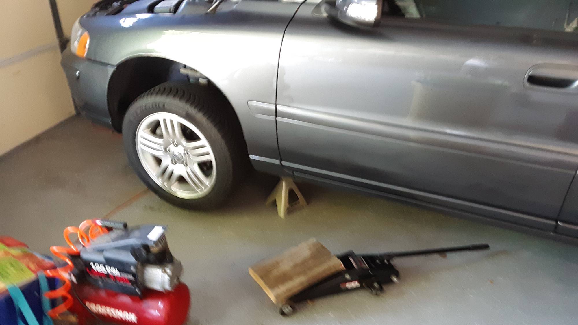

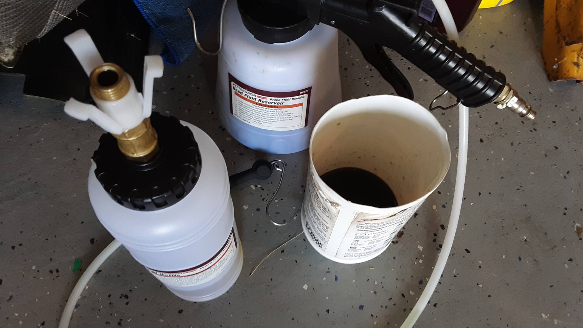

Flush complete yesterday. Wow that fluid was a olive green nasty mess. Is took just under a liter to complete.
I used a $31 Harbor Freight bleeder that hooks to your air compressor. My compressor was a little small to keep 100psi continuous pressure to pull the vacuum to suck out of the caliper so had to help by pumping the pedal but still helped to make a one person job.
Only piece I missed was how to flush the ABS unit. I did go to a nearby gravel road to actuate the ABS a few times, not sure that'll help anything.

Thanks Krons for the post I have been wondering about this tool.
https://www.harborfreight.com/brake-flu ... 92924.html
These pneumatic bleeders are set up from the other side, they use the air compressor to create vacuum on the caliper side. Therefore the master cylinder side is not pressurized. It's a cheap ($32) and tidy solution. I have not tried it but I am interested.cn90 wrote: 31 Jul 2022, 07:57 You have it up to 100 psi and the reservoir did not blow up?
I made my own ATE brake bleeder cap and use only 10-15 psi (photos and info in S80 forum)...

Erik hit it, uses 100psi at the tool on the caliper to create vacuum suck the fluid out. Not pressurize the cap. I'd still buy again as it was easy to pump brakes and check when the hose had clear fluid in it.cn90 wrote: 31 Jul 2022, 07:57 You have it up to 100 psi and the reservoir did not blow up?
