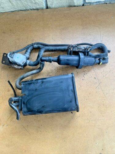

But this photo of an eBay junkyard Evap canister and associated hoses claimed to be pulled from a v70 shows more than the 2 hoses documented. Can anyone ID these parts? They do NOT match the diagram most often referenced (also attached below).
The J-hose and vent hoses have been cut on this butchered removal, the test pmp is there, but what is that cone-shaped item?
And what of the connecting hoses to the cone-shaped item?
I know this is a massive pain to get at, so I only want to do this once, so I want to make sure that every hose is replaced on the first try.

No reason to replace these. Just do the hoses. I think the cone thing is part 36 in your diagram, a buffer or protector for the leak detection pump

Thanks so much for your insight, but the white object in the photo is the test pump (5), on its bracket (so the conical object can't be the pump).

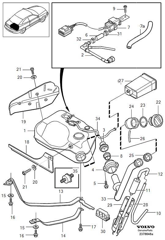

2) Supply air from the canister purge - this has to be the vent hose, #20 on the diagram, but note that there is also #7, (volvo part 8631637) also listed as "hose", but with no fitting shown to attach it to the #20 vent hose. When you look it up by part number, https://usparts.volvocars.com shows it as used on all P2 v70s, and illustrates it as a hose with a 30-degree diagonal transition in the middle, like the path taken in a "lane change", so it goes around something. But #20 and #7 are two different hoses, and the diagrams show that #20 simply plugs into #7, with no clamp other than a plastic cable tie, raising questions about how a vacuum is held. One presumes that one wants to pull the air in through the filter, #19.
3) Test pressure air from the pump. That's #6 - the J-Hose, 8677109
But where does all of this connect to the GAS TANK??? The only part (looking at the list associated with the diagram below) that seems a good suspect is #48 "Air Tube", but they do not show where this attaches on either the "tank" diagram or the "carbon filter" diagram. So how does the carbon filter connect to the fuel tank to get fumes?
Here we have the same Air Filter shown as part #29, but look at all the hoses here, #30 , #28, #27 (9470373)...
A different view is shown here: But part #34, which looks like the connection to the charcoal canister is NOT LISTED! (see
https://usparts.volvocars.com/a/Volvo__ ... 78648.html )
and #11 seems to be the filter associated with the carbon filter. The diagrams are just a mess here.

In the diagram, the J-Hose is part #6 (Volvo Part #8677109), and it is shown with the cut-away in the diagram, note the rough edges on the elbow-shaped part labeled "6", and the longer part of the hose that runs the length of the evap canister.
The vent hose is part #7 in the diagram, not part #20 - part 7 is Volvo #8631637, and it is a hose that includes a jog in the middle. It attaches to the plastic pipe (#20) that goes up to the fuel-filler vent (#19). And here is the fun part - it attaches with a ^%$#@$ PLASTIC CABLE TIE to the plastic pipe, shown as part #9 in the diagram. How this is supposed to be a leak-free fitting, I have no idea, but I guess a clamp would be tightened to the point of crushing the plastic pipe.
The consensus is that very few people buy the vent hose, and lots and lots of people buy the J-hose, so the J-hose is the likely suspect. But given that one must drop down the exhaust just to see the hoses, replacing every hose one can seems most prudent.
And don't ask how the evap system attaches to the fuel tank. No one can say, and the diagrams for both the Evap and Fuel tank are not clear, but I am assured that it is not a part that anyone (even the dealer) gets much call for. I assume it is part #34 in the fuel tank diagram in one of my prior posts above, but no one wanted to confirm.

Yes, tube 34 is the connection from tank to canister. The actual operation of this system is really simple, it’s the self diagnostic testing that adds all the complexity
