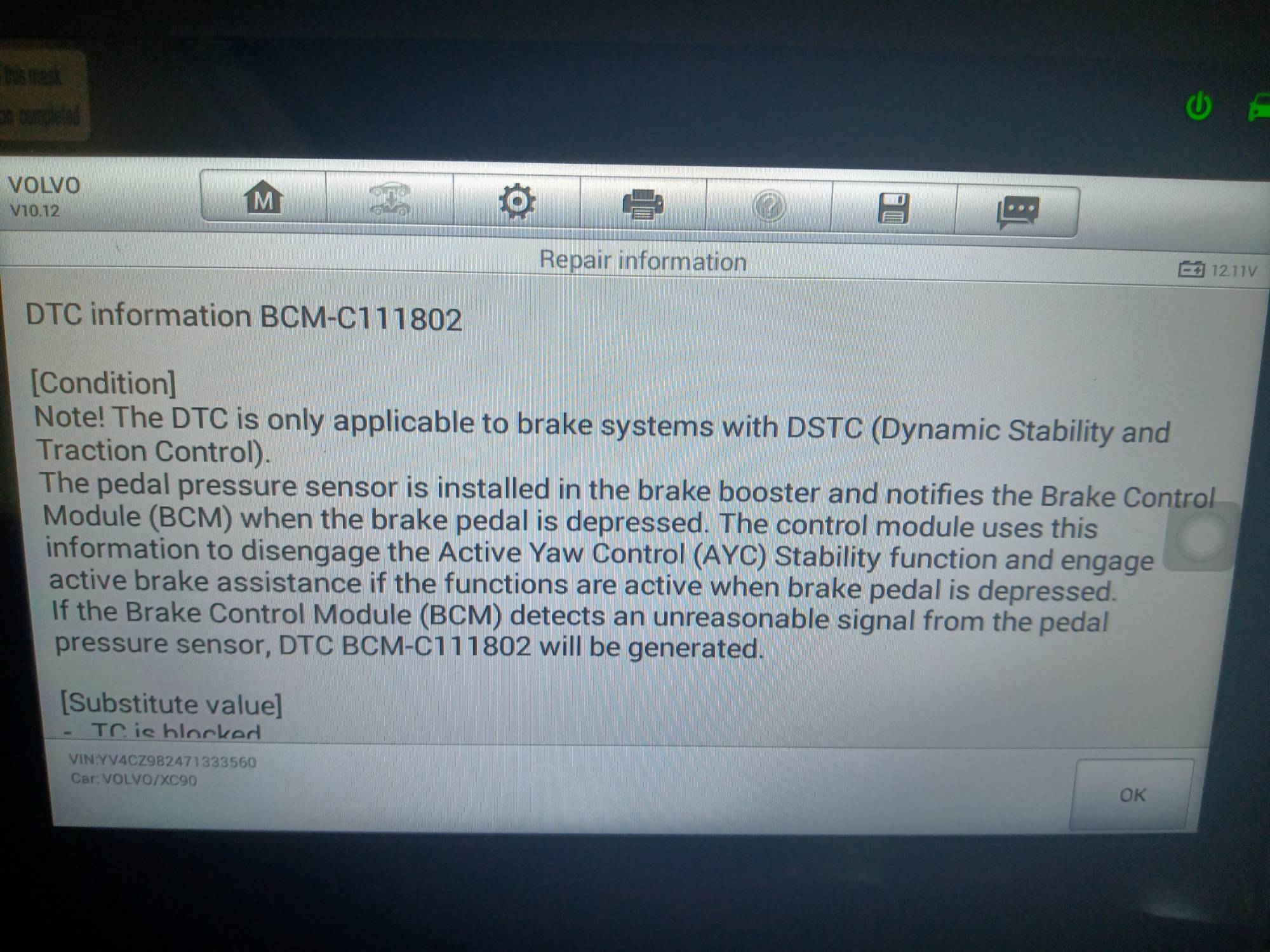

A traction control warning message is displayed along with the dash light and scan tool shows error code C111802 Brake Booster Release Switch is at fault. Where exactly is this part located please so I can replace it? Is it on the booster itself? Thanks

later realized I could just click on "service manual" at bottom of screen to get more info, and it does in fact point to the pedal pressure sensor which is the cylinder shaped thing that sticks out of the booster so I'll try replacing that.
