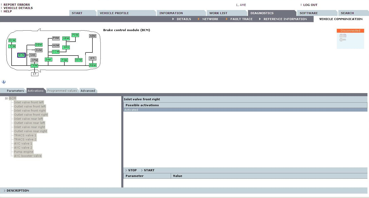

vtl has mentioned dealer required to bleed air from ABS. Is that something we can do from vida? Curious about that.

Absolutely. Trigger inlet/outlet valves of the line you're bleeding with Mityvac or vacuum pistol. Well, pumping a pedal may actually work as well. I just was doing it with a pistol, saw a few huge bubbles escaping from one corner. Squishy brakes were bothering me for years in that car. Not a single problem with the brakes linearity after bleeding the ABS.br0dy519 wrote: 03 Aug 2022, 17:54 vtl has mentioned dealer required to bleed air from ABS. Is that something we can do from vida? Curious about that.
