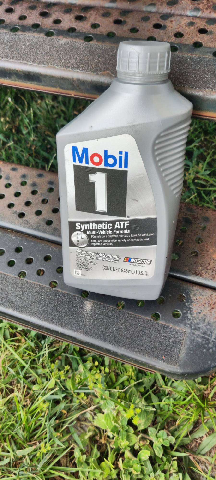

Hi
I have the stock automatic transmission the Asan 4 gear automatic.
Can I use this trans fluid?
I did a partial one quart change about 2000 miles ago, I used the factory stuff I bought from fcp Groton, about 13$ per quart.
I thought I saw on these forums, I could use this Mobil 1 synthetic ATF Multi vehicle formula
Meets or exceeds requirements of
Bosch TE-ML 09 ,
Ford Mercon V ,
JAS0 1-A
Allison C-4
Ohhhhh!!!!
It says here Volvo 97340 and Volvo 97341
And says...not recommended for applications requiring GM DEXRON -VI
thoughts? Ok to put in this 98 auto trans?
Thanks!

I used Mobil ATF 320 for years in my P80s, never tried sythetic

Yes, you can use it without any concern.
