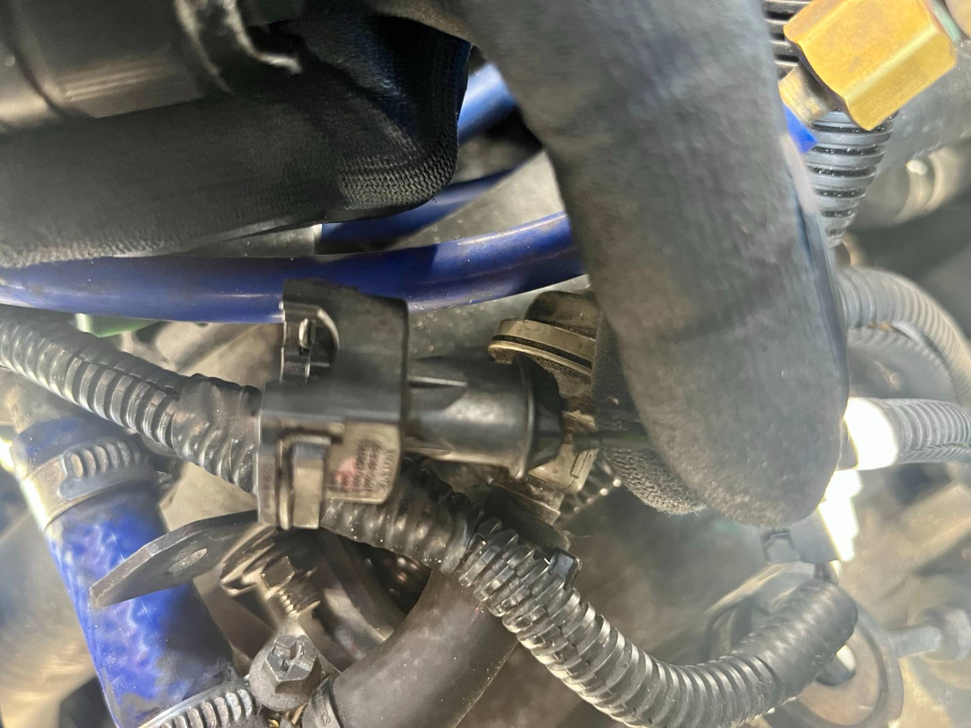

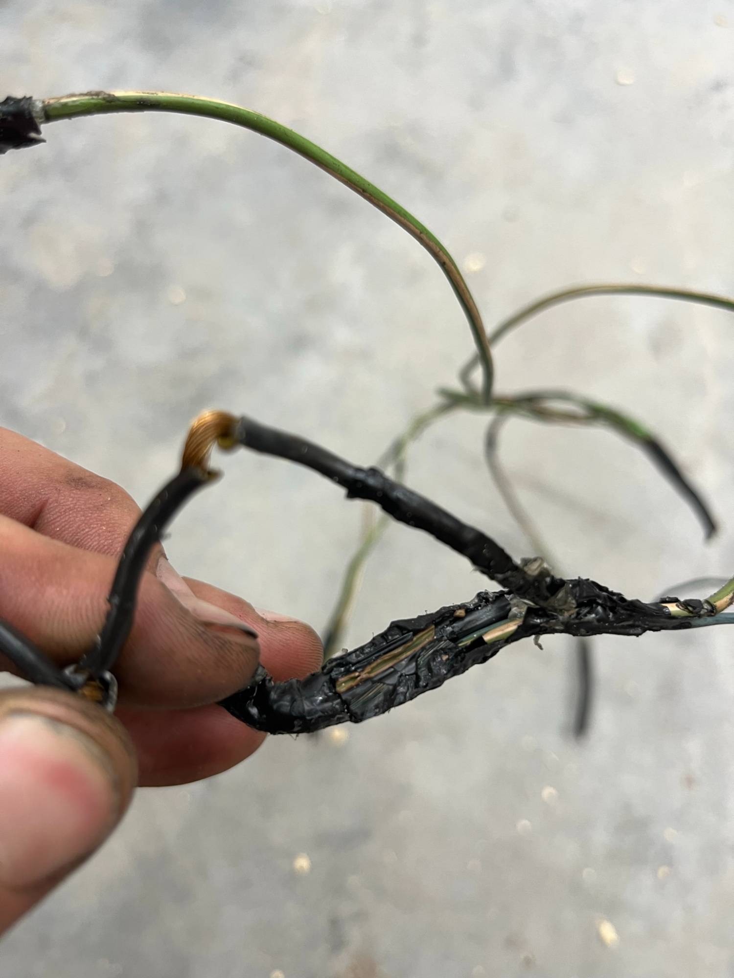

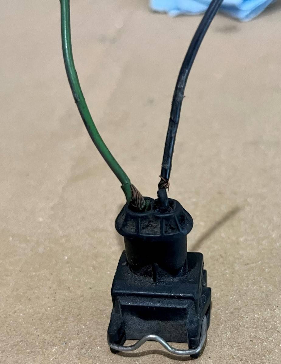

Discovered the PTC heater wiring leads have exposed wires & corrosion right at the connector. You can better see this in the photo after I cut the connector off the main harness. I suspect this was causing a short, and shares a common ground w/ the ETM, and common power to the TCV. Since the corrosion was so close to the connector, I decided to repair:
Sprayed w/ QD Contact Cleaner
Dabbed w/ Starbrite liquid electrical tape
Slipped heat shrink over each lead
Re-soldered to the main harness (w/ heat shrink), and new loom
Again, it's running fine. No fault set at any time.
