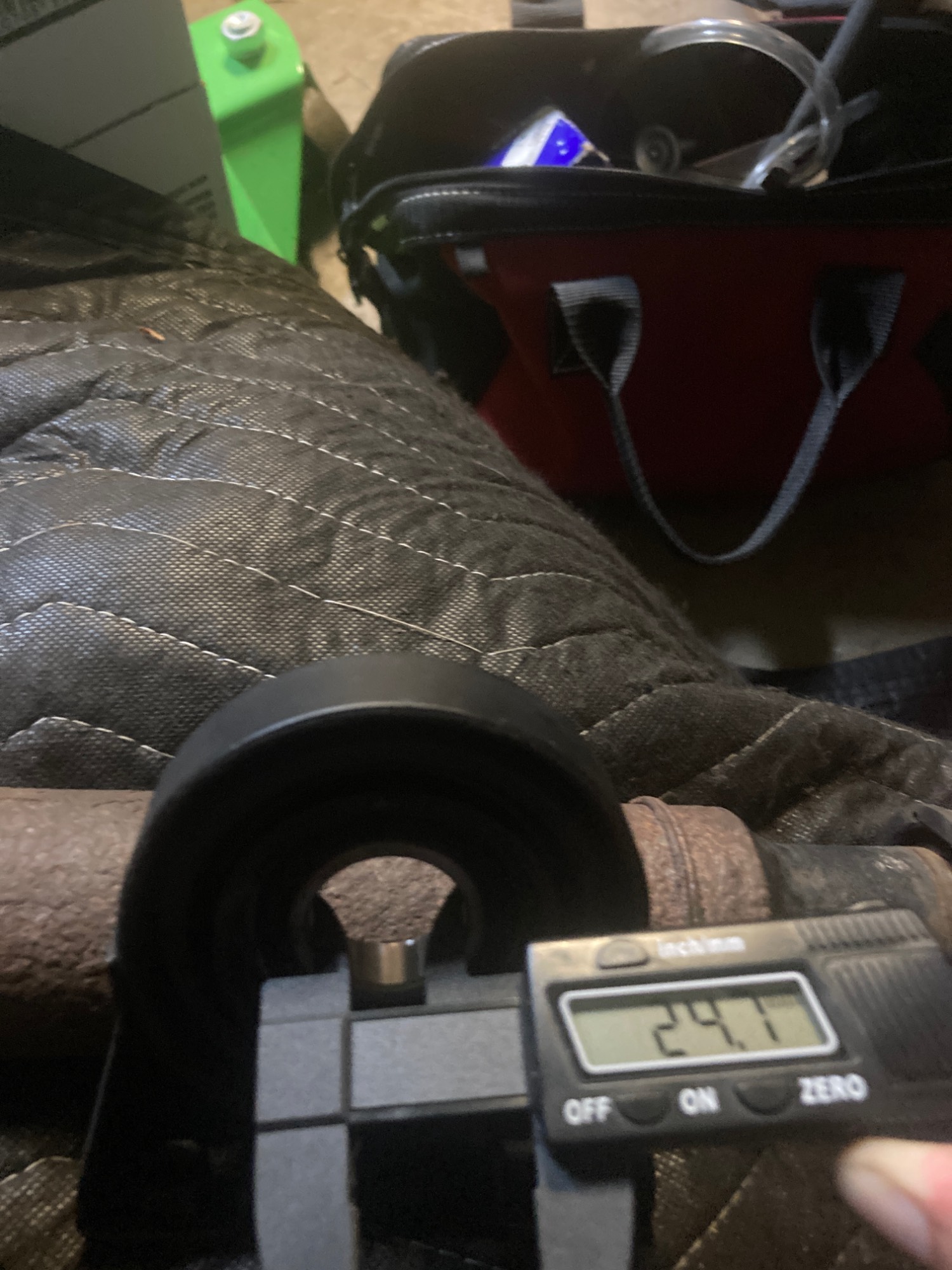

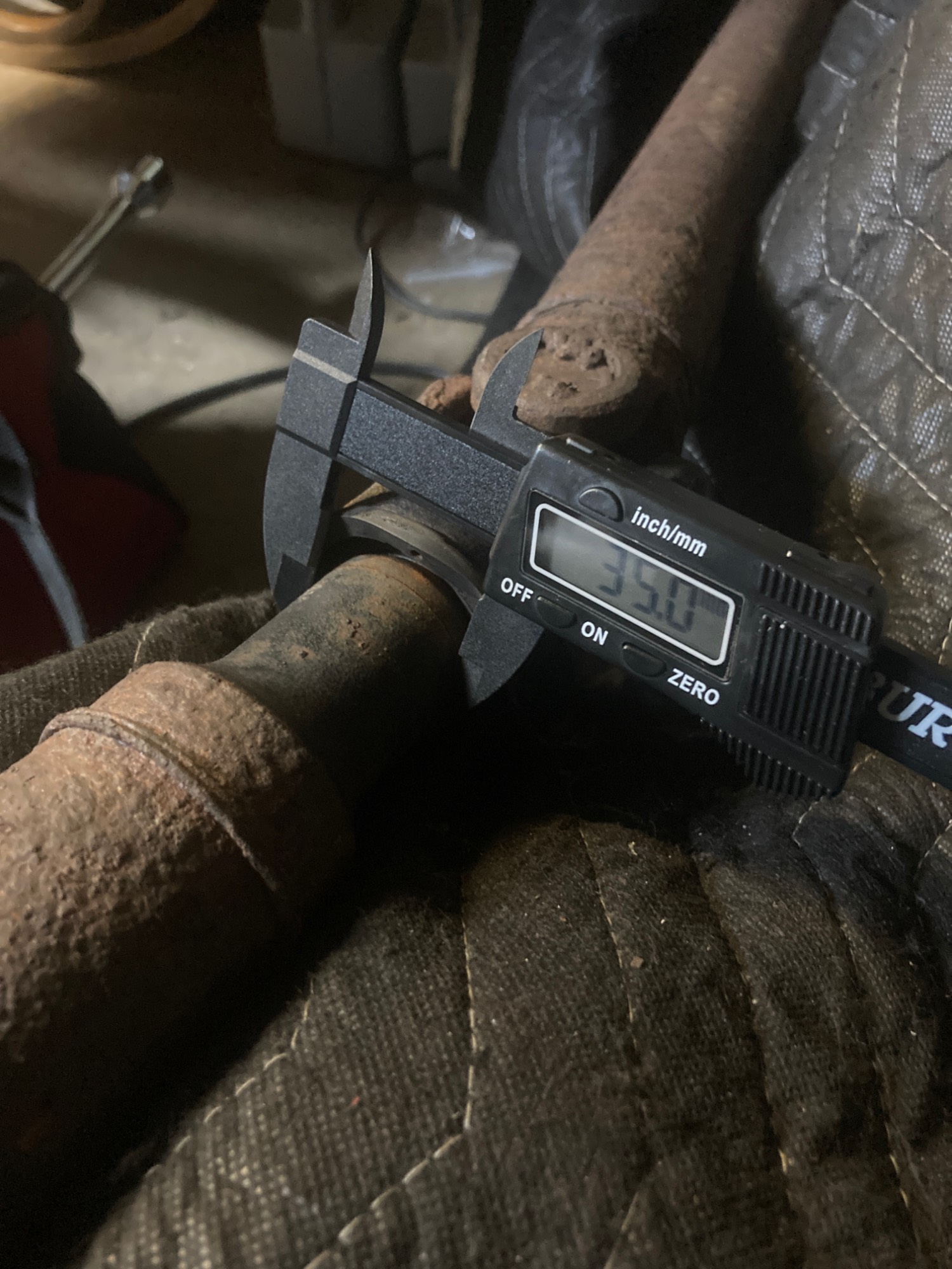

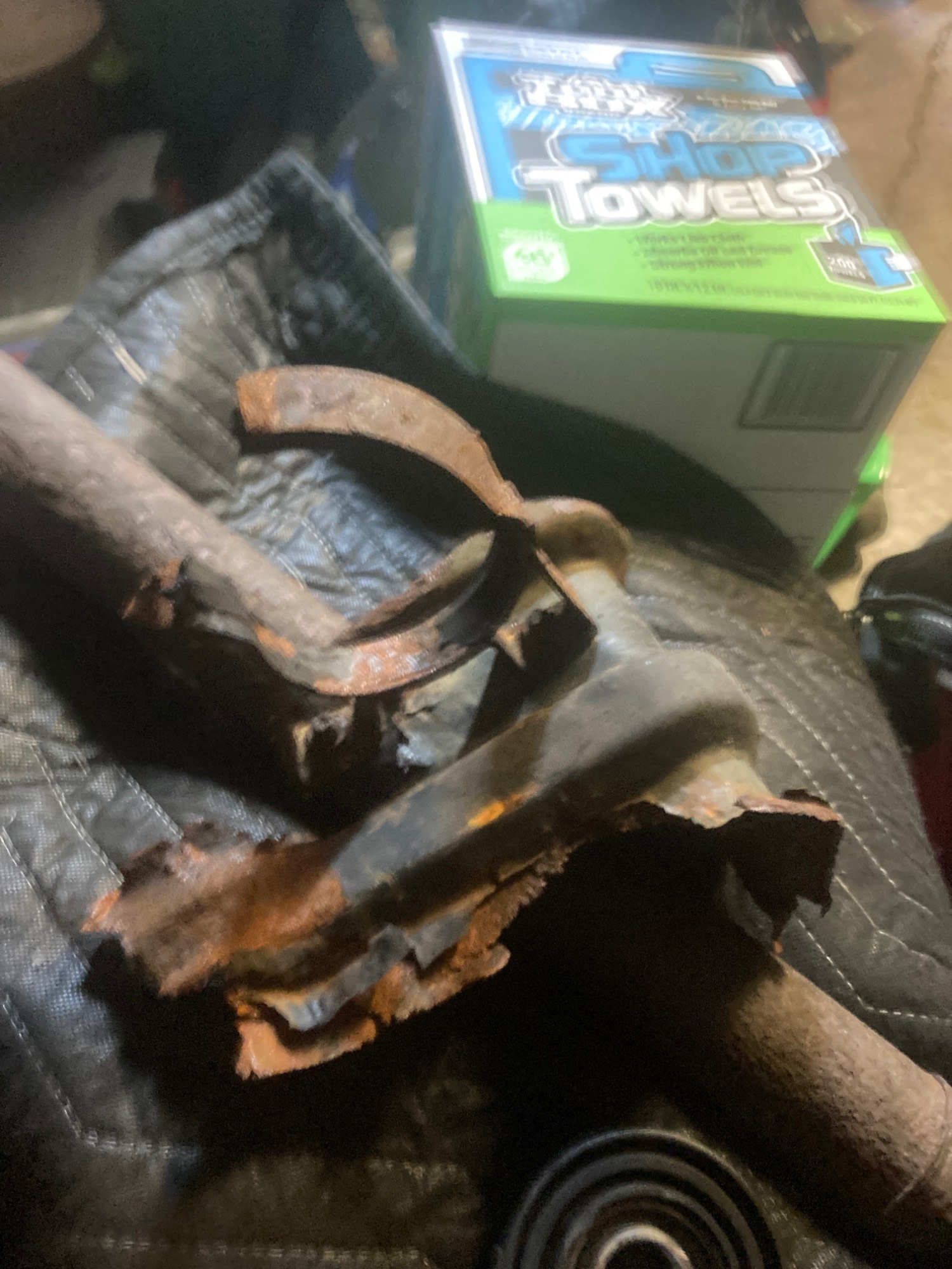

The driveshaft center support/carrier bearing and cross-member rusted out and I need to replace it. The driveshaft is otherwise OK.
I measured the diameter of the shaft that I have to press the new bearing on at about 35mm. The replacement bearings I find online, listed as fitting my vehicle down to its VIN, all have inside diameters of about 25mm.
Any idea on a part number or vendor for a support bearing that will fit my driveshaft? Any expert tips on separating the driveshaft from the U-Joint?

Do I need to pull these center bearing supports as that is the 2nd or 3rd that has been highlighted as rusted out.
There are 2 V70 XC's in PnP local to me, a 99 and a 00, as well as a 99? S70 AWD. I am fairly sure they all use the same support. Not sure if you can replace the center bearing yourself.

There is a chassis break for the center bearing support - I learned the old fashioned way by pulling one from my'00 XC - but when I needed one for the '98R there wasn't one to be found used, not even through Robert. He did find one in a salvage yard, several weeks after I needed mine. The one on my '00 was spotless, the one on the '98 fell in half when I pulled the bolts.scot850 wrote: ↑02 Sep 2022, 19:41 Do I need to pull these center bearing supports as that is the 2nd or 3rd that has been highlighted as rusted out.

Neil, the raw stamping may be the same - the one off the '00XC did bolt up to the '98 - but the placement of the center bearing was off, and not by a little. The chassis break for the floor extension may be where the driveshaft break occurs.scot850 wrote: ↑02 Sep 2022, 19:41 Do I need to pull these center bearing supports as that is the 2nd or 3rd that has been highlighted as rusted out.

Yes, 4 years of AWD production and 3 different drive shafts! I will do a Vida check on part numbers and compatibility so I know! I plan a trip there tomorrow to return a couple of parts and as it is the last day of 50% off all parts may take the opportunity to grab those just in case for others. I think there is a 99 and 00 V70XC and in the other yard a 99 S70 AWD.

I should have mentioned I had to get my R back on its hands and feet, so had already bought a new one from the dealer - and was stunned when it only took a few days to arrive in Annapolis. Picked it up on the way back from VA in DC, so it was sort of a 200 mile round trip.scot850 wrote: ↑04 Sep 2022, 10:22 Yes, 4 years of AWD production and 3 different drive shafts! I will do a Vida check on part numbers and compatibility so I know! I plan a trip there tomorrow to return a couple of parts and as it is the last day of 50% off all parts may take the opportunity to grab those just in case for others. I think there is a 99 and 00 V70XC and in the other yard a 99 S70 AWD.
Glad you found one though!
Putting a new center bearing on that driveshaft is an Heroic adventure. I would be tempted to just prop the old shaft it against the wall in the garage and motor on, fwd style. That's what I did with the green '00 70XC.
