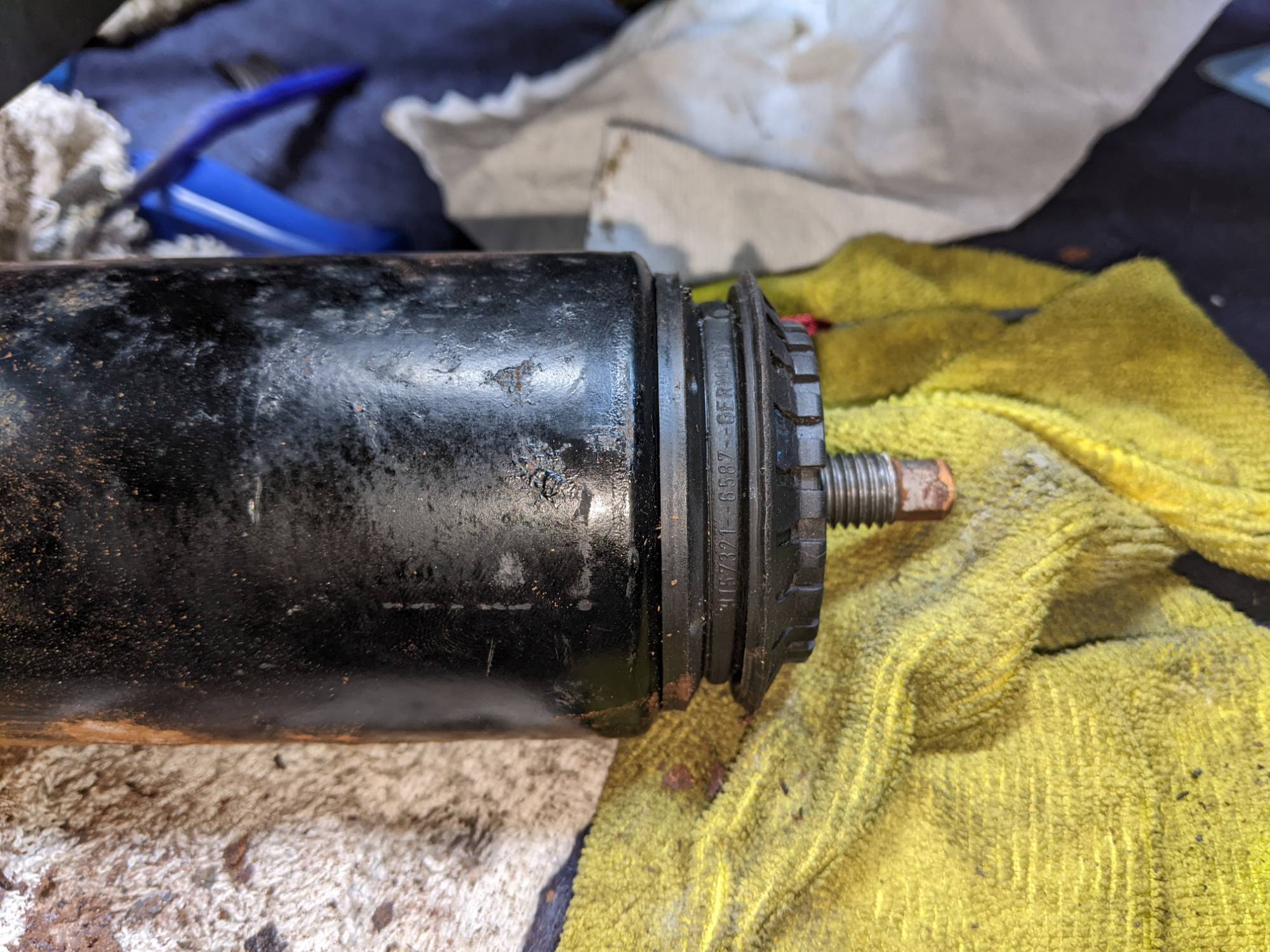

I pulled a set of Nivomats from the junkyard this week with the green stripe. I was cleaning them up readying for painting and then fitting new boots now I have some. What I have never seen before is the lower of the 2 rubber seats that sits on top of the shock, but under the top mount area is glued in place! As I have never owned 'new' Nivomats, can anyone confirm this is how they are supplied when new? Makes me think I should maybe glue the other one back on after painting?
Appreciate any wisdom on this!

Bump? No one ever fitted new Nivomats themselves and found the lower seat at the top glued in place?
Thanks,

I will check my spare nivomats that i bought 2 years ago.
But...i don't recall that they have those rubber seats on them.

That may be the case. Volvo sells them separately for a stupid amount each! I should clarify this is for an AWD P80 rear Nivomat:
There is a lower mount and an upper mount. Lower one is the one in my picture part # 9157321 and the upper one which mounts above the rear sub-frame part number: 9157320 which is now NLA. Thanks Volvo for half a job!
https://www.volvovancouverparts.ca/a/Vo ... 67242.html
The one that is still available is with tax around $100 CDN.
The one that is stuck to the top of my shock is really stuck there! I have not been able to remove it. Perhaps part of the install process was to glue it on first? I will now have to see if Vida has the info, but I think that the install was missing the last tieme I looked. Just like many others seem to be becoming now.
