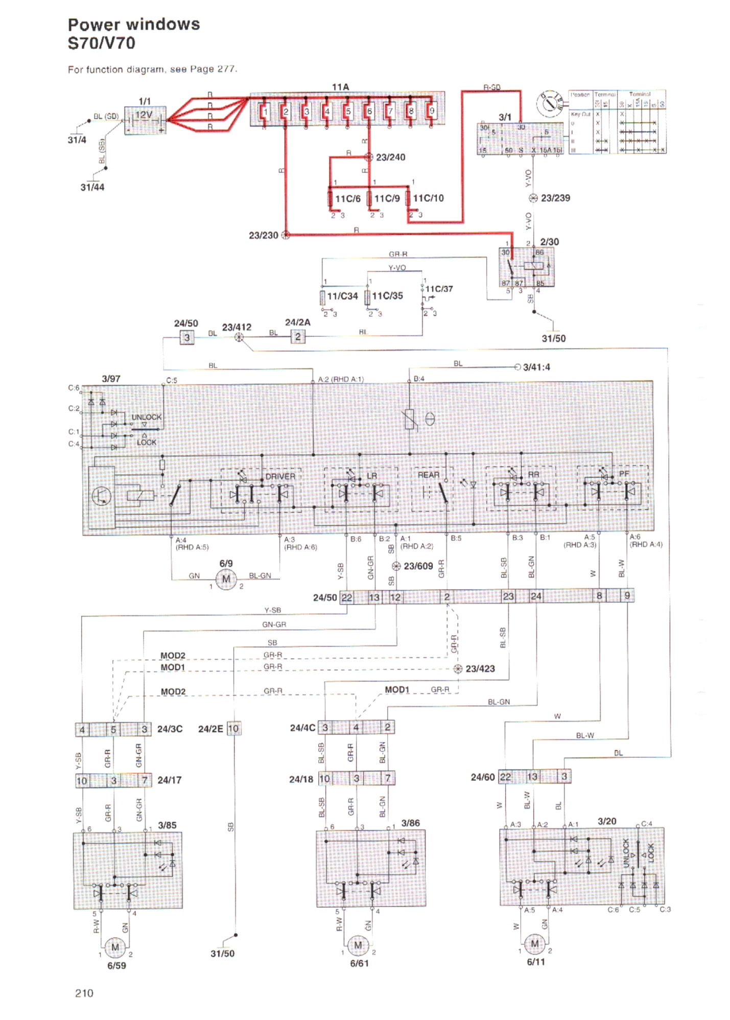

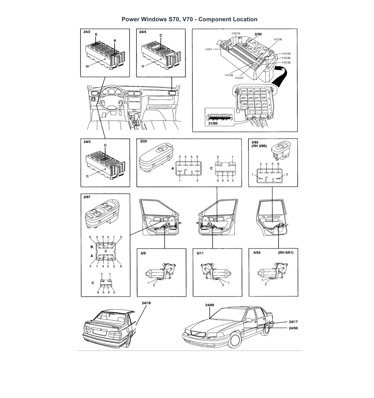

If you pop out the rear door window switch putting 12 volts onto Rw and green wires that go to pins 4,5 ( center two pins on the row of four spades) will direct connect to the motor
From VIDA
From VIDA

The motor is connected directly to the local switch.
Unplug the switch and you have two leads direct to
the window motor. Here’s the diagram.

Thanks guys, but you need to please dumb this down further for me as my brain cell absorbs the info!
SOOOO, if I disconnect the switch from the connector on the back, and hot wire pins 4 + 5 at the same time then I would be direct powering the motor. Assuming it is not the motor, then there is a chance to close the window.
So if I run a wire directly from the battery +ve side and bridge pins 4 + 5 that is all I need to do? From the diagrams you both have kindly added, as BJ says, there appears to be a direct power feed to pin #1. If that is correct to my understanding then jumping pin#1 to 4 + 5 should then close the door and the master switch should be out of the picture, is that correct?
As BJ says, if there is direct power to the rear switch, then the master switch should have no effect on operation assuming the override switch in not in the OFF position. Power must then go directly to the master switch or otherwise how does the OFF switch control the rear window switch on the rear door to prevent it opening?
I did try to see if switching the OFF/ON control made any difference and it did not. If that control wire is a broken wire then depending how it works would that kill power to the rear?

You are going to ..
Pop up the window switch from the door
Pull the connector off the switch so it is loose from the switch, completely.
Now look at the fine print and find the number 4 and 5 terminals in the connector. It will be the middle two in the row of four, but confirm.
Then confirm again that the wires to these are one Red white, one green
YOur battery will connect direct to these two terminals, pos to one, negative to the other, The motor will run one direction, and you reverse the pos and neg to turn it in the other directiion.

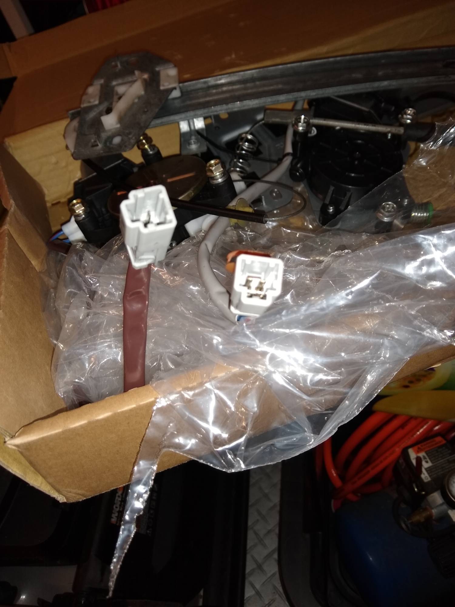

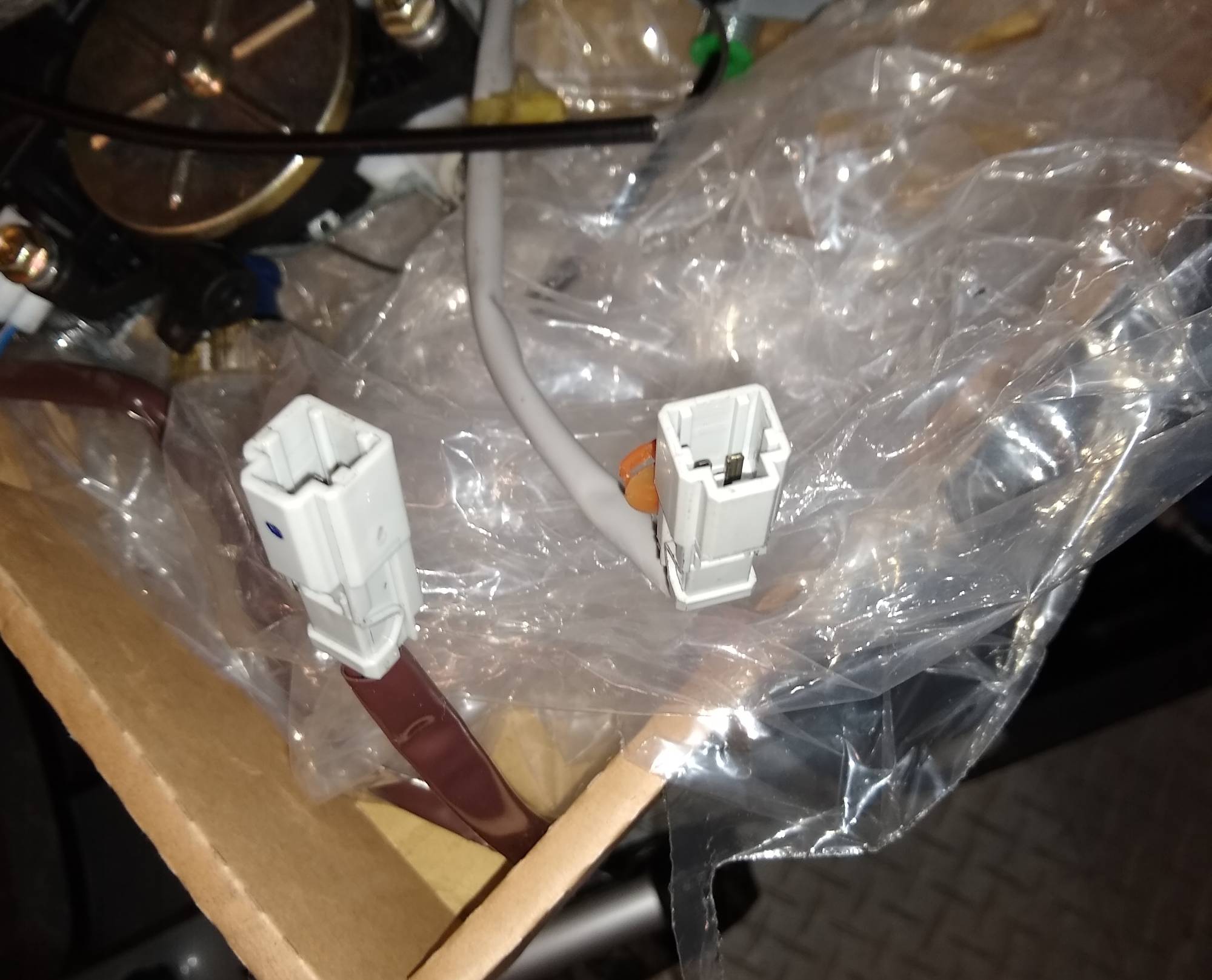

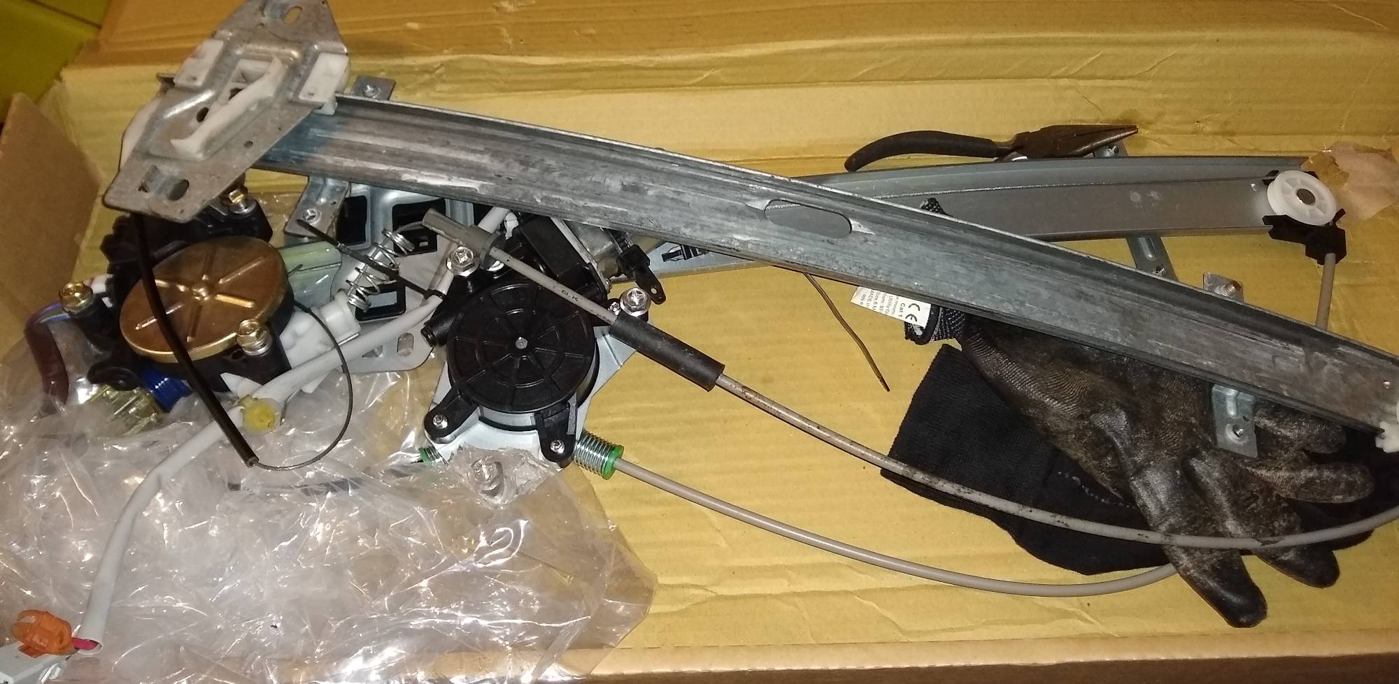

A crude video but if all window regulators have just 2 pins from the motor... Trying to find time to replace the 03 Odyssey passenger regulator.scot850 wrote: 15 Sep 2022, 20:23 I went to see a S70 yesterday and while there found that one of the rear windows was stuck open.
