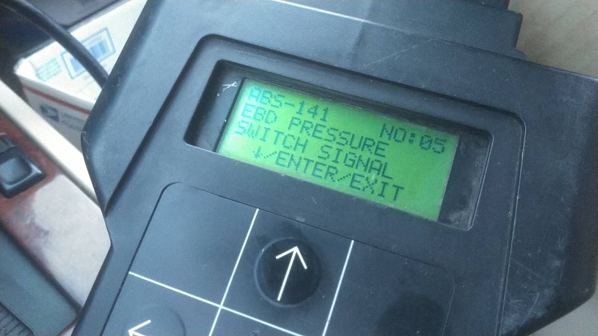

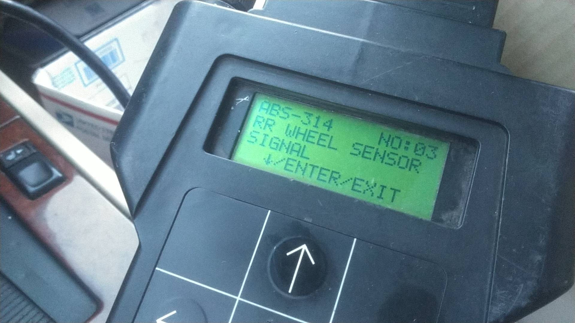

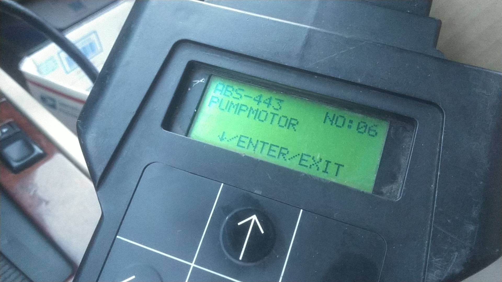

I need a little bit of help or guidance here with this 1996 turbo Volvo 850. I've replaced the ABS module, I'm on the third module. The first module I didn't even have speedometer or odometer, the second and third module I do have the speedometer but not an odometer. All three modules I have the tracks light lit, the ABS light bulb is burned out so I'm not sure if that's on or not. I've scanned it with my VST and I have the following error messages (see pictures below) and I was wondering if these rear sensors could cause the odometer not to count because it's not counting internally, even though the gear is likely broken it should still count internally. Do you guys think this pump error code could be keeping my tracks light on or these rear ABS sensors maybe being damaged would cause this vehicle to lose tracks and not count mileage?

I never trust the text code descriptions on scanners if it isn’t Volvo software. I don’t think rear wheel sensor play into VSS.

You can measure the ohm ratings for the sensors. Midwest ABS has the ohm ratings listed on his website, I think.
The reluctor rings can do weird things if dirty or broken.
I think that that the pump can cause a Tracs light. At least on the earlier years. My 95 had the light on occasionally and sometimes the pump would do weird sounds then.
