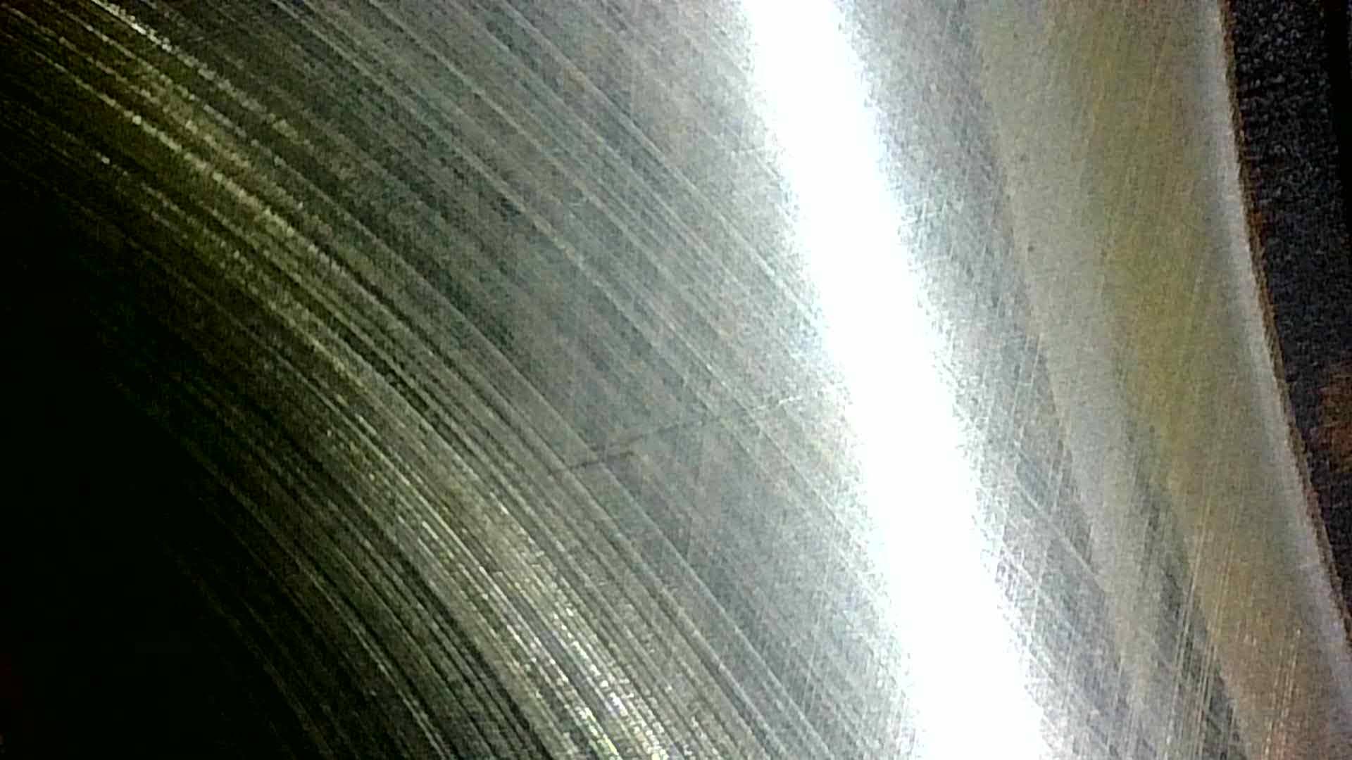

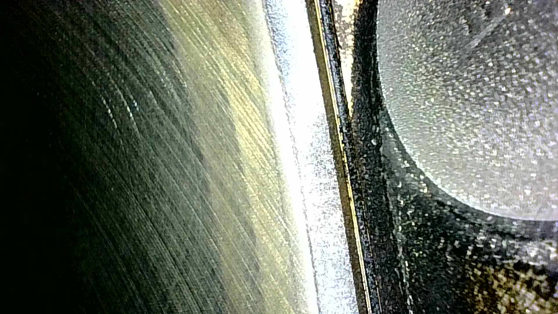

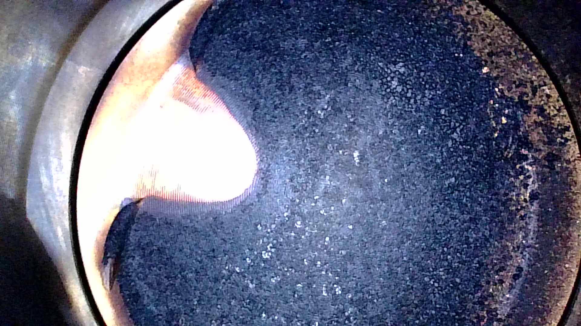

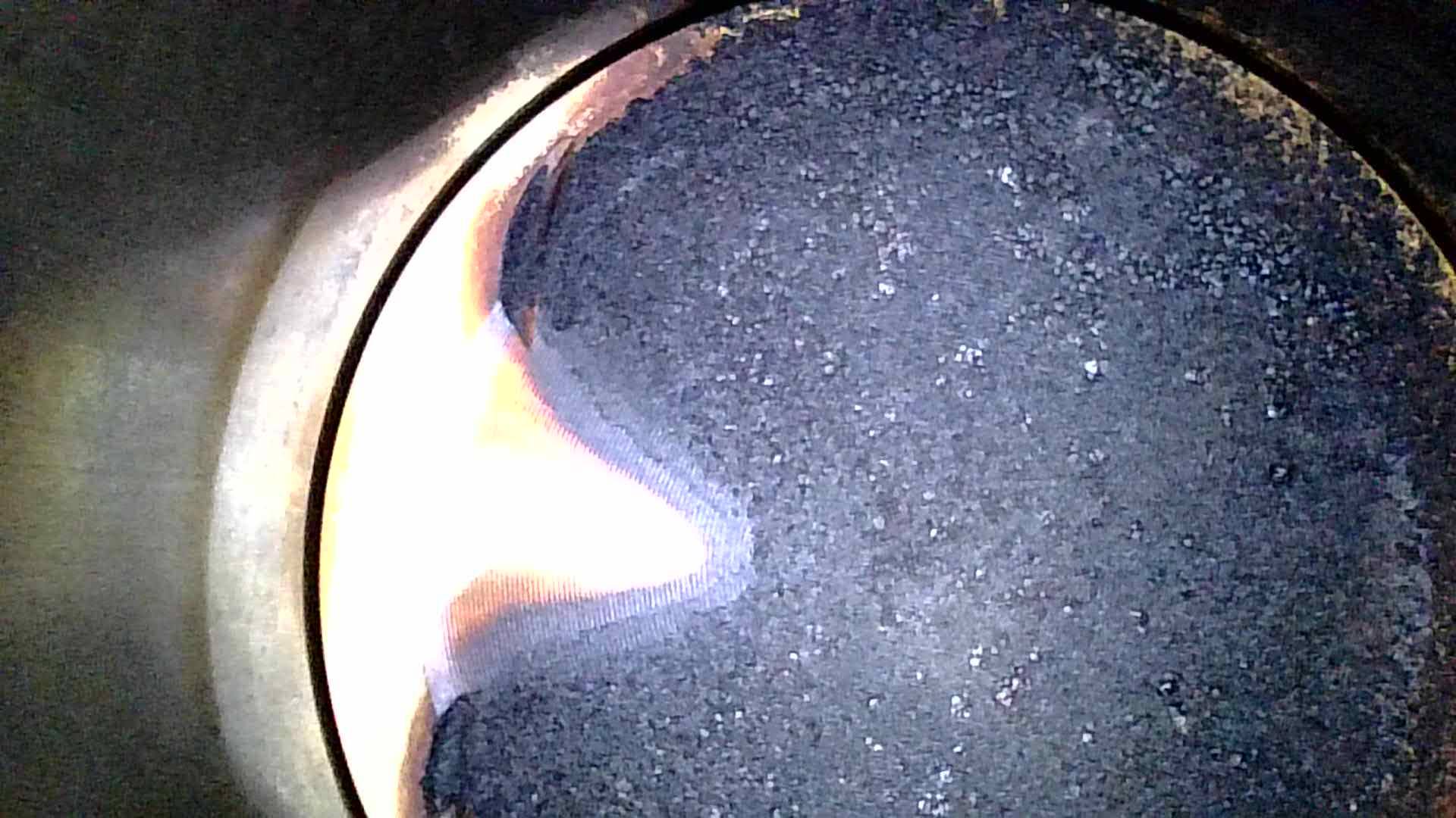

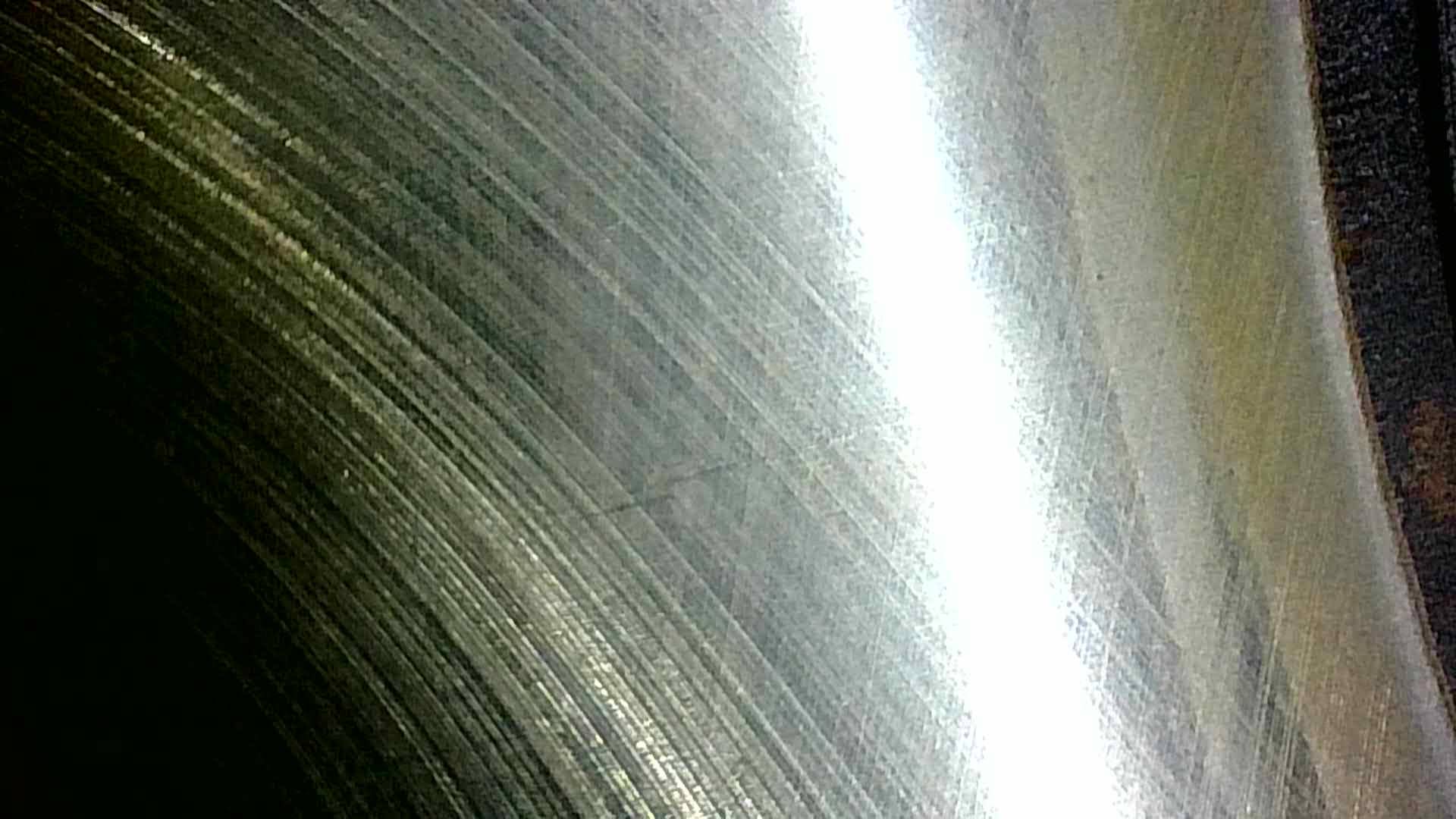

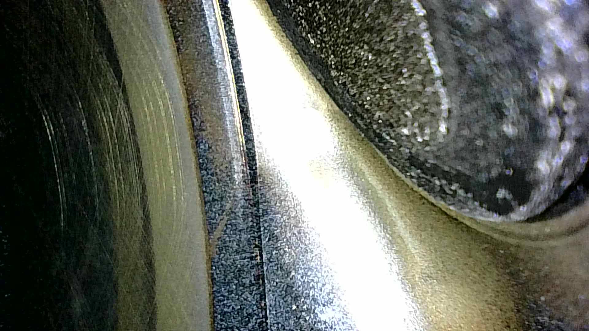

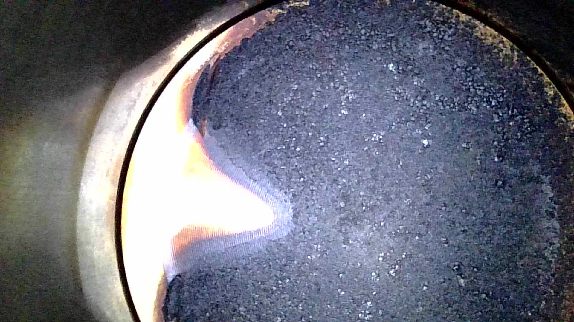

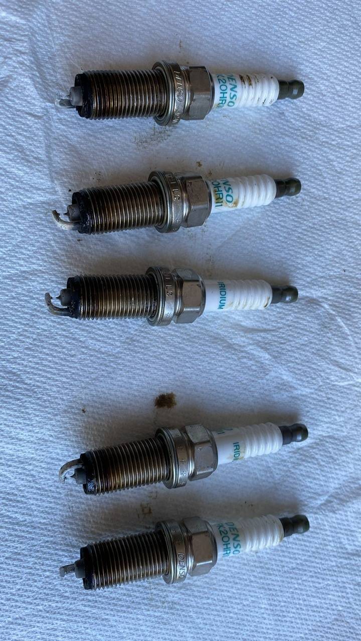

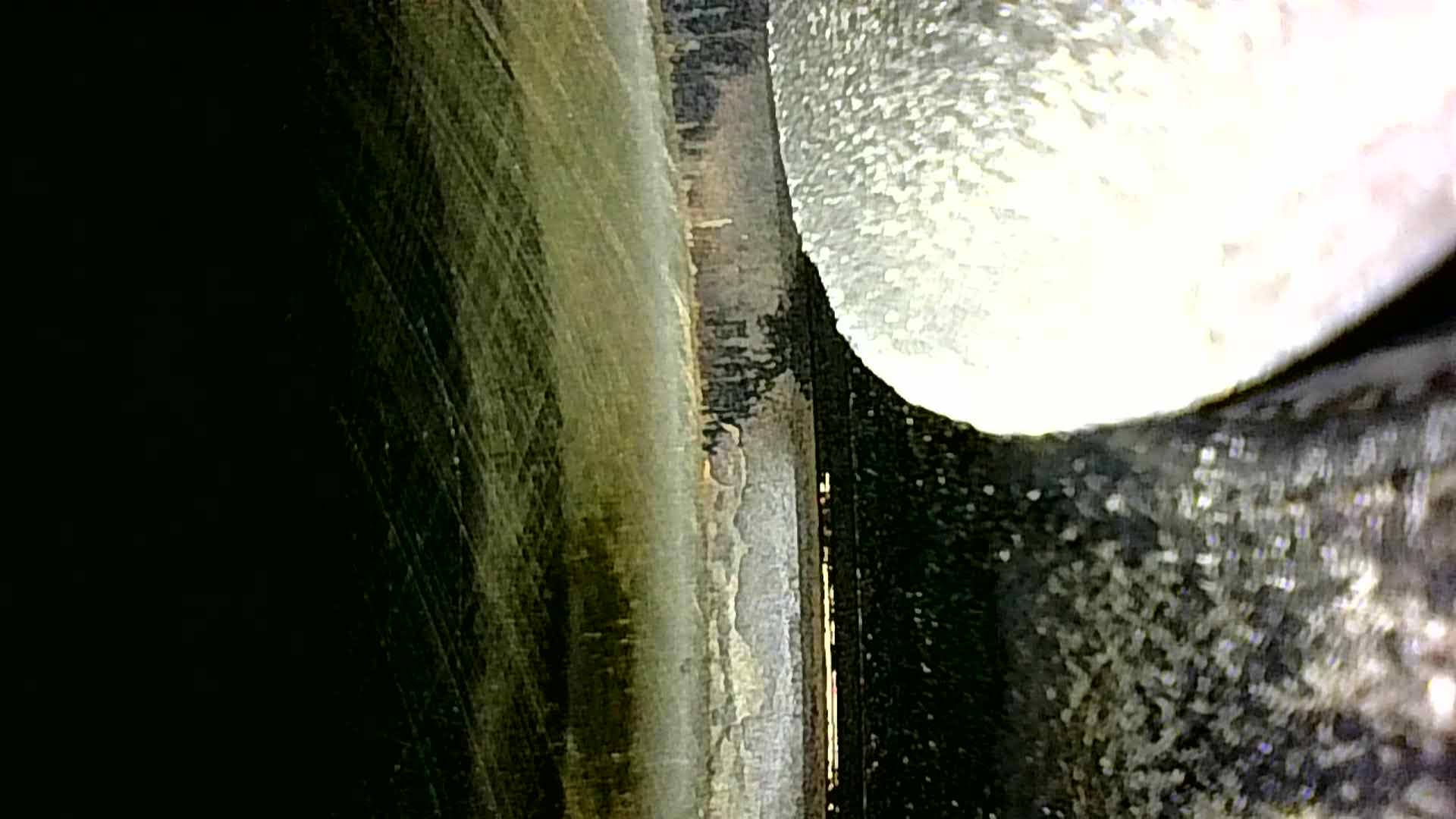

After driving the car for about 700 mile it was almost low on oil and I decided to pull the spark plugs and found out that they where completely oil soaked. I checked the cylinder sleeves, pistons and valves with a boroscopic camera and they where completely carboned up and wet from engine oil. The good news was the cylinder sleeves looked okay with the cross hatching still visable.
I was stumped how this could happen but most likely the car was not serviced with the recommended ACEA A5/B5 oil, oil change sticker from a large change store gave away the clue. FYI there a sticker on the radiator core support with the correct oil spec.

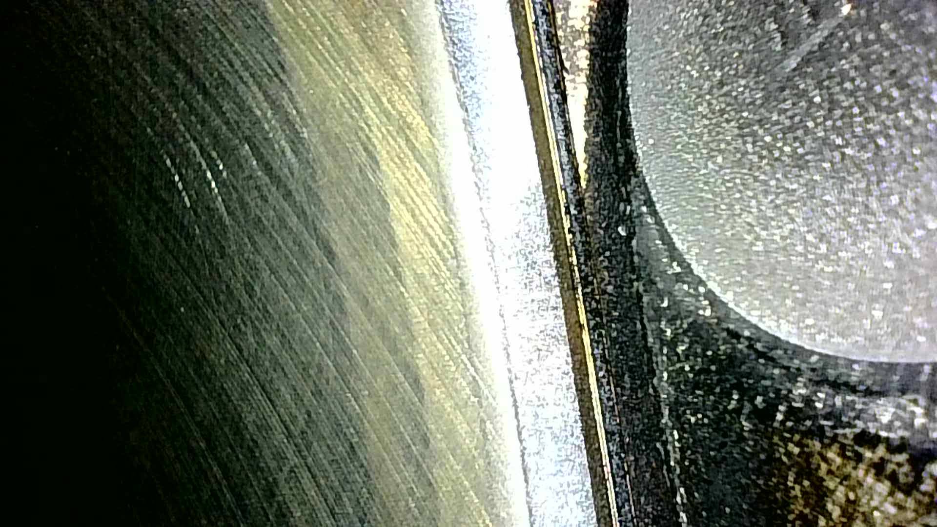

With nothing to loose we ordered ATS 505CRF & 505CRO engine cleaning kit. I wish a made some before pictures but I do have the after treatment pictures. After the treatment I replaced the spark plugs (wrong type where installed) & oil change with the correct oil and was pleasantly surprised, No oil on the spark plugs, no wetness on the pistons and large portion of the carbon removed from the pistons and circular grooves of the pistons are mostly visable again. Also the carbon is mostly gone around the piston edges. Oil consumption is now down to about 1 liter per 5000 miles. We are going to do a second treatment before the next oil change to see if it further improves.
