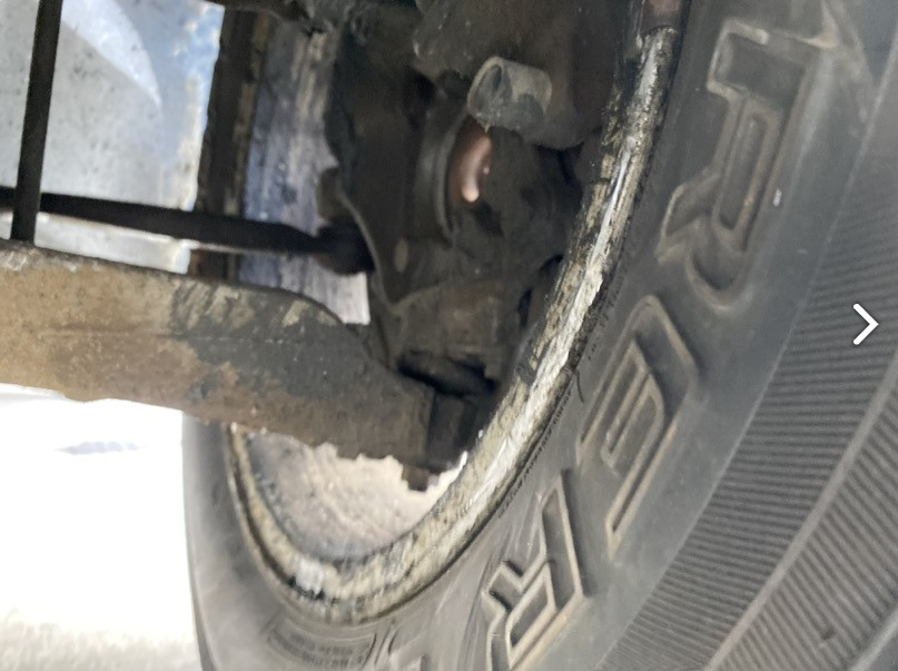

There's also a 2006 XC70 Cross Country. It has about 102K miles, It's got a missing driver's side CV shaft and "vehicle shutters at time while driving because of it". I would think the CV shaft wouldn't be a big deal to replace, but I have my doubts about that being the cause of a shudder. The AWD sure would be nice this winter.

Oh, I thought the P2 system was better than the P80 awd system. I did talk to the man that evaluates the cars for the auction house, and his impression was that the shudder was caused by the CV shaft missing, since it can't transfer power the way it was designed. Could that be a pump issue? What does the pump actually do?erikv11 wrote: 18 Oct 2022, 11:01 My experience with the P2 used car market is that most of them do not have functioning AWD. Haldex pump is usually bad, less commonly it is a bigger issue like with angle gear.

P2 AWD is definitely better than P80, and 06-07 is the best of the P2.
The pump is at the rear to recirculate/filter the oil in the Haldex unit and when it goes out the AWD shuts down. Not likely related to a shudder especially one up front. The good news is it is not too hard to fix (but in the rust belt watch out ...) and then the AWD hums along again. There are some other Haldex issues that come up, too. All require the same effort to fix: Drop the prop shaft (not trivial), disassemble at the Haldex, reassemble, refill the Haldex oil, re-install drive shaft.
We may have a terminology issue here, the CV shaft can't be missing/absent on a P2, is it the "prop shaft" i.e. the rear drive shaft that is missing? Or what do you mean by "missing?"

This is an auction car.... ANYTHING can be missingerikv11 wrote: 18 Oct 2022, 13:59 We may have a terminology issue here, the CV shaft can't be missing/absent on a P2, is it the "prop shaft" i.e. the rear drive shaft that is missing? Or what do you mean by "missing?"

Wow! I've never seen that! It's got low miles right? Don't know why they'd remove that CV shaft and continue to drive it, definitely where the shudder is coming from but the bigger question is: why did the remove it and not put another shaft in?

I don’t think you can remove a single axle shaft and drive the car. Wont the front diff just spin?
