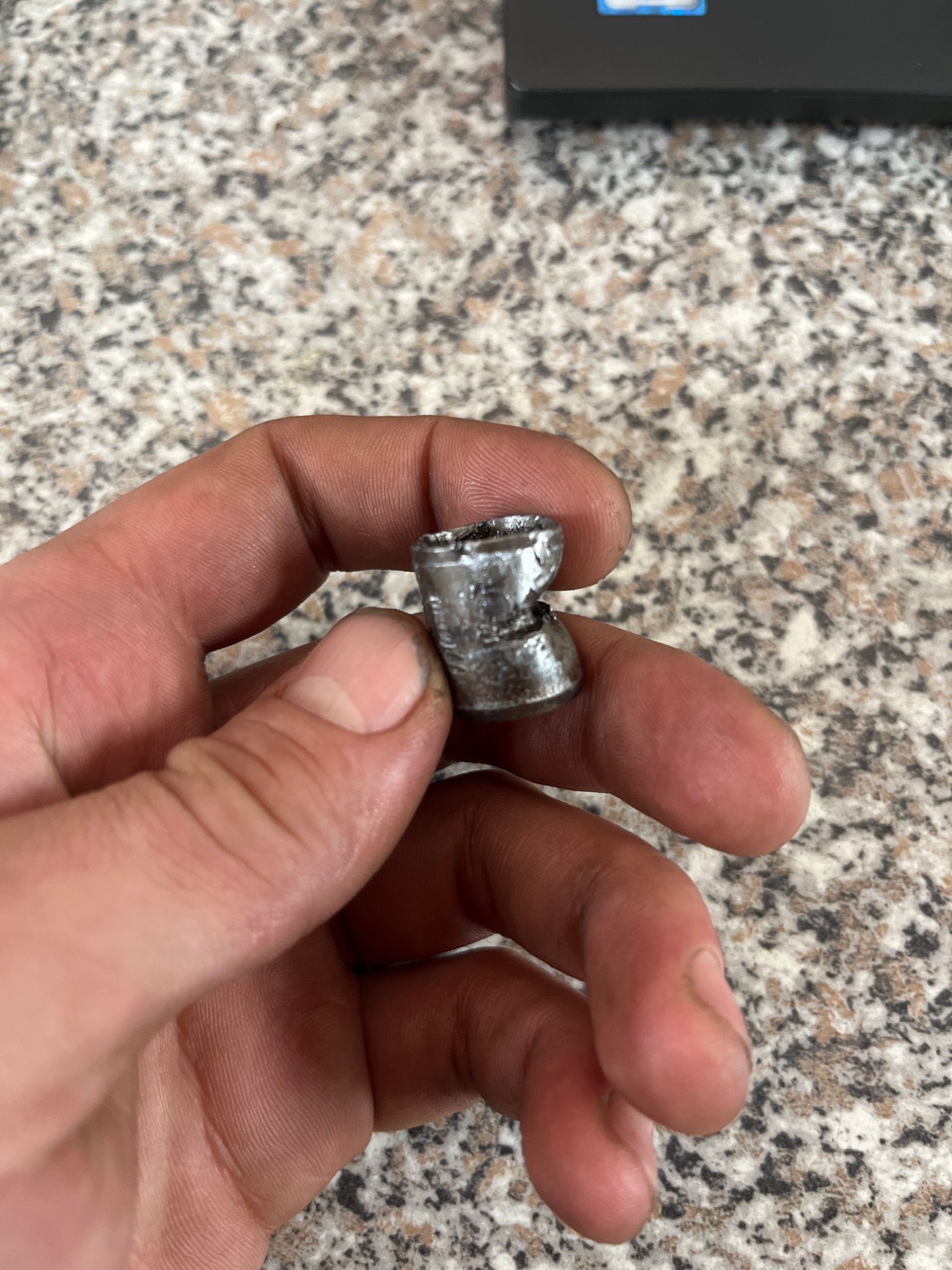

I removed the transmission and saw the clutch release bearing doing this. (Attached video)
This might be the issue.
The centering pin (don’t know how it’s called) was damaged when the former owner repaired the transmission himself which caused the transmission to not be aligned to the engine properly. (Picture)
IMG_0593.MOV
Release Bearing
(18.89 MiB) Downloaded 52 times
Centering thingy
Centering thingy
