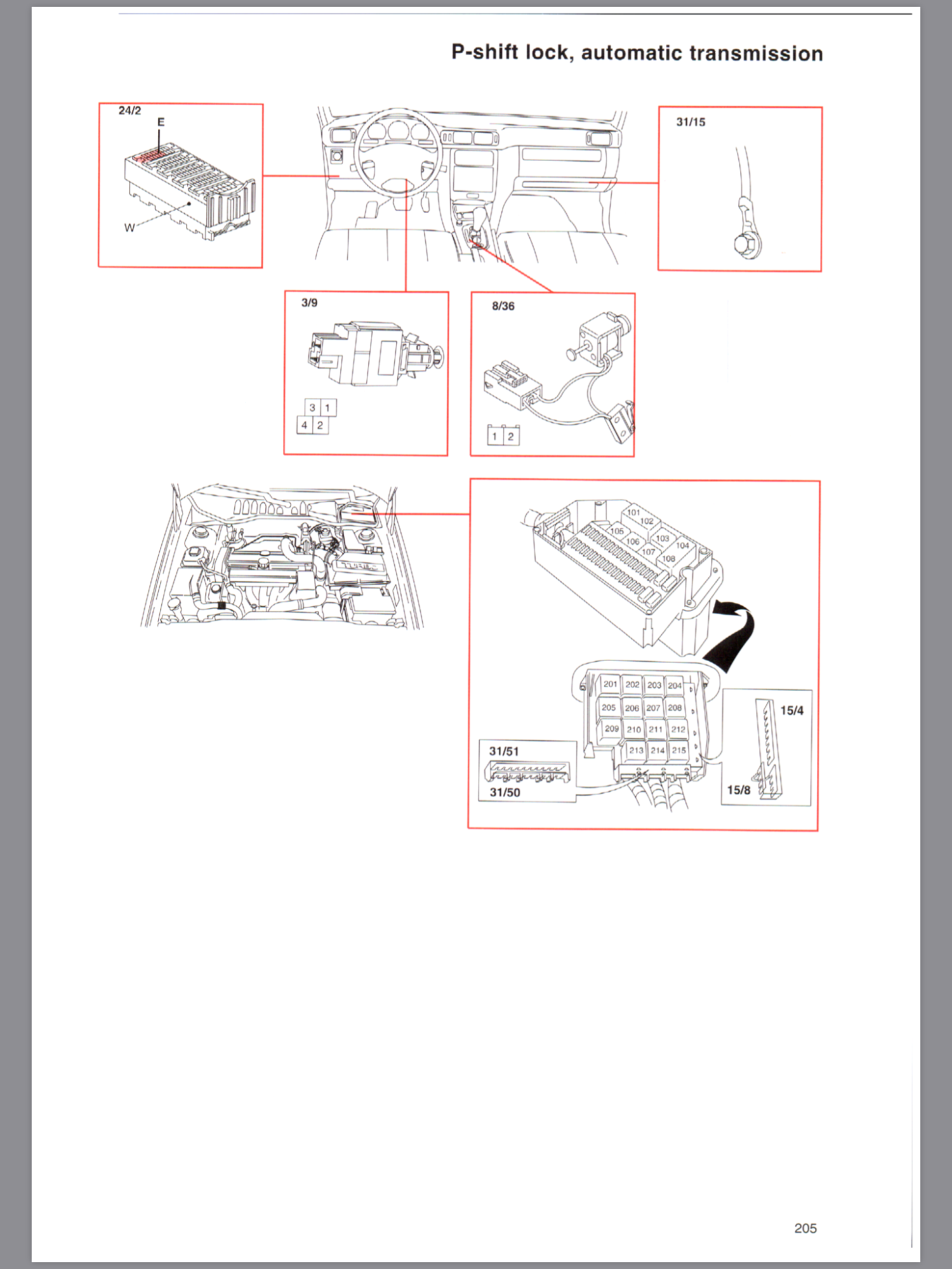

Or maybe it’s just a simple circuit with two switches and a solenoid that unlocks the shifter.
With the key in the run position, power is available at a set of auxiliary N/O contacts in the brake light switch.
Next stop is a microswitch in the shifter that is closed when the shifter is in the parked position.
The solenoid is energized when the brake pedal is depressed, releasing the shifter from park.
The cable from the shifter allows the key to be removed from the ignition only
when the shifter is in park. If you can remove the key in any other position,
something is wrong.
I would suggest obtaining wiring diagrams to assist in
understanding and troubleshooting issues of this nature.
Search TP 3932202 for US Model Year 1998 diagrams.
something is wrong.

Not sure what that diagram with the items marked 201 to 215 are or where it is or if it is on my car. Never saw that anywhere on this car could it be hiding? What are those blocks 201 to 215 are they more relays?
I guess the main question is why would this happen at the same time that the car stalled out and would not start back up right away.
I also have to wonder why it would be necessary to keep the key locked into the ignition what would be the purpose of that.
