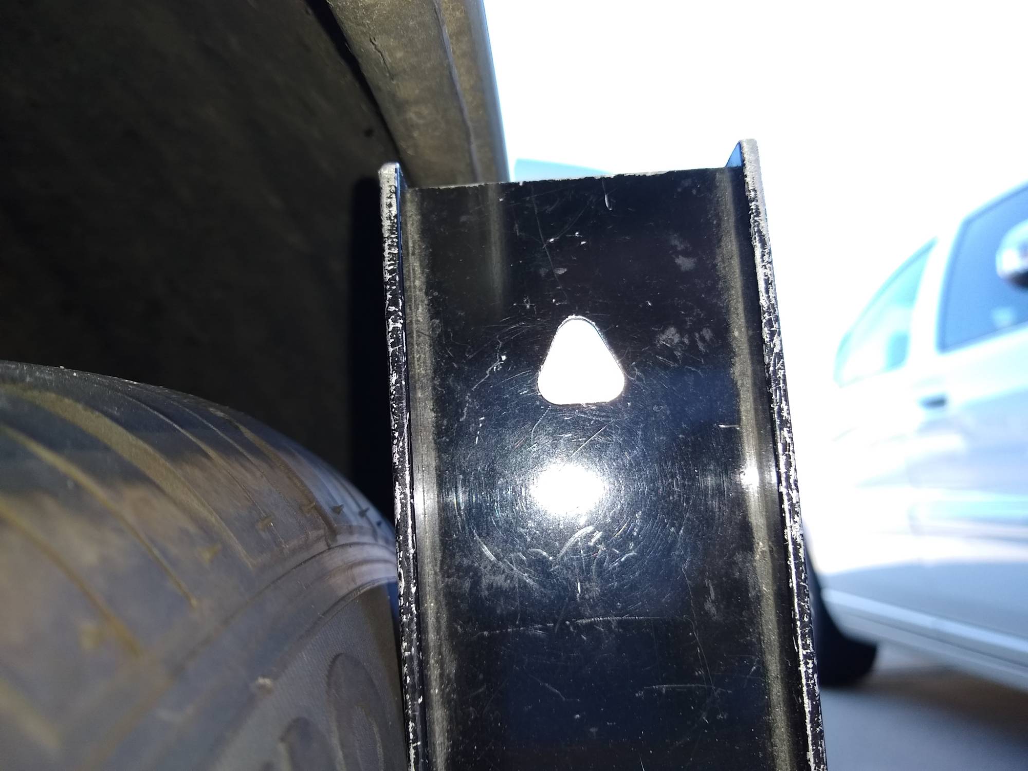

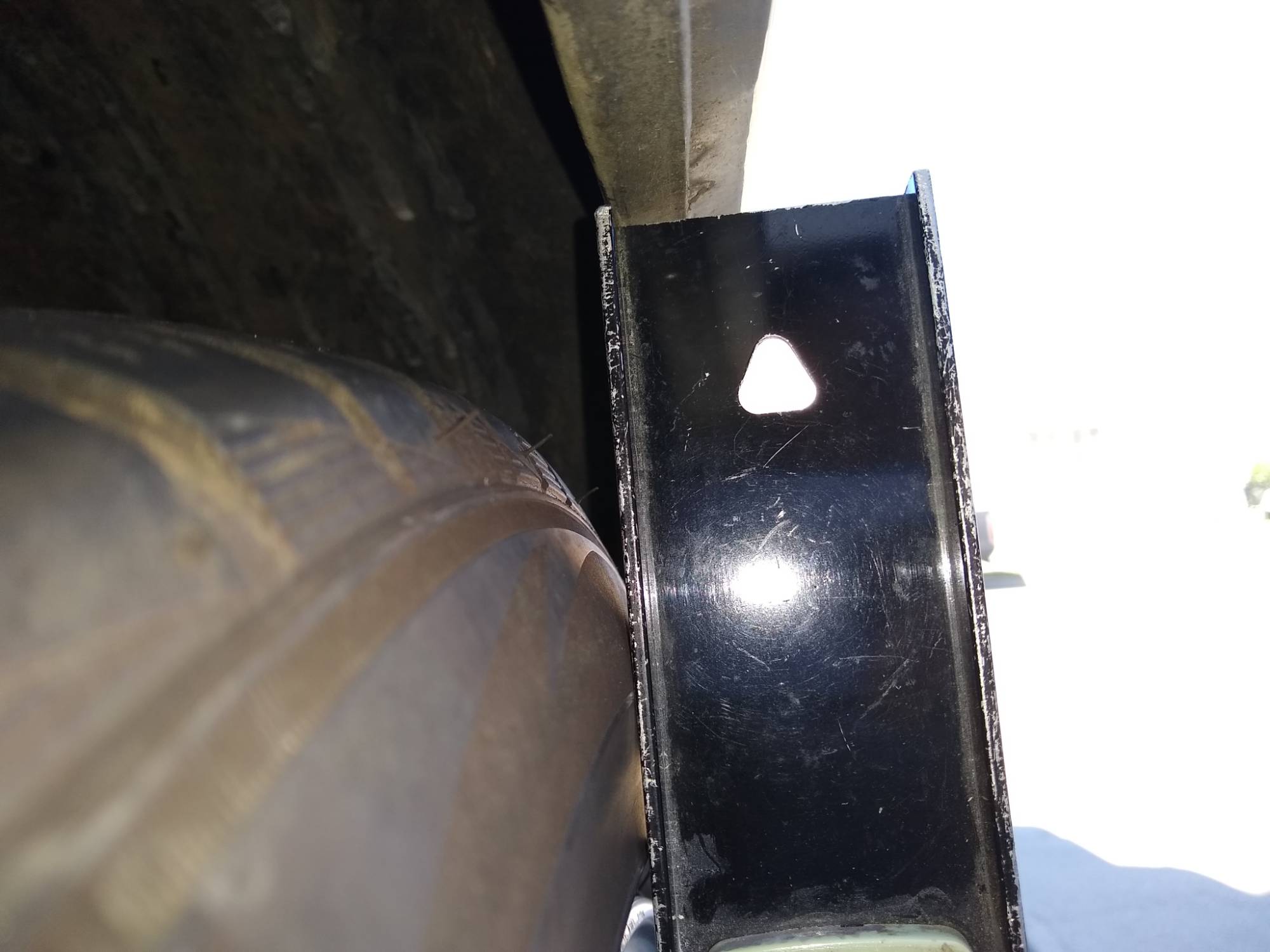

Not sure about what your wheels looks like. If the offset is the same on the wheels then we could potentially have the same spec setup though mine has 10mm spacers in the back.
viewtopic.php?p=612983#p612983

I mentioned that I would consider getting 5mm spacers in the front and 15mm for the back if an opportunity afforded the exercise. After doing a little check today I'm not going to consider it. The 205/55/16 with those rims and 10mm in the back is close enough. Use the side walls and a level. It's actually a little straighter as the side wall on the bottom protrudes a little more when making contact with the ground.
