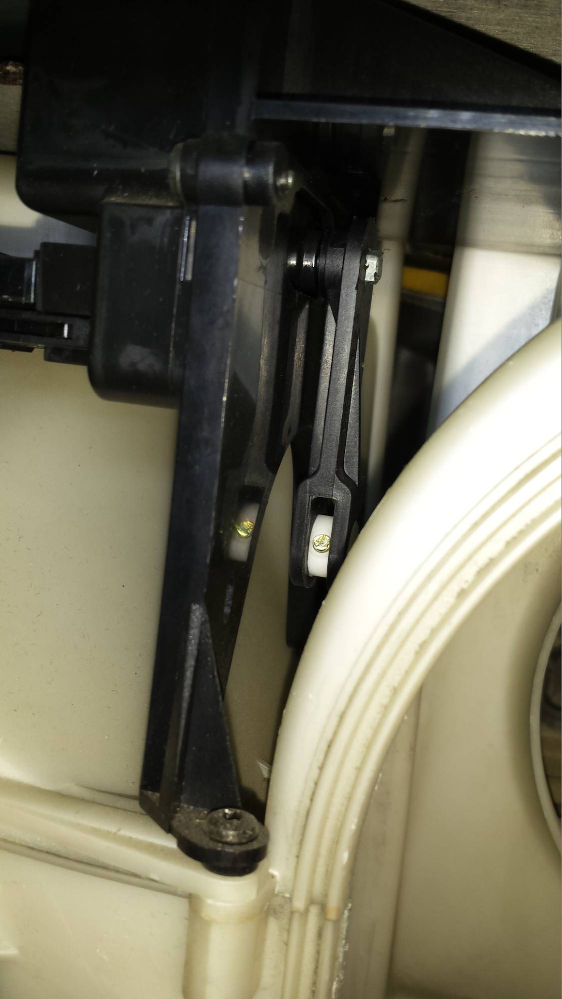

So I found that the servo arm was disconnected at the servo. I could operate the vent arm by hand and it seemed fine in both directions. The servo also seemed to move fine in both directions until I reconnected the arm.
It closes the vent to recirculate setting fine but when setting to fresh air it takes a really long time and seems to stutter. I’ve attached a quick video I made.
Does this mean the servo is bad? If so, how in the world do I get the old one out and where in the world do I find a new one.

Mine doesn't hesitate when it swings back towards the firewall. I did notice that blower speed selection does effect how far it moves.
Unfortunately, when I select recirculate while on the highway, the pressure forces air through the flap and it whistles. I don't think it closes all the way to begin with. Maybe it needs to be adjusted electrically? I just live with it. I don't use recirculate that often any way.
