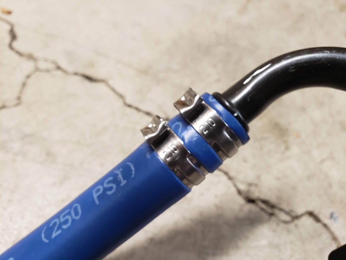

Which is the basic clamp for what we do here? And you've also mentioned a pliers that go in straight or at 90º. Can you recommend a good one? My immediate task/need is the oiler cooler lines on the 850, per this member's fine write-up.

I have managed to collect few tools over the years for oetiker clamps. I have a pair of Knipex with the front and side crimp. That has come in handy over the years in tight spaces!!
I have to laugh at the description though!
I prefer to use what the manufacturer uses but have had to succumb to using a good quality pipe clamp on occasion as Volvo have had the wrong part listed for the job being done!

I have that front side Knipex tool and it is really a good one for my favourite clamps.
Standard oetikers from Belmetrics should be fine for those oil lines. 250 psi is nothing.

Hmm my pliers have a sort of “stop” to so that when clamps are tightened the ear stops rising up. Those pliers just look like a pair of hoof pliers? I'm not sure that’s the correct english word for it. It’s probably enough to just use a pair of wirecutters though.

OK, I’m seeing Knipex and Belmetrics in older posts on this. Belmetrics is a clamp source as well? It seems you can buy directly from Oetiker?

I've got some large nipper style cutters, from Harbor Freight, that I used when doing nylon fuel lines. They worked well, but I did have to be careful not to cut through the small clamps.
I think this is what I have: https://www.harborfreight.com/10-inch-h ... 38496.html
They're cheap, but quite handy. I've used them to cut wire fencing when building compost "bins" for yard waste, and for trimming up nylon zip ties.
If I start buying Oetiker clamps, I think I'll buy something specifically for them. That probably won't be until I have to do a PCV system, Though.

The correct tool also flattens the top of the crimp to make it sit flatter. I believe this also makes the grip stronger.
