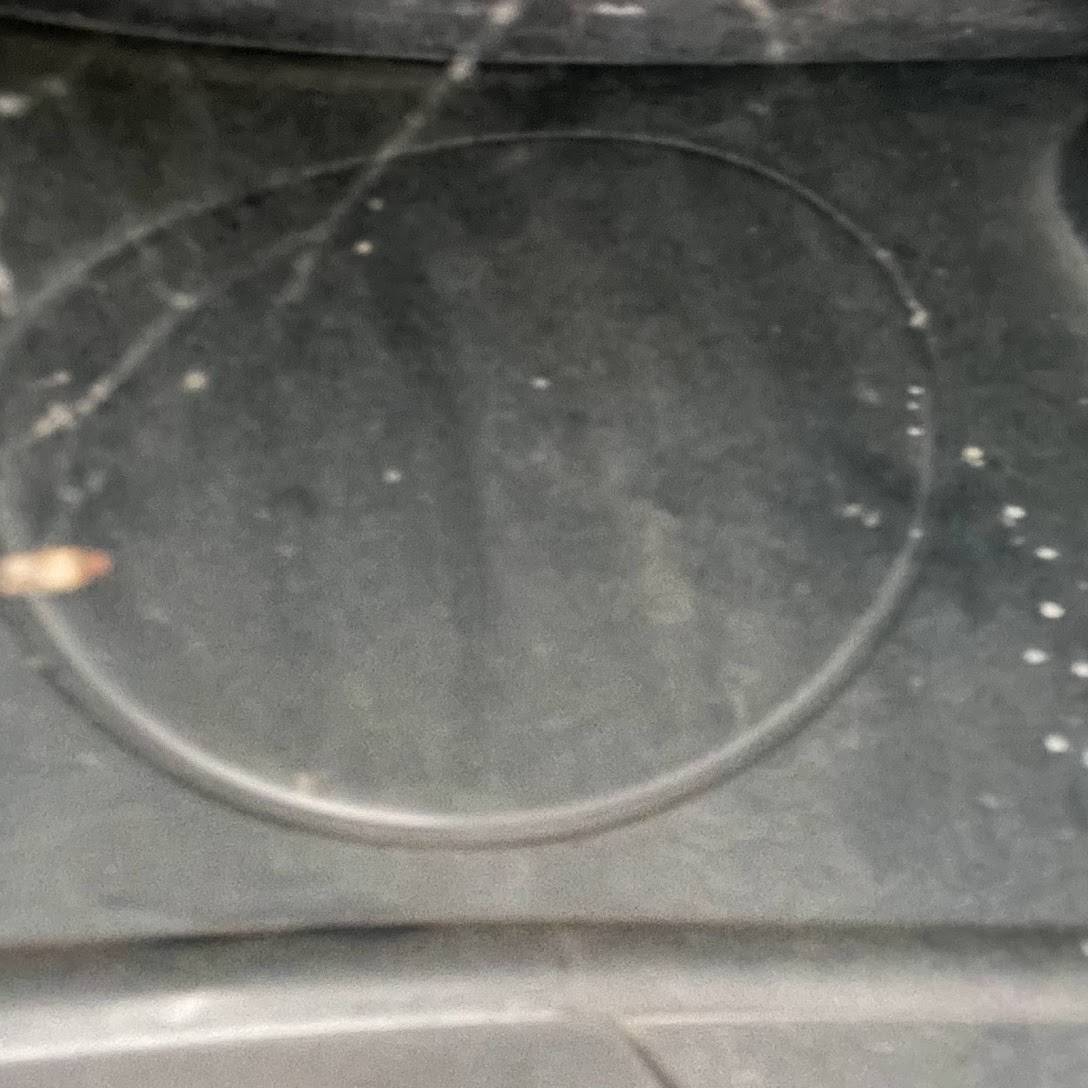

Hi all,
For those unaware, 850s without factory fog lights have the outlines for the fog light holes on the inside of the bumper/valance so you can cut them out and install trim rings to add fog lights. I intend to do just that, but I'm wondering if anyone who has done the job before can comment on what they used to cut the holes and if they have any tips.
Going in blind, my plan was to use a hole saw to get as close as possible to the OD of the fog light cutouts, then use a Dremel with a 561 bit to get up to the edges. But if anyone else has done the job and knows of an easier/better way, I'm curious to hear it!

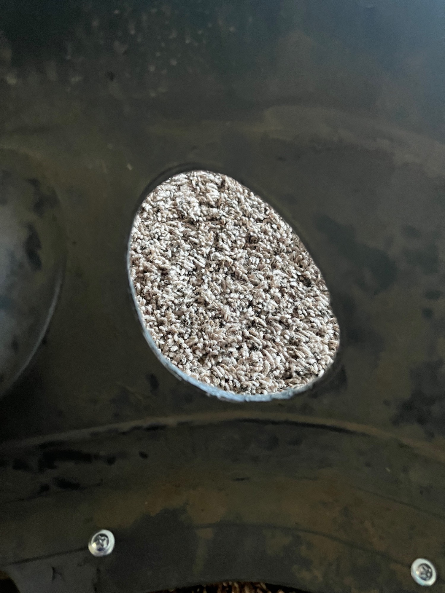

Just to close the loop on this, I ended up doing the job with a simple utility knife. The key is to use high quality blades and make many small cuts around the perimeter, going deeper and deeper each time. When you’re done, just hit the perimeter with some sandpaper to smooth out the cuts. It probably took me about 45 minutes to do both sides.

Shoot, I missed this. I did this about two years ago. It was a pain. I put blue painters tape over the exterior of the corners, and from the inside I used a cordless soldering iron and poked through the ring outlines from along the inner of the two, I believe. I then finished it with a cheap cordless “dremel” from Harbor Freight, combination of sand drums and stones.
I found it to be way harder than it’s worth; unlike the fogs the V and S series came with, these round ones are so dim you can barely notice them when they are on. I would not put myself through the trouble a second time.
