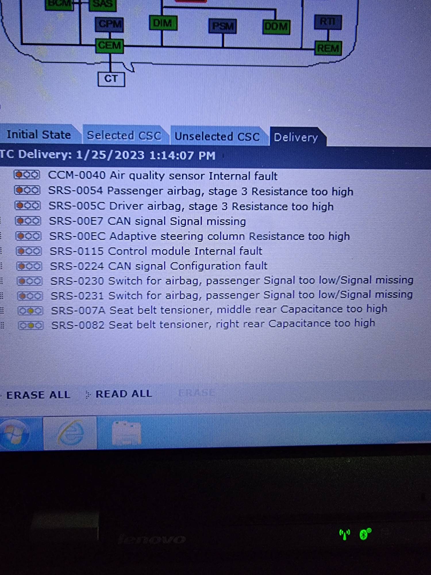

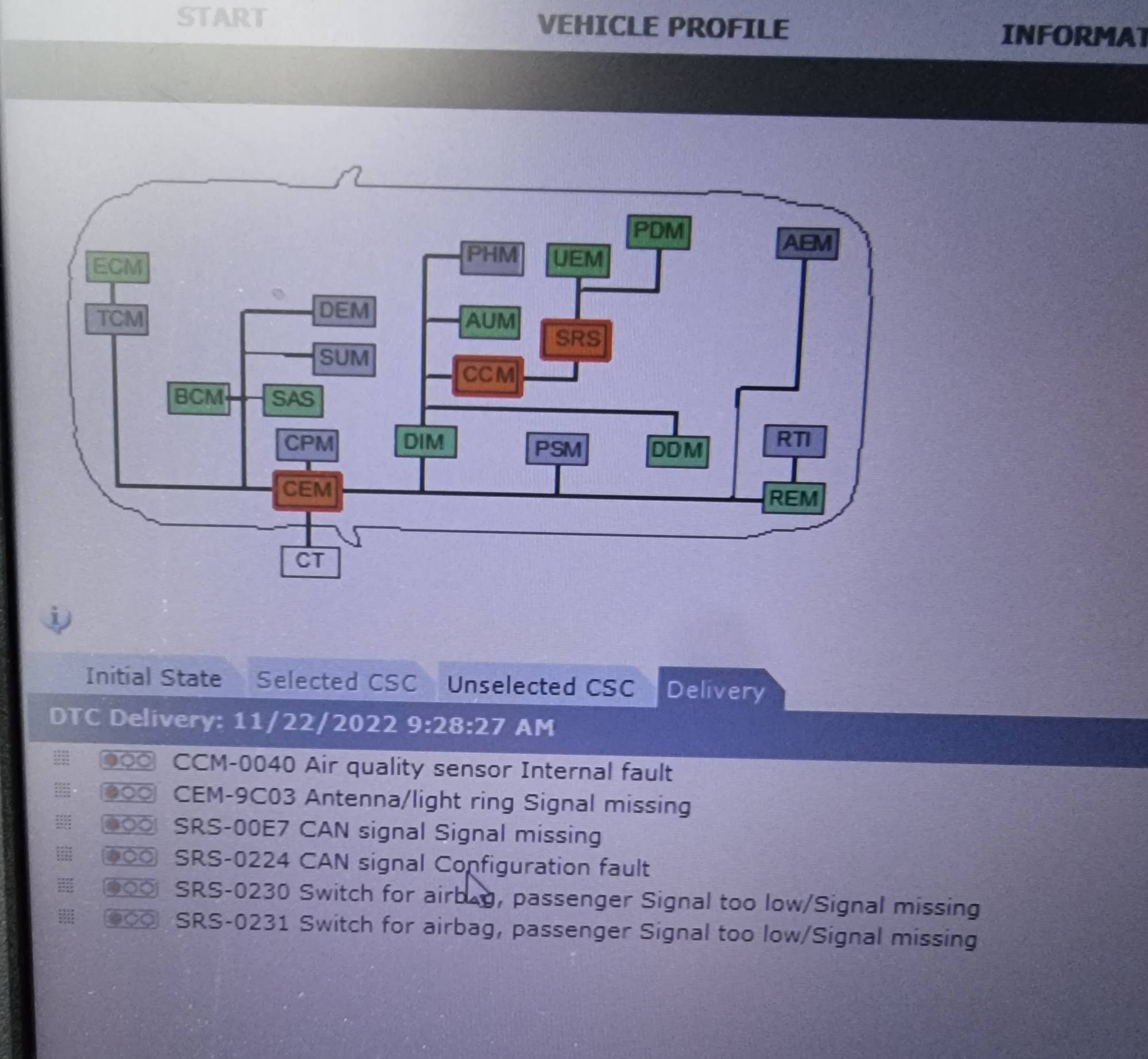

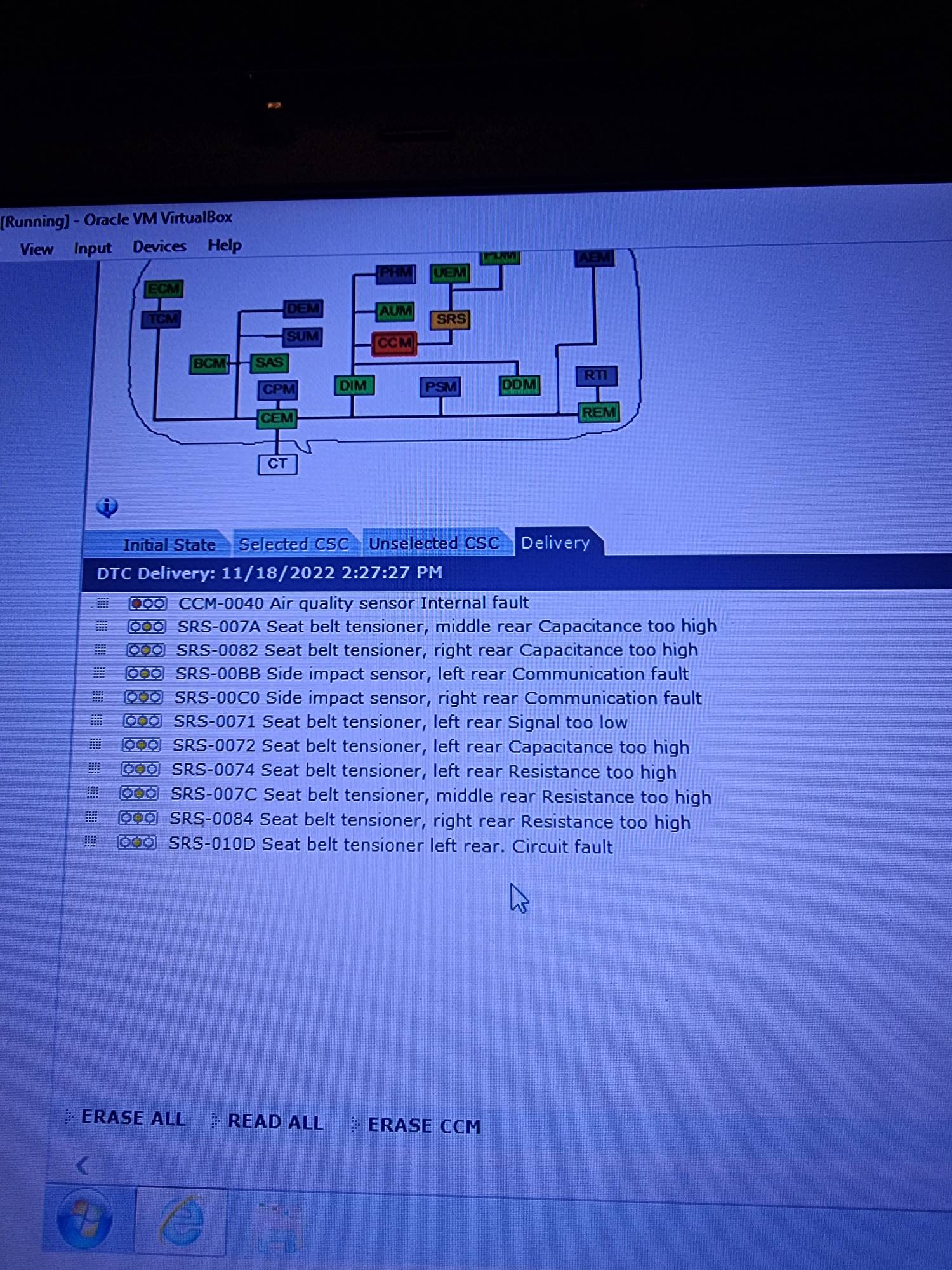

I have a problem with these fault codes. I tried to solve the problem by replacing the seats but fault codes are still present and cannot be cleared. I bought the car with an SRS error on the display, and I assume it has been in a crash. I doubt the SRS remembered the Crash code... Can I replace the SRS module with one from another car, same model/same year? Or maybe there is another solution?

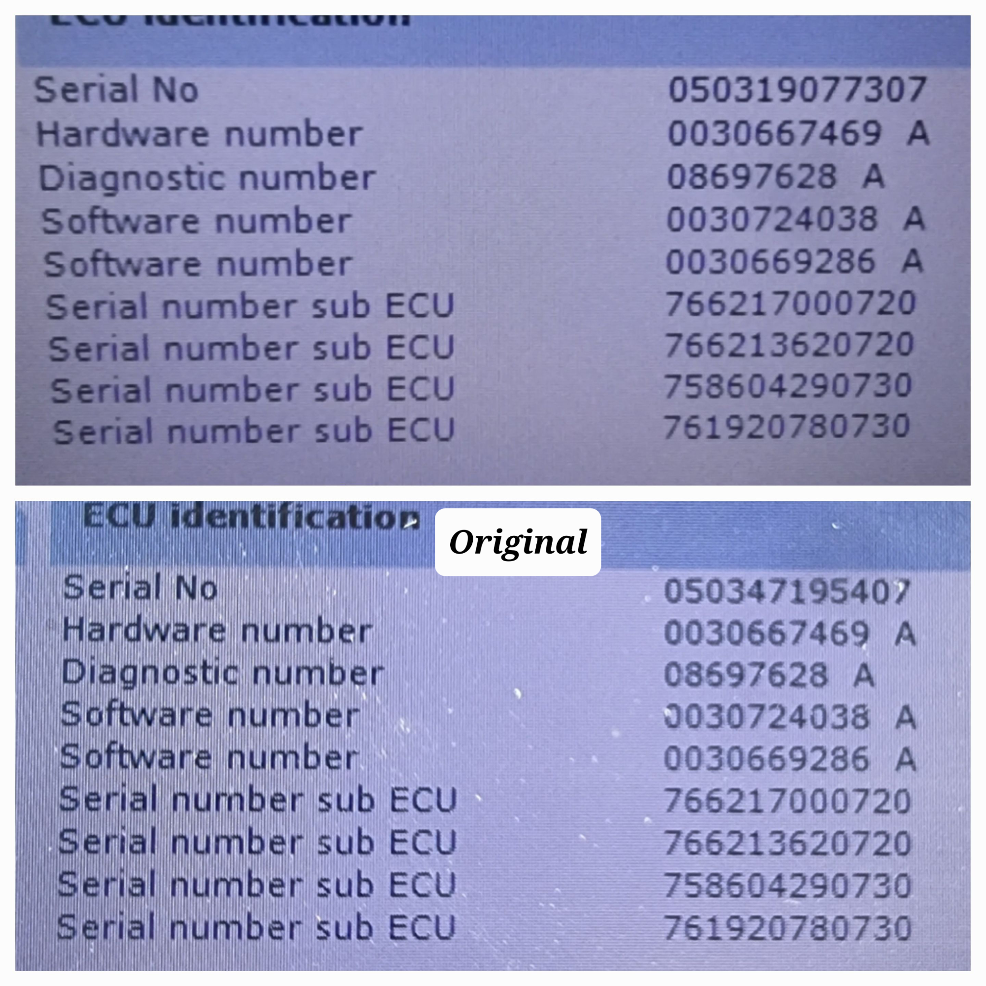

I tried another module, but again I get fault codes that cannot be erased even if all the numbers match.

After clearing the airbag crash data, errors still appear among them and some new ones. I don't know what could be the problem, and where to start with solving it.
