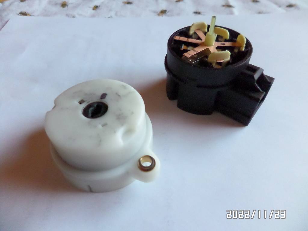

Turns out I have the later model switch p/n 8650054. My car was manf 02/99 so I was thinking that it was an earlier production model, but I forgot to figure in that '99 cars started to be made in later '98. The chassis number is 606621 and which is well after the cut over to the newer style. But still, thanks for all the links to the 9447804 switch. It was still worth while to read through them.
From what I've read in the forum, the newer style doesn't suffer as much from failure. There are about 135,000 mi on the car. Of course that doesn't mean the switch isn't an issue. I'll try going through the switch later to look for wear. I'd like to try to determine if something really is defective w/ the switch before spending about $80 on a new one. Guess I'm a cheap SOB. But I've got some Thanksgiving prep duties to attend to today first.

Concerning the ignition switch I pulled from the car (see pic in previoius post):
The switch appears to be in good mechanical shape. I did clean up the contacts a bit with fine emery paper. Not sure how to test the switch for electrical functioning. So I tested for continuity between the contacts inside the switch and each male connector terminal in the switch housing where the wiring harness plugs in. I found continutiy for all except the "S" terminal. I also tested for continuity between each of the male terminals. Again I found continuity between each terminal except for the "S" terminal where there was no continuity between the "S" terminal and any other terminal.
I don't know what should be expected with this test. Does the lack of continuity at the "S" terminal mean the switch is bad or is that the way it is supposed to work?

I never found or could see any obvious issue with my electrical portion of the switch when I had problems. One of the issues is you can't easily test it for internal wire failure as you can't see the contact wiring, and then if you look at the copper contact areas you can see wear marks in the copper. Not sure if those are enough to cause irregular or poor contacting. Also don't believe you will get instant failure. I would expect a random issue then permanent eventually.

You are correct about not being able to see the internal wiring, but I was thinking that the continuity testing I did would be indicative of something. I did burnish off the couple of wear marks that I could see.
