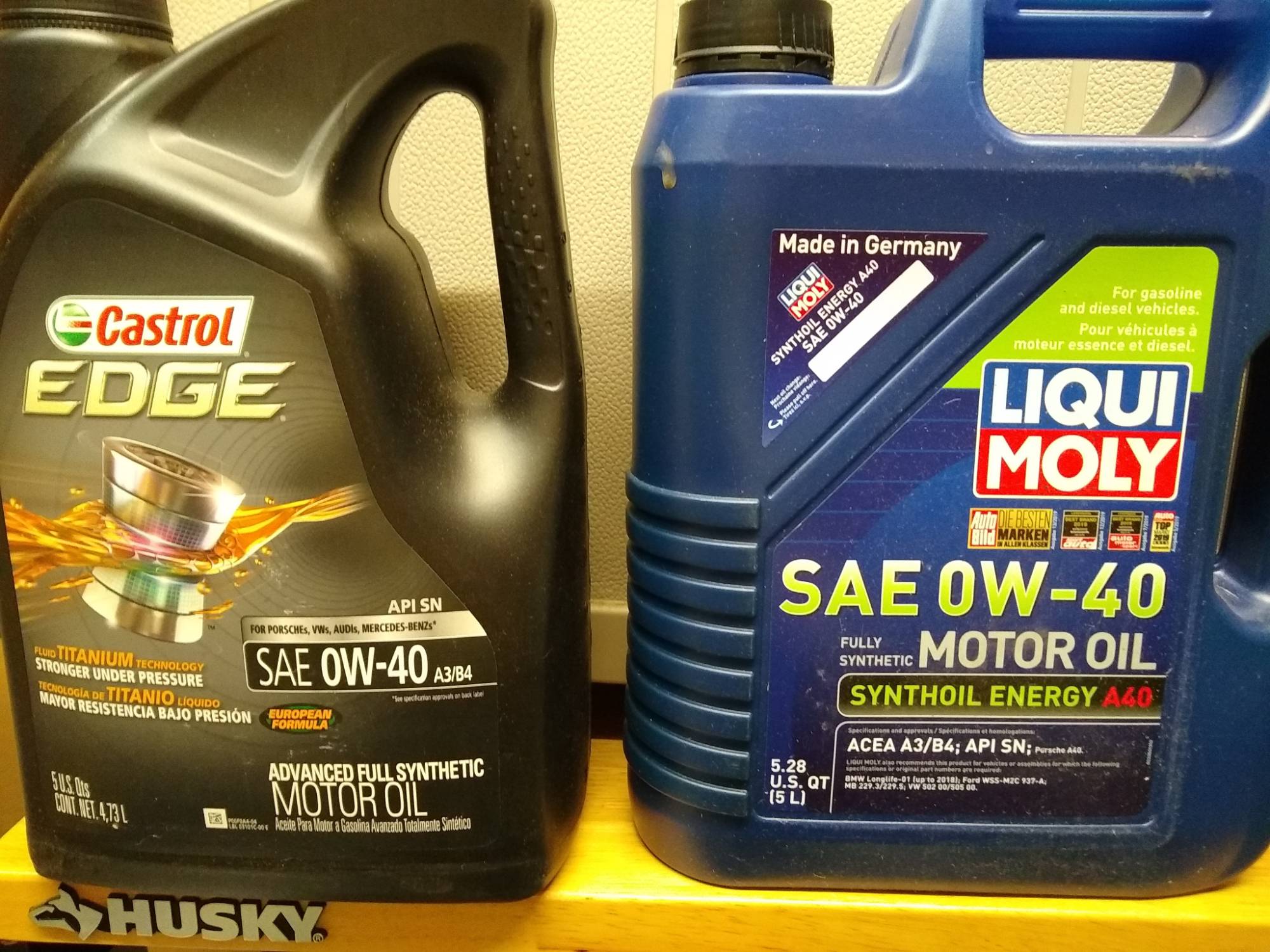

The T6 5W-40 is an excellent oil. Not sure if I posted these pictures but Rotella wasn't available for awhile so I stocked up when there was a sale and experimented with other oils. The gas rating went away but someone posted a response in BTOG from Rotella stating the formulation has not changed.
I believe they drop the gas rating to make way for the newish now Rotella Gas Truck motor oil in order to create a broader market and market share with the newest API ratings. Shell already knows there is huge following from bikers and gas engine owners who will continue to use it. With the Gas Truck they have new customers who otherwise wouldn't use a diesel oil in their vehicles. Didn't care for the Gas Truck oil after trying it but am back to using the T6 5W40 when the others run out.
Purchase a jug of the T6 already but didn't bring it to my folks when I changed the oil on the C30 Sunday. Went ahead and put Swepco and Liqui in combination for the oil change.
