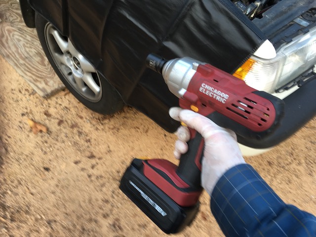

Getting ready for timing belt replacement, removing front right wheel to access the crank and tensioner.

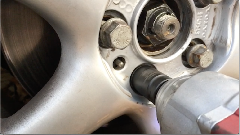

Tested out my old but trusty so far cheap impact wrench. Check out the slow motion video of this wrench busting that nut loose.
IMG_6967.mov
Slo Mo video of impact gun loosening Volvo 19mm wheel lug nut (had been torqued to 81 ft-lb / 110 Nm)

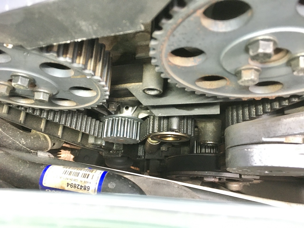

Water pump looks OK so far, with no weeping noted from the hole
I'm not planning to change this pump now... did replace it during the last timing belt change 7 years ago in 2015.
