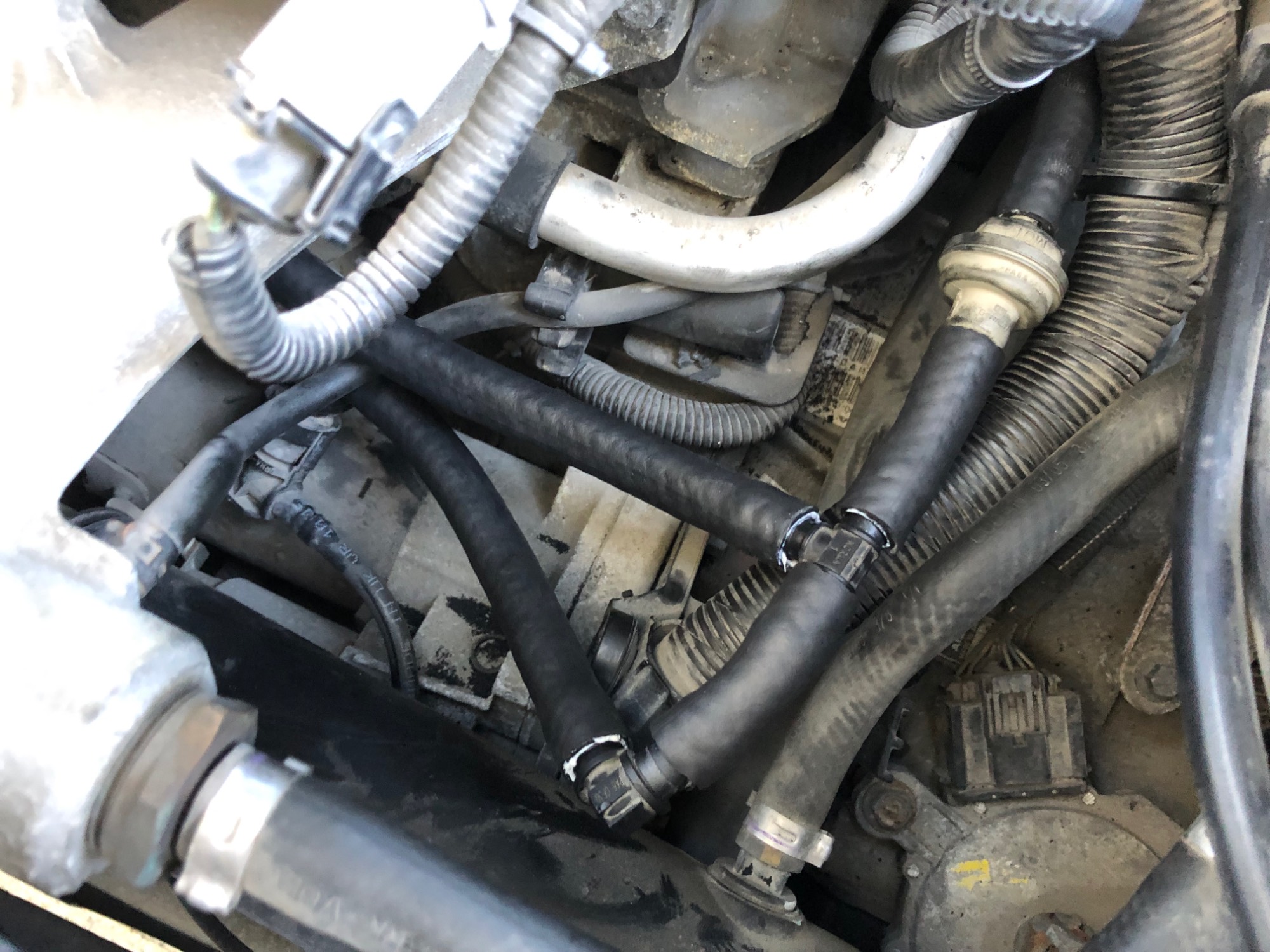

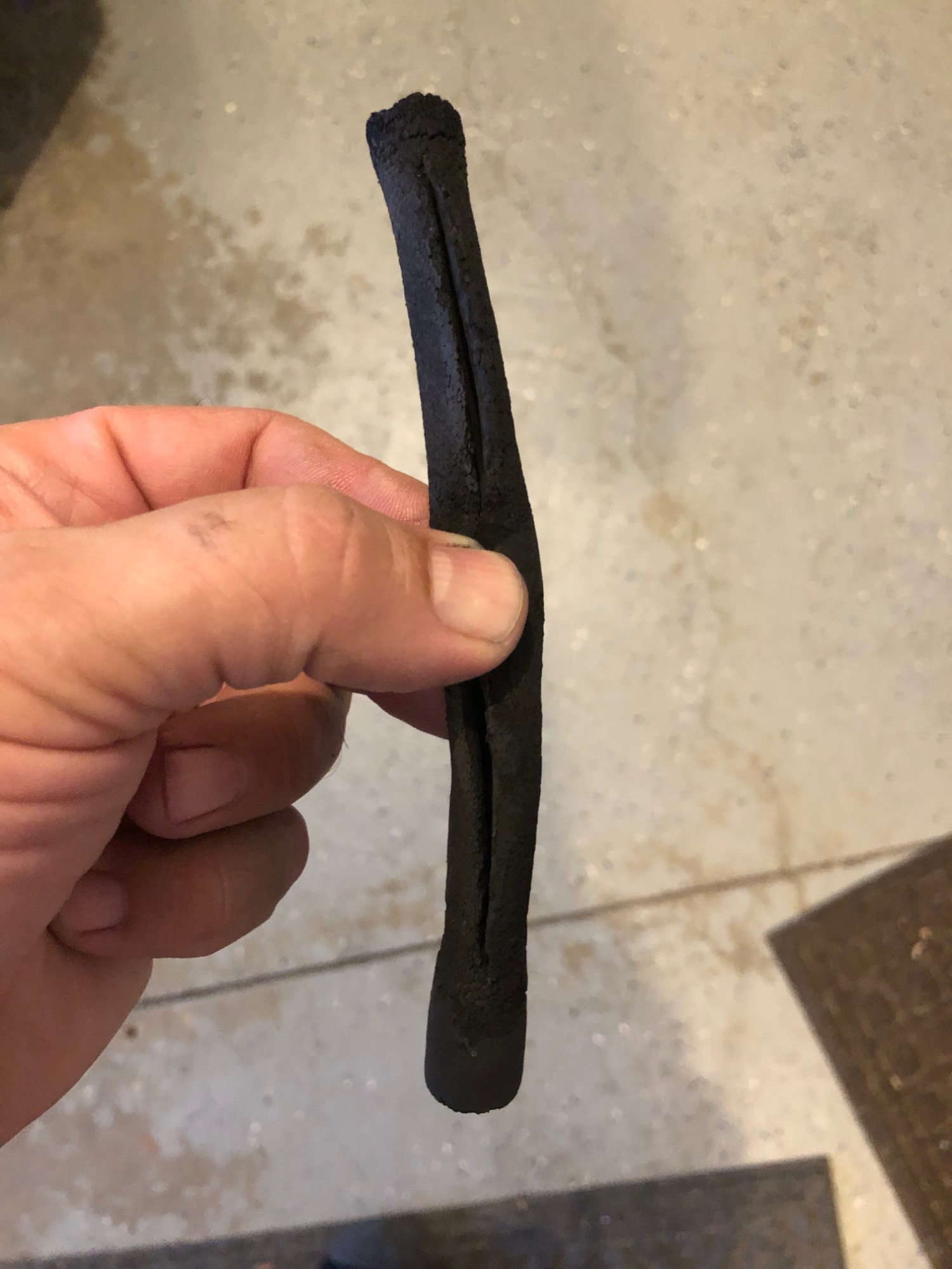

Another item to check is the EVAP hoses on the driver’s side under the intake. My kids XC90 EVAP codes persisted and so when I had access to it today I found one of the hoses split, got fuel line at local farm supply store and fitted all new.DarthPepperoni wrote: 16 Jun 2024, 11:12 2010 Volvo xc90 3.2 fwd:
