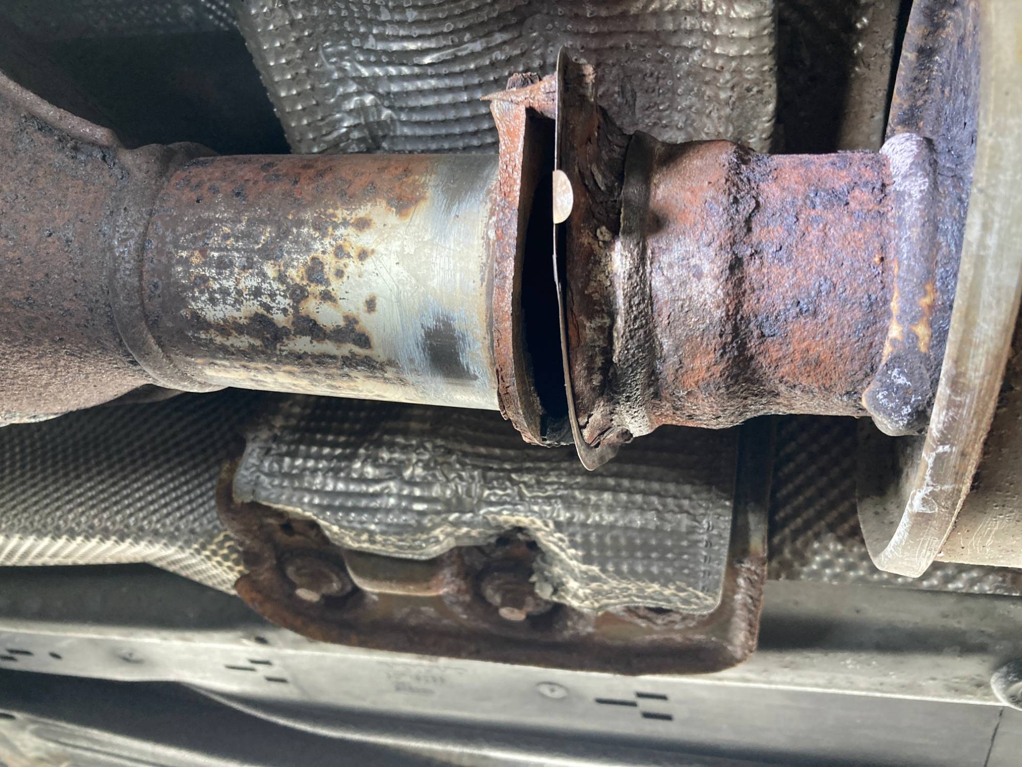

Ugh! I just went through this a couple days ago with my XC70. My cat to resonator flange just let loose. I considered a split flange clamp on both sides of the old flange as the bolt holes were shot. In the end due to cold weather locally and frustration I brought it to the local exhaust fix-it place and they did just what you are considering, cut the flange away and welded in a short piece of pipe. They did state that the split flange route is sometimes problematic due to gaskets not sealing well.
Enclosed a pic of the before ( no after pic sorry). BTW anyone know if I'm missing an exhaust hanger here....looks like there should be one but I only have a couple empty bolt holes!

.Skymongrel wrote: 30 Dec 2022, 16:06 Ugh! I just went through this a couple days ago with my XC70. My cat to resonator flange just let loose. I considered a split flange clamp on both sides of the old flange as the bolt holes were shot. In the end due to cold weather locally and frustration I brought it to the local exhaust fix-it place and they did just what you are considering, cut the flange away and welded in a short piece of pipe. They did state that the split flange route is sometimes problematic due to gaskets not sealing well.
