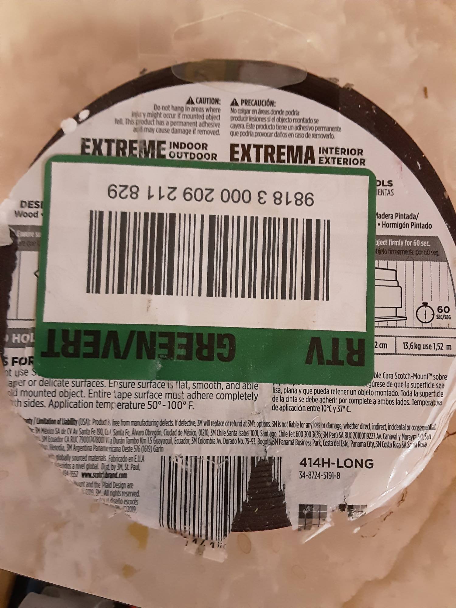

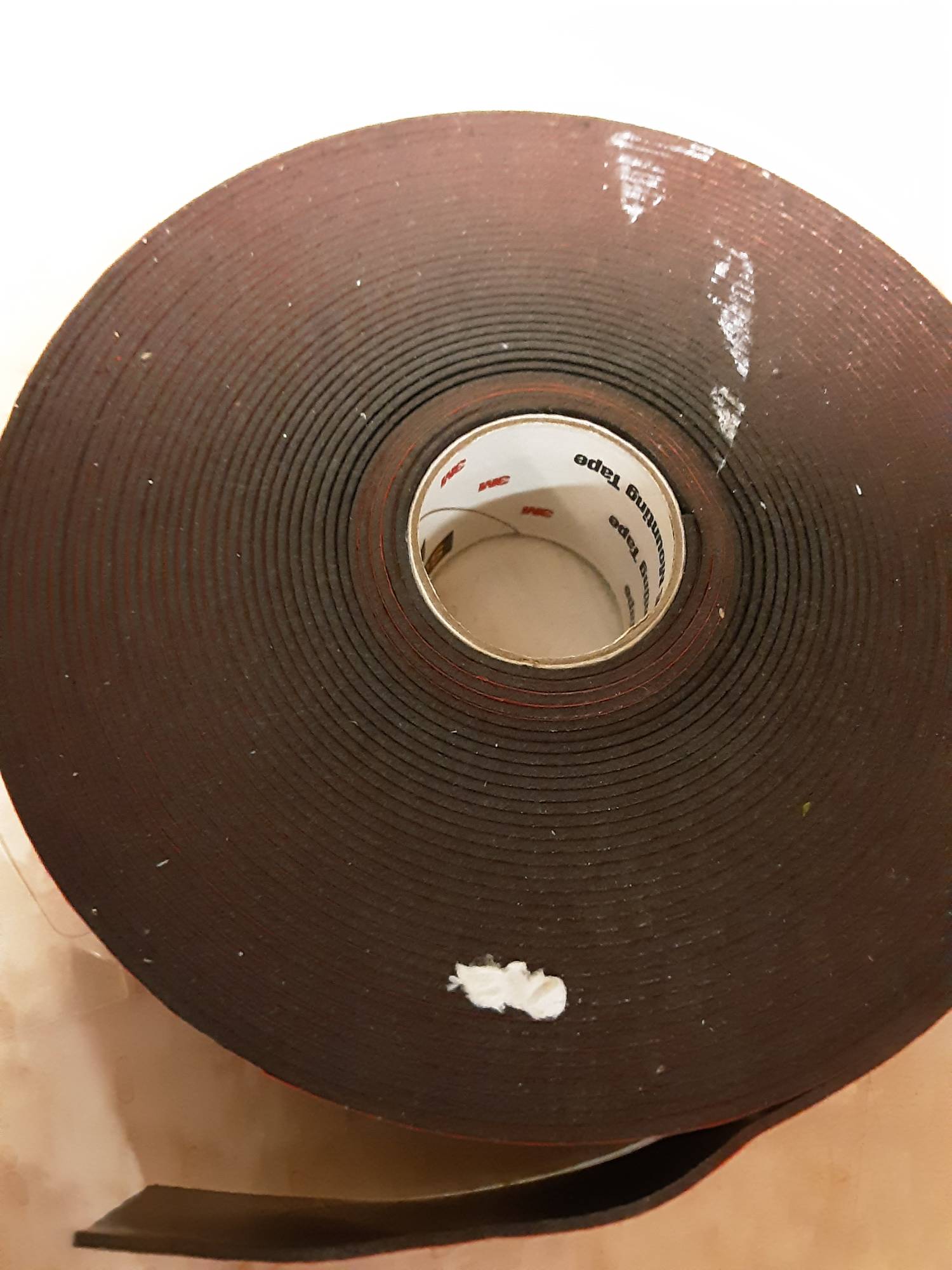

Use the 3M emblem tape. My S80 has weatherstripping between the hood and bumper. I brought a new rubber weatherstripping from Volvo to find it used the 3M emblem tape from Volvo. I'll bet it's the same for the tailgate weatherstripping. I bought a big roll to attach the mirror glass back to the rubber backing on the passenger side mirror for my 1991 740. Thus far it has stayed in place. June
