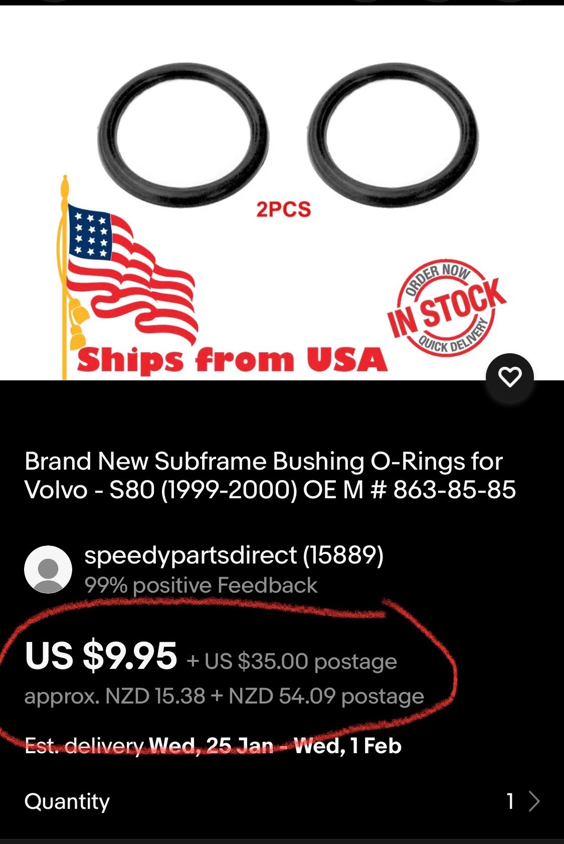

FCP and IPD are where I’m looking -including freight $60 USDollars is $100 New Zealand dollars- dealer wants nearly $150 nzd. I’m sure I can locate them locally for a fraction of that. No site seems to list the size details

Post by MoVolvos »
Stu70 wrote: 18 Jan 2023, 23:51 FCP and IPD are where I’m looking -including freight $60 USDollars is $100 New Zealand dollars- dealer wants nearly $150 nzd. I’m sure I can locate them locally for a fraction of that. No site seems to list the size details
Purchased from IPD and installed on our 03 S70 T6 a couple years back. They weren't very large. Perhaps these people can ship it to you cheaply. Just a bubble envelope would do.
https://www.ebay.com/itm/284646729982?e ... R-zB5465YQ

Post by Stu70 »
The joys of being in a land far far away…

Post by MoVolvos »
Stu70 wrote: 19 Jan 2023, 00:27 The joys of being in a land far far away…
I was just about to post the same thing. If your are not in a hurry I will buy that now and have it shipped to me. I'll see if it can fit in a larger letter envelope and check what the post office will charge. If it's too much I'll keep it for my 07 S60 2.5T and install it along with the blue inserts. PM me your address as it would appear on an envelope. I'll keep you posted :lol: of the progress.
