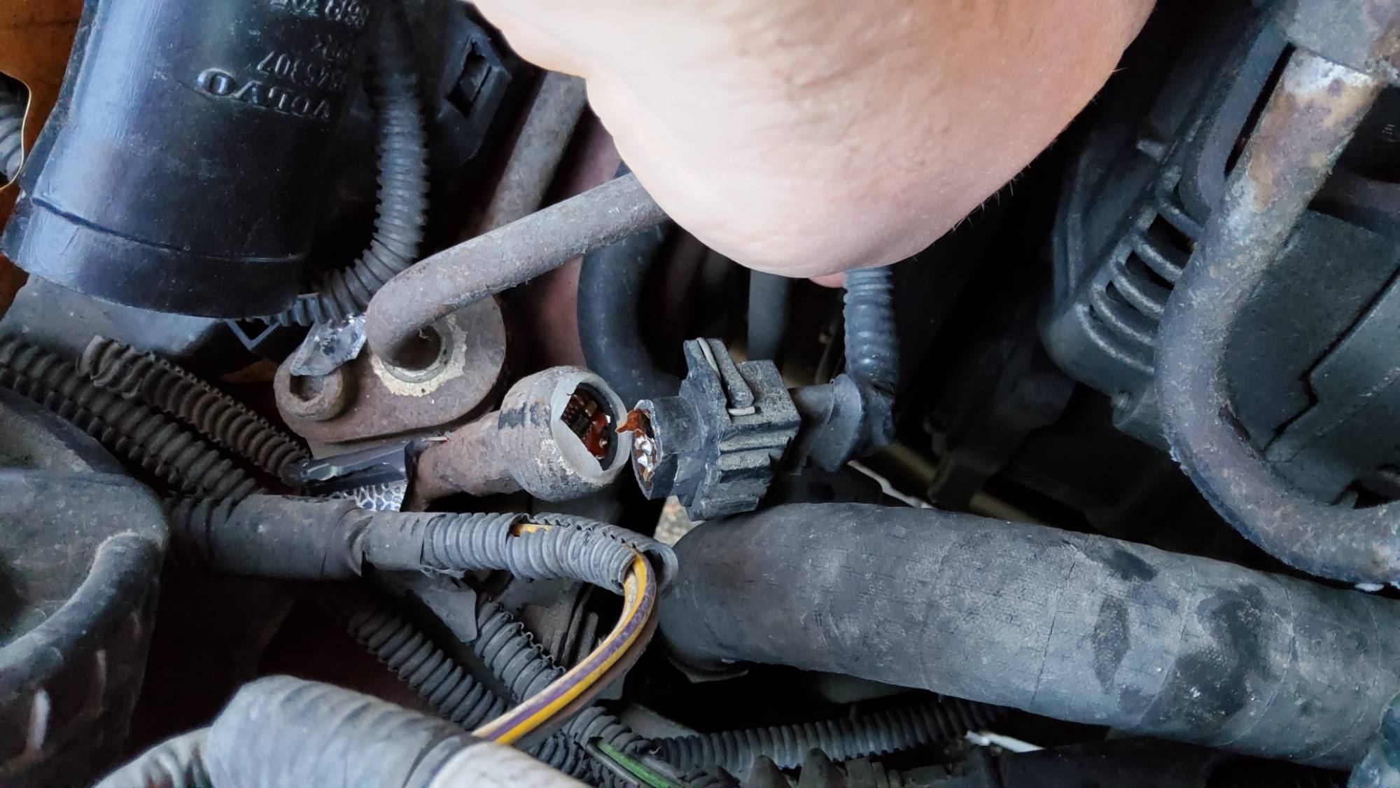

98 v70: what sensor is this? Unable to identify or find on ipd. Topic is solved

Picture attached of sensor I want to identify. Broken during the crash. Zoom in and you can see the black computer chip.

CIK7 wrote: 11 Jan 2023, 17:59 Picture attached of sensor I want to identify. Broken during the crash. Zoom in and you can see the black computer chip.
Could probably see it better or get a better picture of location in the engine bay if you zoom out. It looks like the pressure cut off switch for the AC system however?

What was throwing me for it's location is the filler tube for the windshield washer bottle looks like it is lying on it's side. The alternator is there and to the lower left the rear of the headlights. I defer to MoVolvos on this one but it is in the area of the low pressure fill for the A/C.

https://www.fcpeuro.com/Volvo-parts/V70 ... &d=55&v=91
Probably 30767231
You can also probably find one in the JY. Easy to swap out.
Probably 30767231

Itโs the high pressure AC sensor , and itโs mega expensive. Iโve got spares if you need one for free
