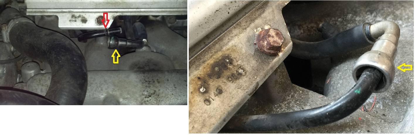

I'm still not sure what a fuel pipe is.. fuel line from the pump to injectors? .. fill tube to the tank? .. fuel rail?..send pictures of what you're looking at.. I build Volvo's with junkyard parts.. but not always.. somethings you have to buy new MDK

MDK wrote: 14 Jan 2023, 10:44 I'm still not sure what a fuel pipe is.. fuel line from the pump to injectors? .. fill tube to the tank? .. fuel rail?..send pictures of what you're looking at.. I build Volvo's with junkyard parts.. but not always.. somethings you have to buy new MDK
picture link.
https://usparts.volvocars.com/p/Volvo_2 ... 27953.html

- The "Fuel Pipe" is in the photo below (Yellow arrow).
- It has claws that lock into the male side (Red arrow).
- Inside the "Fuel Pipe" is an O-ring. If this O-ring is damaged, then you will have fuel leak.
Damage happens during re-installation. This is why I always use engine oil (not fuel) during
re-installation for most engine parts. It allows re-installation without marring the O-ring.
Just add on drop of engine oil on the male side during re-installation.
- Solution: find appropriate O-ring rated for fuel at local hardware store or get a junk yard
park and swap the O-ring over...
