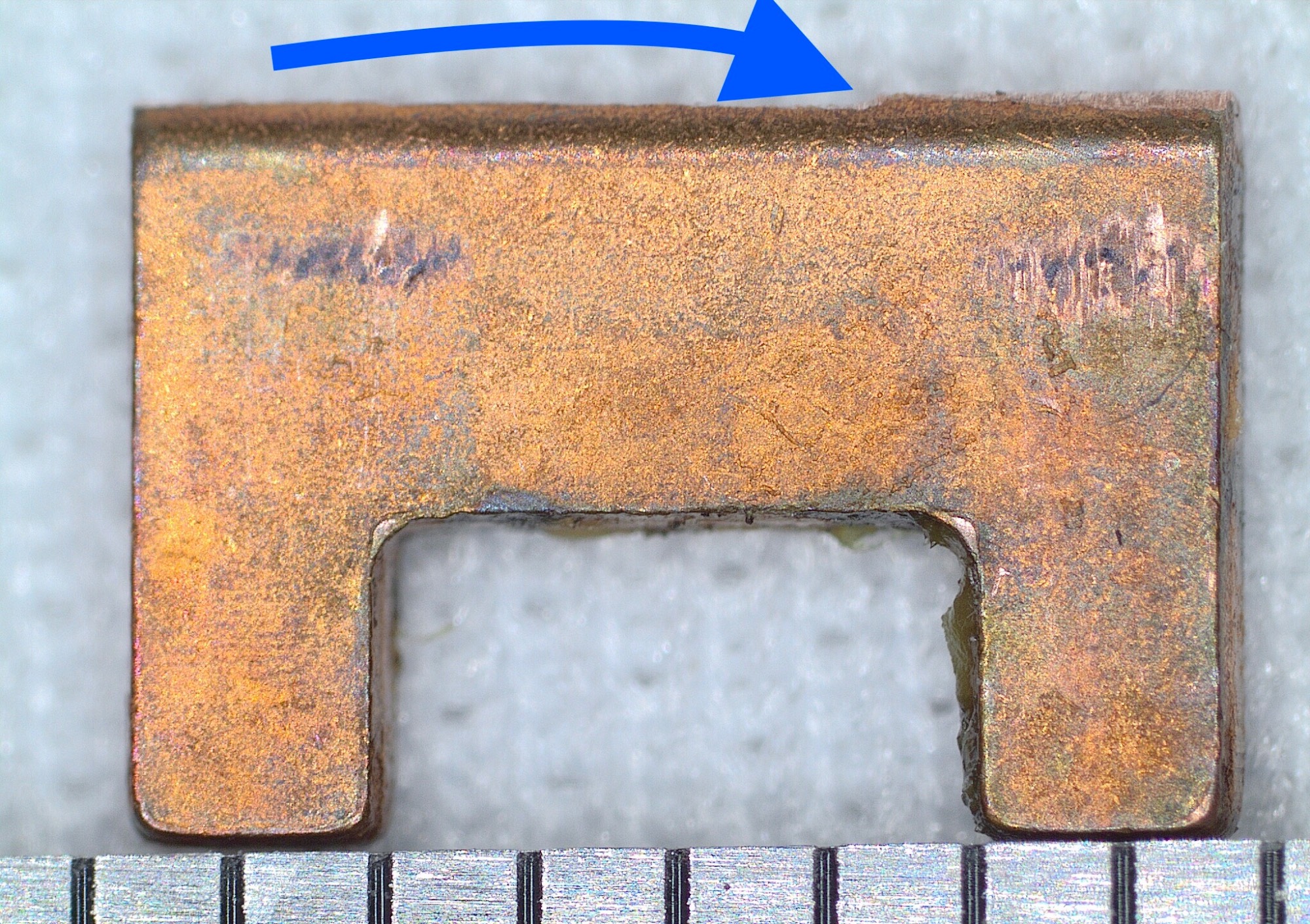

I took some higher magnification photographs of the copper contactors.
They have some black tarnish and some wear. The first photograph is the contactor seen from the side. The contact surface is at the top.
The second photograph shows all three contactors side-by-side looking down at the contact surfaces
The blue arrow in the image below is pointing to the largest amount of wear I could see. There is some black tarnish on the contact surface of the middle and bottom contactors. For scale, the bars on the steel ruler at the bottom of the photographs are 1 mm apart.

Great photos and thanks for those. It looks like that the repair kit just replaces those worn contacts. If that is all that wears on these, then the repair kit seems like a good way to fix these worn units with no new PnP's being available.

Those contacts don't look bad at all, seem pretty even though I don't see them all in profile at the same time.
Years ago i opened one up, filed all three contacts flat and to same size, then put it back together. They were very different in size when I got to them. The PNP had been acting up, that fixed it.
