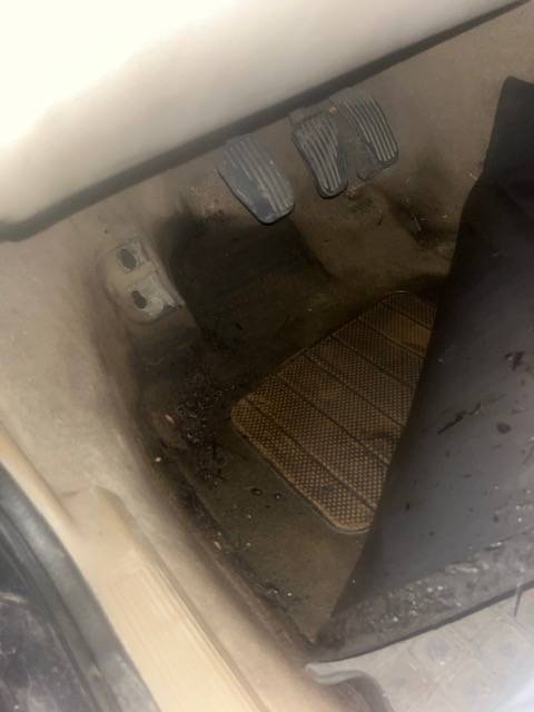

Checked all oils and stuff, and burped the hose until is wouldn't drop. Then I lifted the carpet... holy moly it's damp... borderline wet... just lifting the carpet revealed a puddle that stretched almost all the way to the seat, and I don't know how recent it is... Would running out of coolant when my coolant light came on have caused this?volvolugnut wrote: 02 Feb 2023, 19:38 What Am I Doing is right about burping the hose. Do this with the cap off and keep doing it until the level stops dropping in the overflow tank.
Either way, there's my leak... and I'm gonna guess that isn't a quick job to do... and is enough to prevent this car from making the trip...

Alright, after some digging and talking to my co-pilot for the trip, it seems like the trip is still doable, just won't have heat... Going to test this theory by not using any heat tomorrow to ensure that reservoir stays at the max line like I know it should. Once that's proven to be right, we may either go on our journey, or we may try and fix the heater core right then and there. Not exactly a tough job, but a job nonetheless.
Here's the damage:
Yeah, a new carpet would be needed. Judging by how dirty it is, I'd bet this has been an issue for *way* longer than I've owned this car.
Oh, and in case I haven't said it, ***thank you*** for helping me find this mystery leak.
