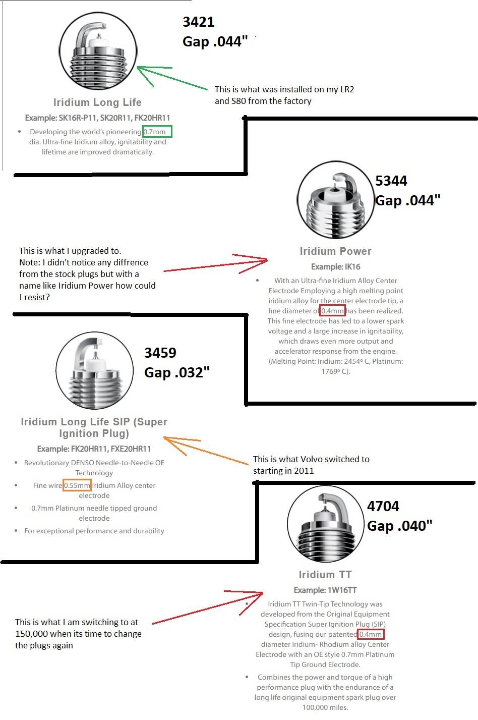

Yes you can use those
FK20HQR10 is a Twin Tip Denso Iridium Plug
It is very similar to the 4704 IKH20TT
The difference is that the VOLVO Plug is a Super Ignition Plug and it has a slightly larger diameter for the Iridium Tip 0.55 mm vs 0.40 mm
I would happily use these in my 3.2
Here is a JPEG that I created for myself to understand the differences
3421 is what came stock in my LR2 (IRIDIUM LONG LIFE Single tip 0.7 mm)
5344 this is what I upgraded to and used for the last 50,000 miles (IRIDIUM POWER Single Tip 0.4mm)
3459 This is the Super Ignition (Volvo Switched to this) This is a Twin Tip Iridium Plug [Twin Tip 0.55mm]
4704 This is the Iridium Twin Tip from Denso [Twin Tip 0.4mm]
I would use any of these and since you have 3459 x 5 I would just buy one more 3459 or get one 4704 and put them in
Good luck
